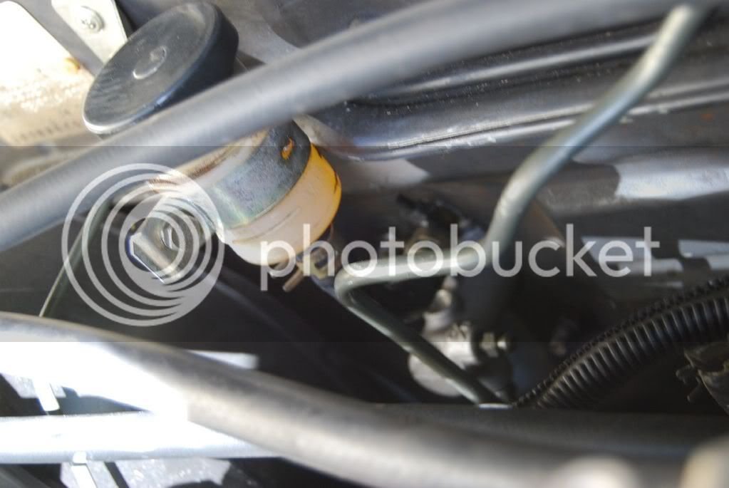

Car is almost complete. Just gotta sort out an adapter for the Clutch Master so we can attach a bottle to it. Then fit the A31 cefiro Swaybar, fix up the stock exhaust manifold to make room for the steering column... then Add the extras, brakes, suspension and complete :D

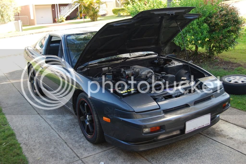

Piccie time

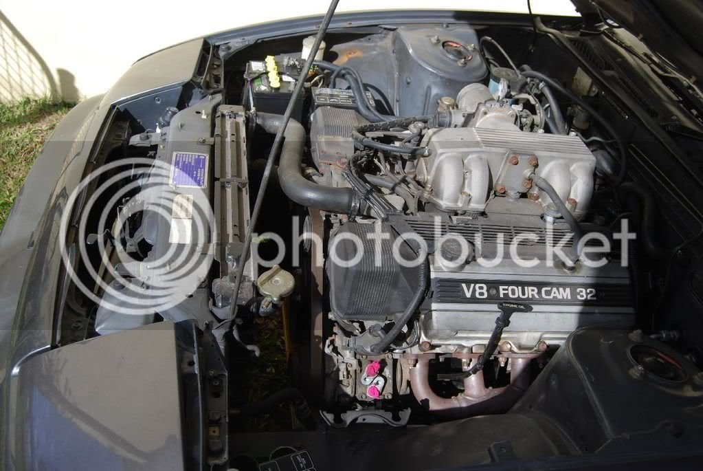

Engine Bay:

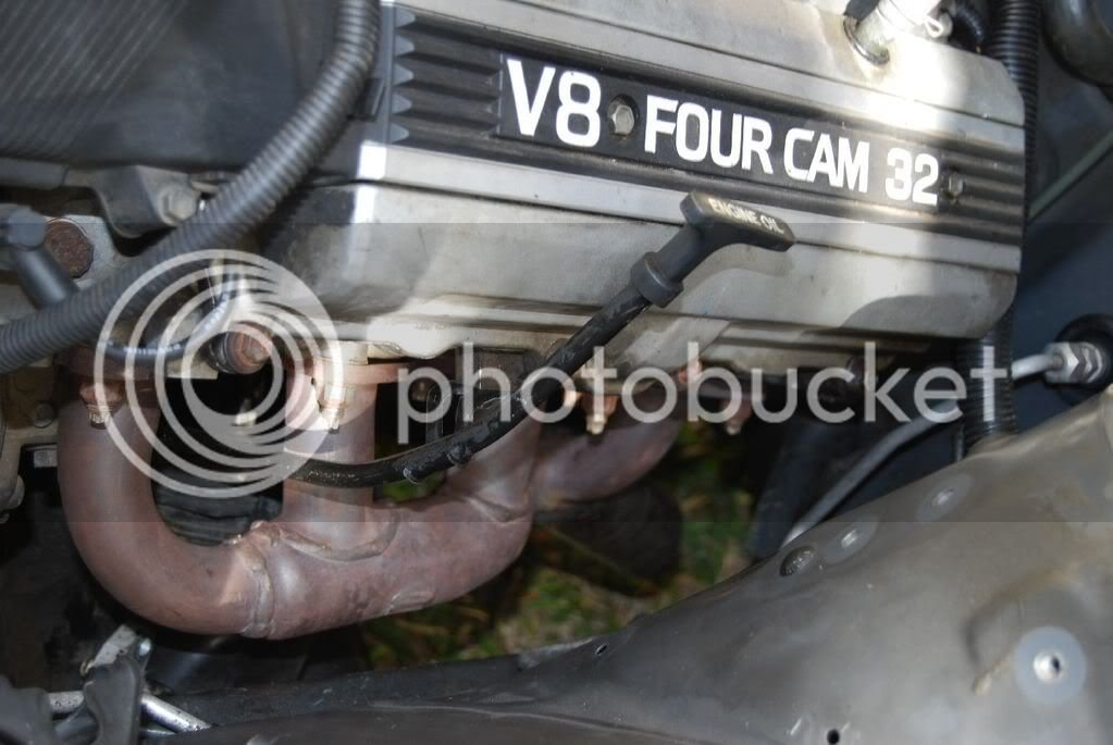

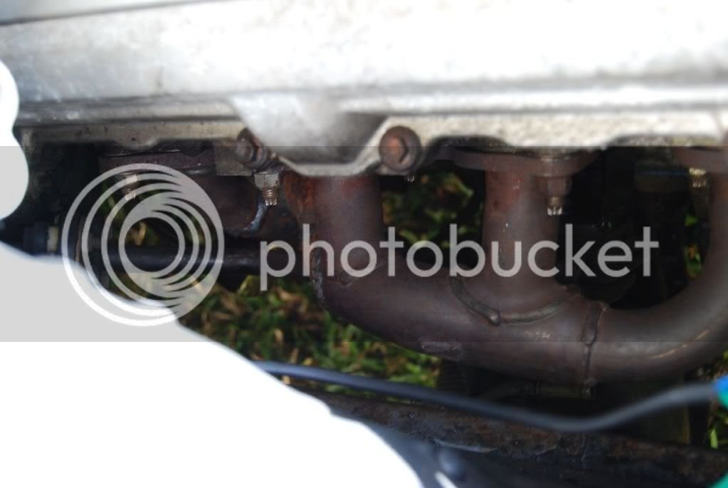

Factory Exhaust Manifold:

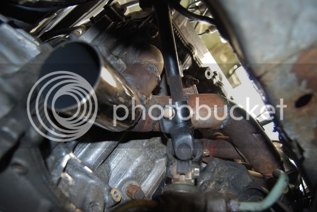

Customised Manifold to get around the steering column:

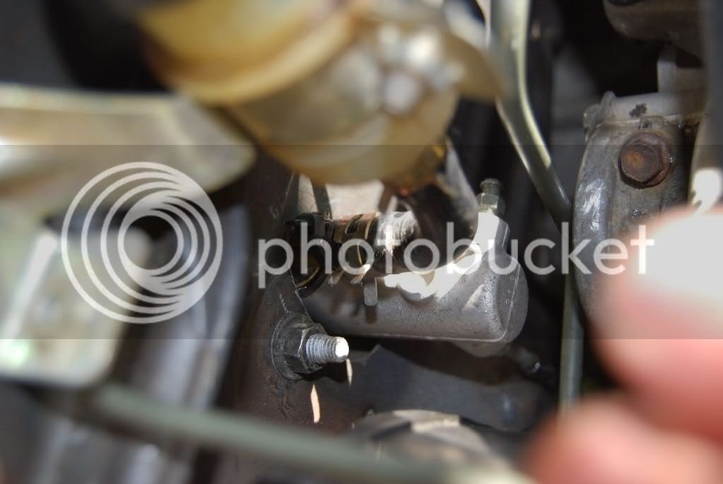

Cluth Master

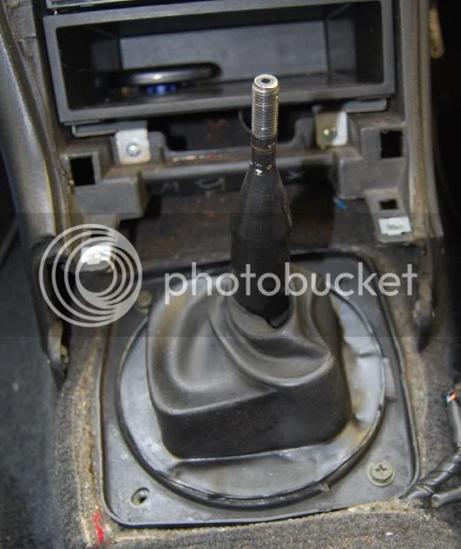

I had to make a cover to go over the hole in the gearbox tunnel, so i hacked this plate off the auto shifter, and used the rubber boot to fix the hole :P

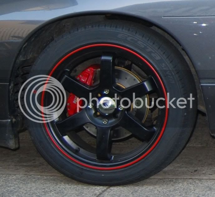

Ive also put the rotors (cross-drlled and slotted DBA Golds) and brakes on (Z32 4 piston)... they are still very spongy, i have bled botyh sides twice, but i might try it from the master and do the calipers again if its still spongy...

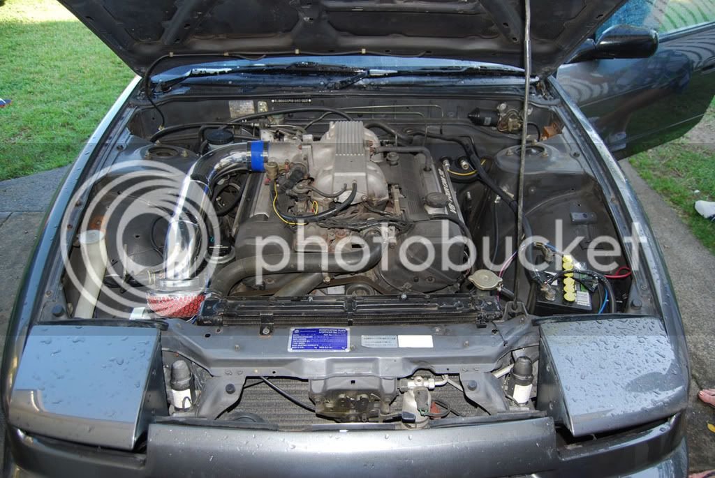

Most up to date pic of under the bonnet... Relocated Battery, Installed air filter/piping and turned the thermo fan blades around the right way :P
