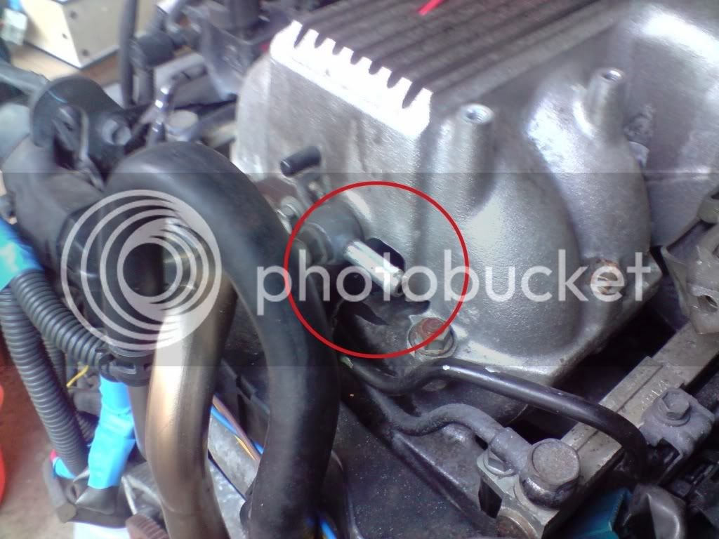

Thanks guys for all your help, got the engine running eventually, however I was wondering what the breather in the picture below is for, its into the inlet manifold just above the flywheel? When it is open to the air the engine doesn't idle very well, however when it is blocked off the engine seems to idle just fine. Just wondering if i can blocked it off or will this do damage or cause other problems.
Thanks
Raymond
That's the vacuum feed for your brakes.
If you don't have power assisted brakes just block it off.
yeah whack a bolt in there or hook it up to your brakes, but if its a ski boat... im guessing not required.. (Definitely the brakes) You can also get a electric brake booster from the later soarers, and this fitting is blanked off from factory, so definitely not important.
