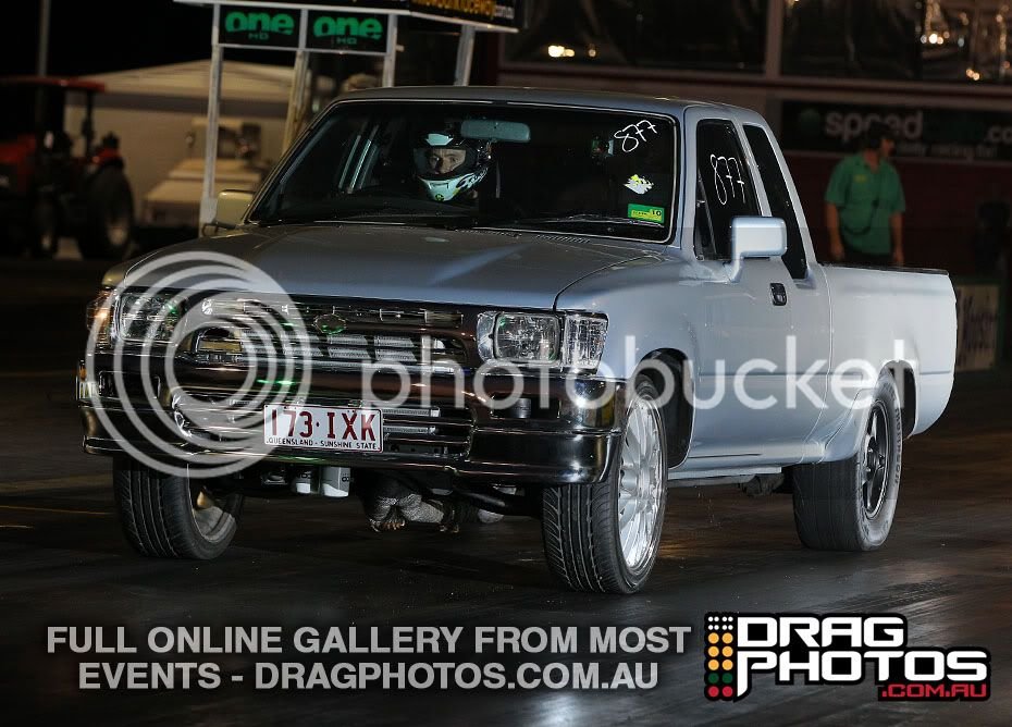

New intake good for an extra 50rwhp.
Yeah, once the intake is sorted bigger cams will actually work and the combined gains should be substantial...the stock cams are weanie
what ecu are you running now days millsi?
can't setup some ignition retard off say brake light input and TPS >50% to get you on boost sooner?
shows anti-lag and 2-step on the website, getting that working should make it a bit quicker out of the hole for little cost/effort if traction is not yet an issue!
