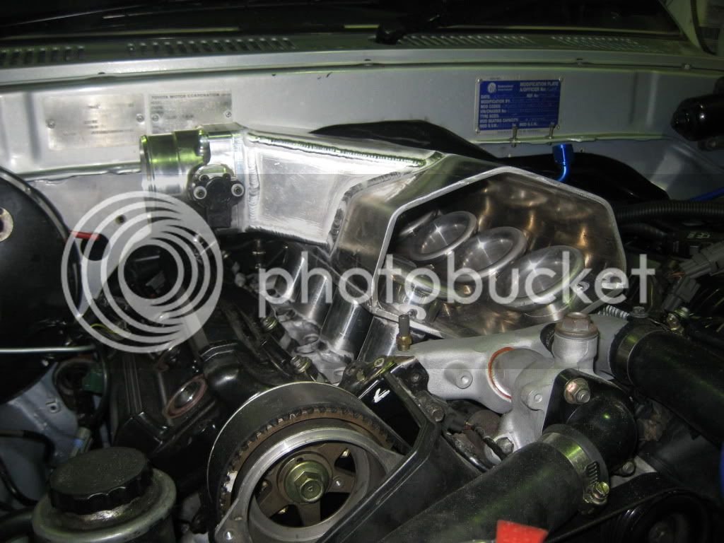

Thanks for clearing that up Justen... I understood what he meant about the vertical flow IC vs the horizontal flow IC. In fact, long ago, in a galaxy far, far away...I had an earlier version of a turbo set up that had a Bell designed and built IC that was vertical flow, for the very reason being discussed here. Here is a pic:
