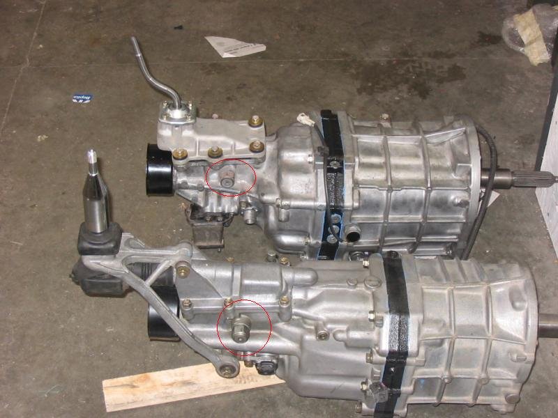

I was researching back then before my conversion on my LS400 and I sworn the R154 trans can come real close to fitting with no much modifications needed if you can find the transmission with the tripod shift linkage. My LS400 currently is converted from automatic to a 6spd. The transmission I chose was the 350z transmission (CD009).
sorry for a double post but here's a pic of the r154 transmission with the tripod shifter (bottom) and a w58 transmission (top).
Yes your talking about the JZA80 shifter. It hangs off the back of the transmission. If you find one let me know. It seems that they are super rare to find for sale and when you do find them people are asking stupid money for them. How do you like the 350Z 6speed tranny?
Also, how did you handle installig a clutch pedal?
I used an sc300 clutch pedal with the clutch master cylinder. The problem is not getting the pedal in there but moving stuff that is in the way like the fuse box, power steering module, and some misc things. I have four pedals down there lol.
