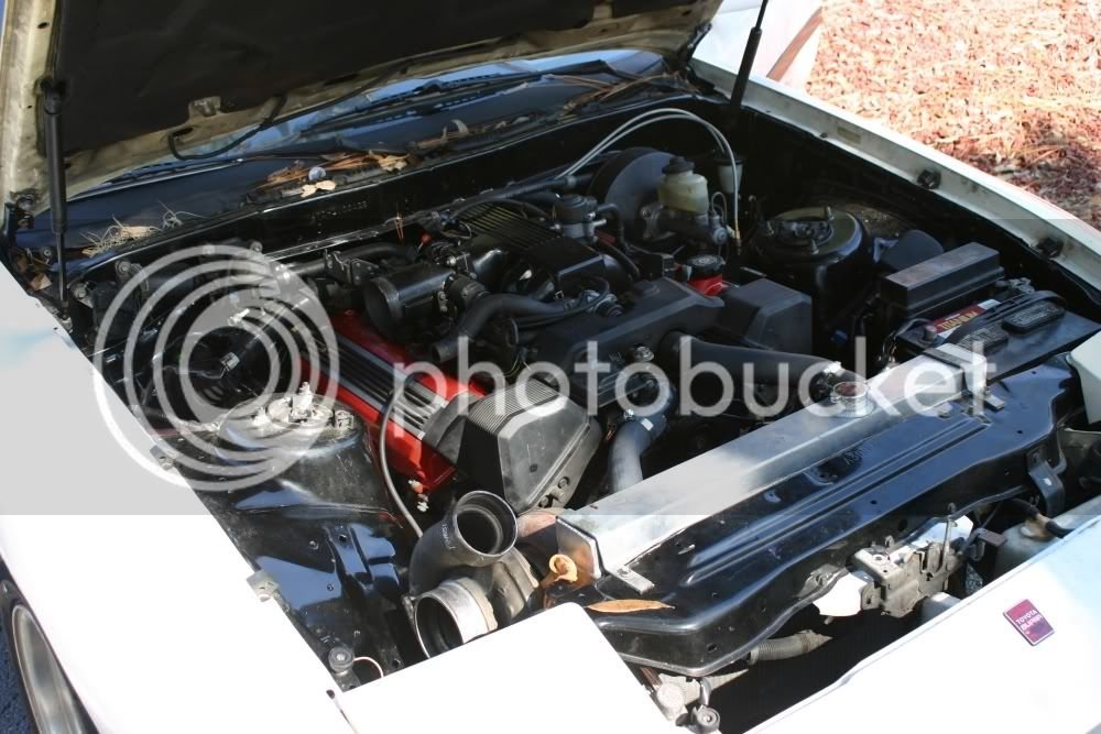

As the car currently sits, before I tear it apart again:
1uzfe w/ stock ecu
W58
Quantum-Auto manual swap kit
Crown Vic (BBS) Wheels
Tokico Illumina front/blown stock rears - this is how I picked it up as
H&R springs
ABS Delete
JVTR 3 row radiator
unfinished dart-izumi exhaust

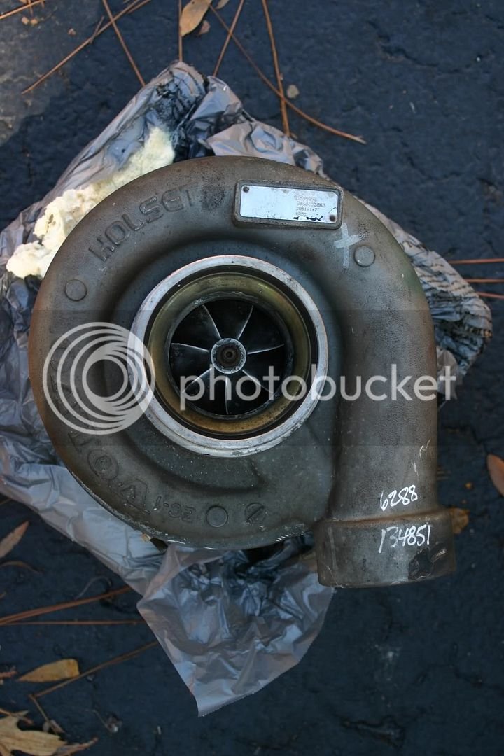

Holset HX52 *Billet Compressor Wheel* (single turbo)

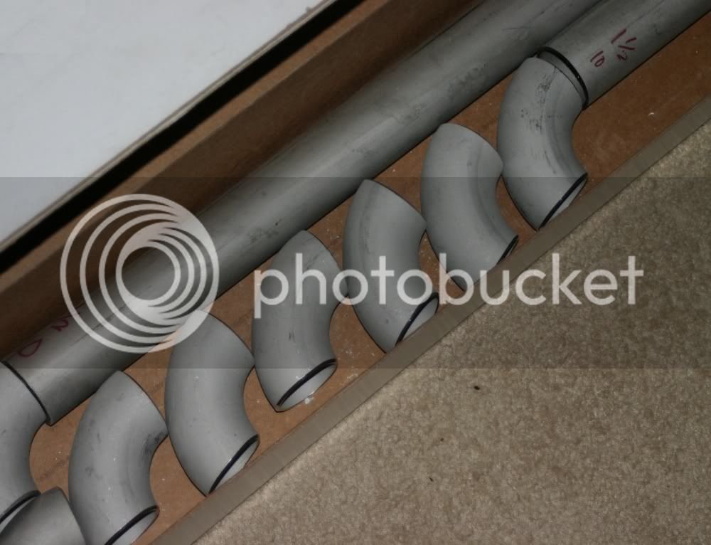

Custom SCH10 SS304 Manifolds

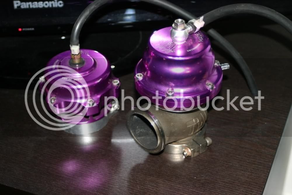

Tial 44mm Wastegate
Tial 50mm BOV

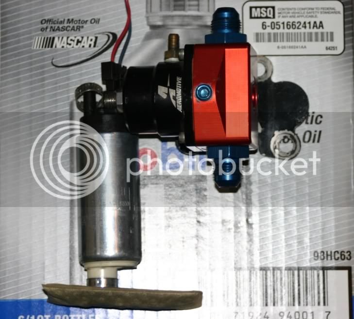

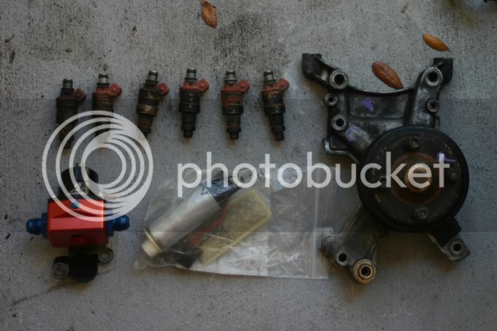

Aeromotive FPR
Walbro 255lph pump
Custom -8AN fuel rails
RX7 460cc injectors

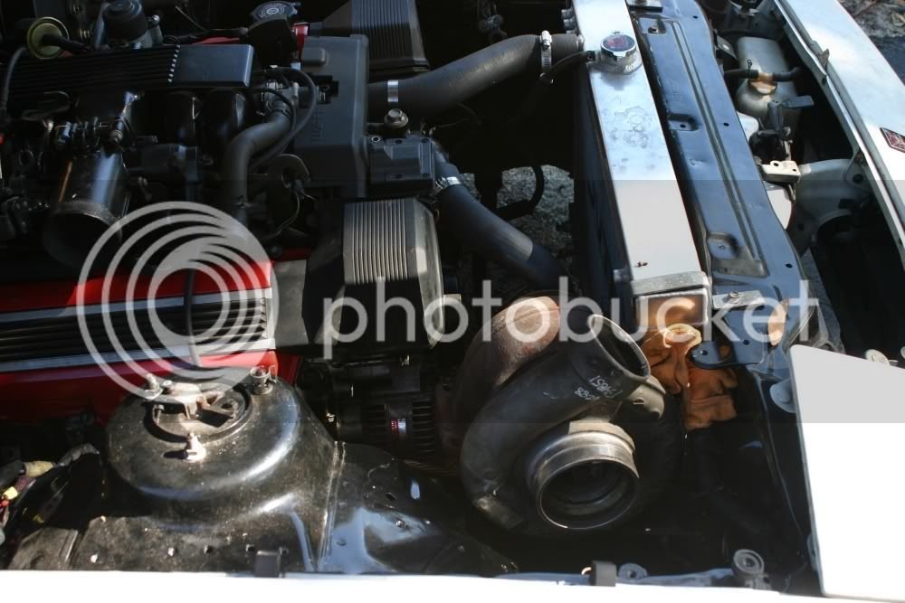

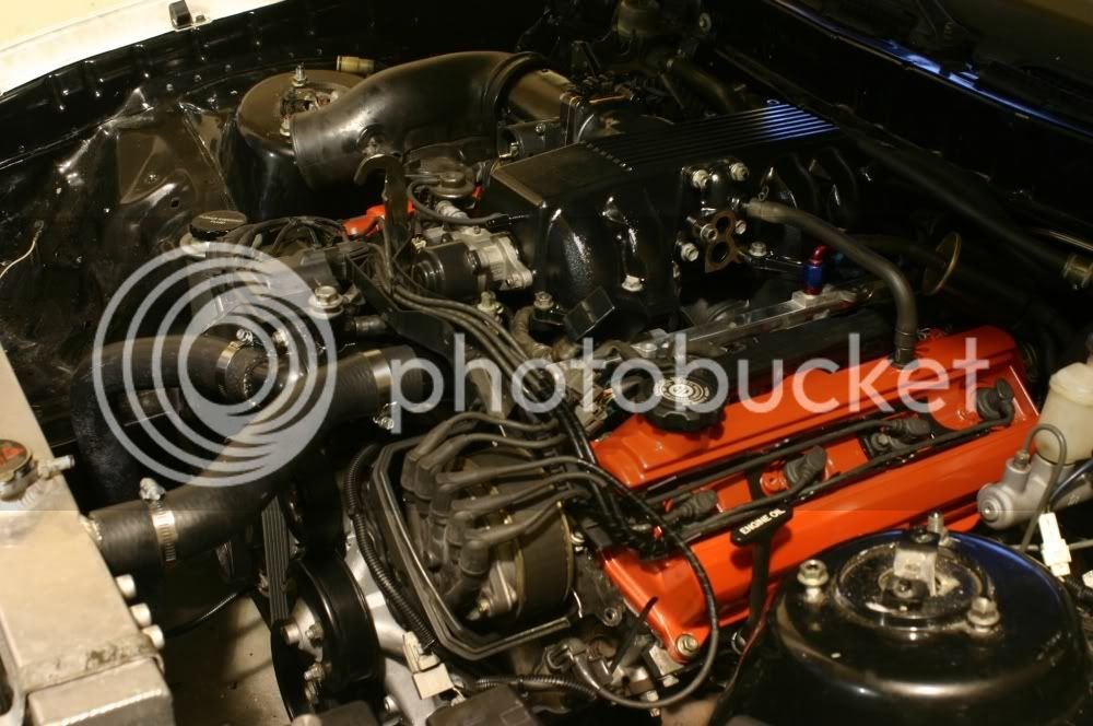

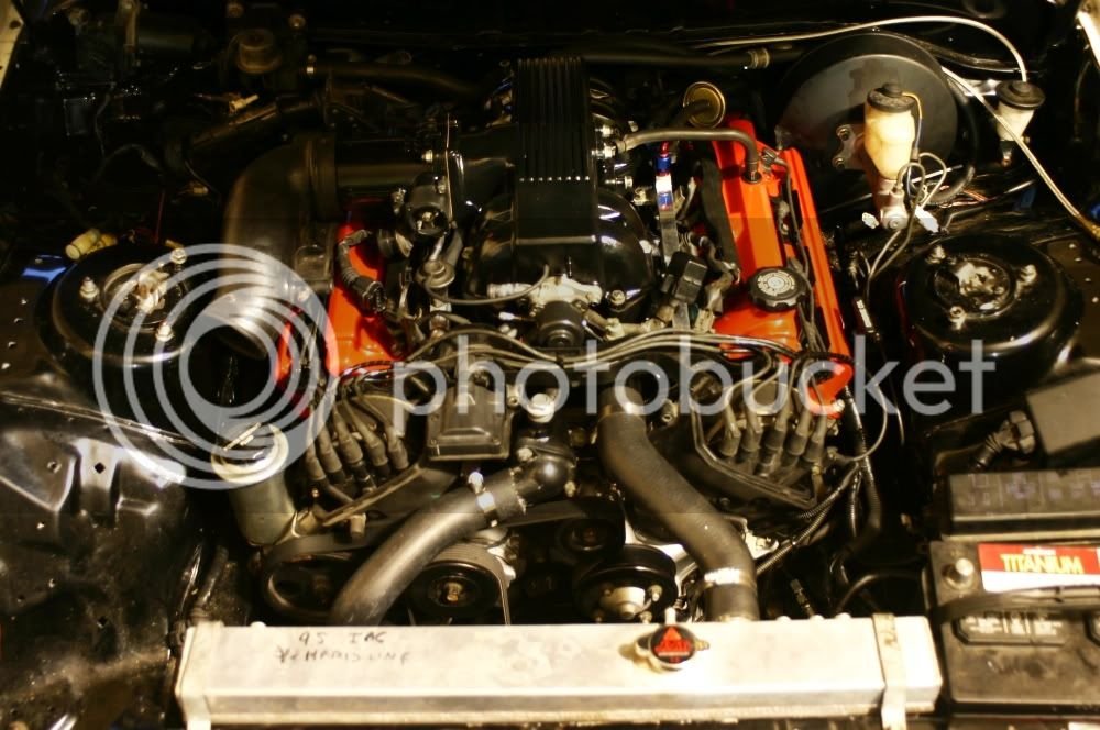

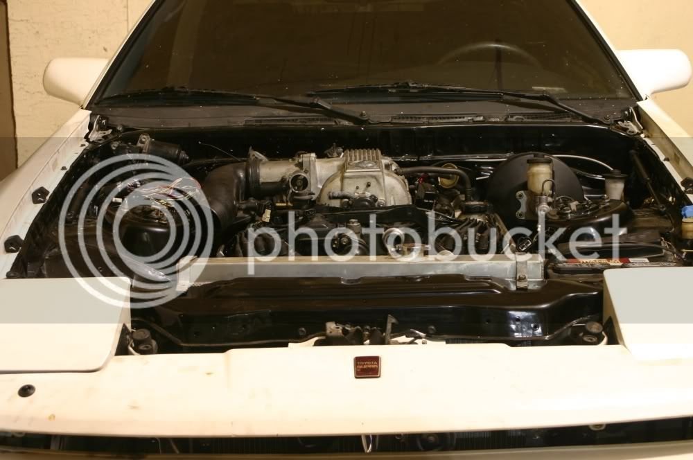

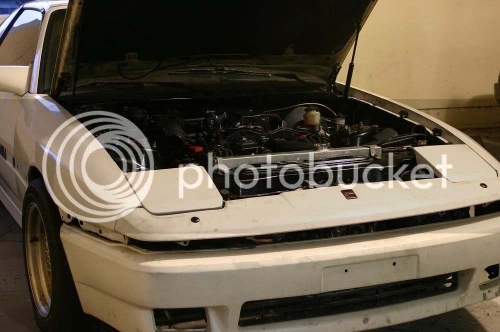

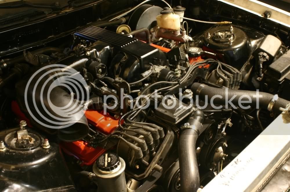

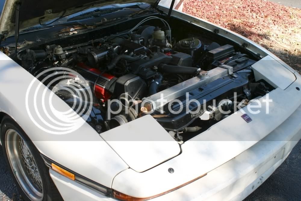

After some hammer action (pre89 issue) to the firewall, subframe, and my brain, I got it to fit perfect. These pics will show a progression from when it went it, cleaning up the wiring and whatnot. And a small video of how it sits right now, before the surgery continues...

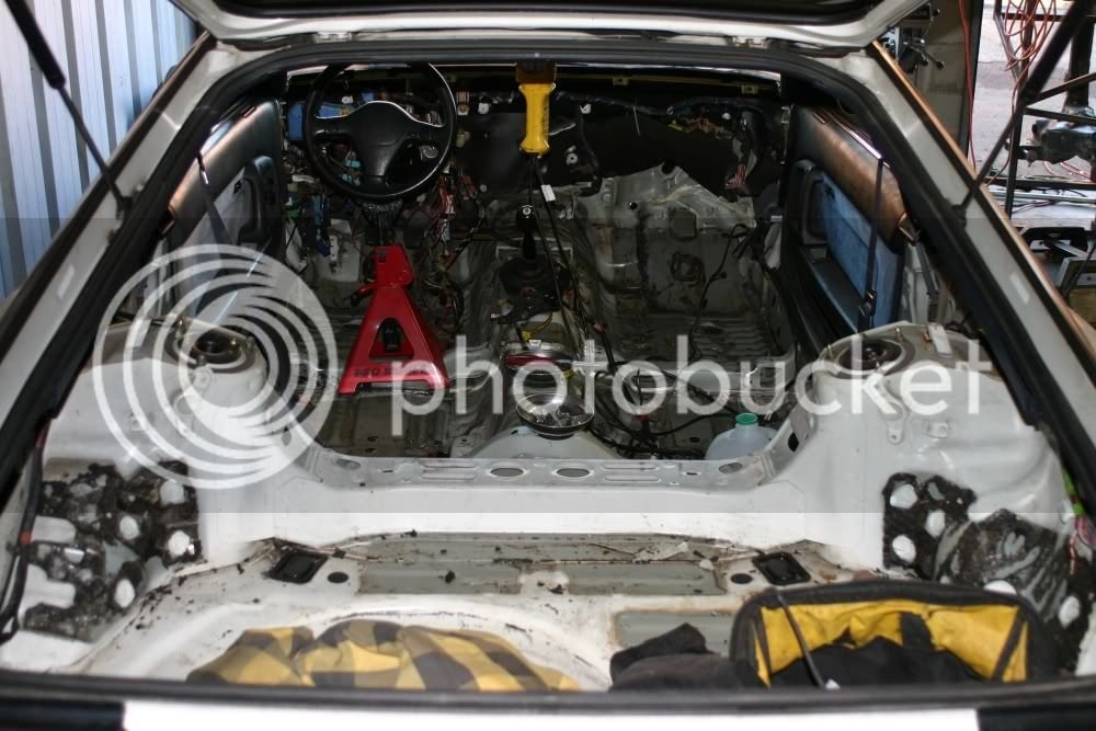

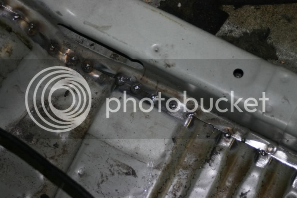

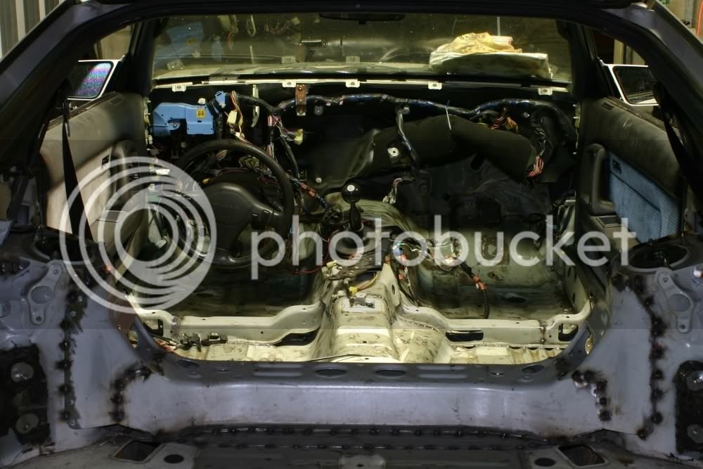

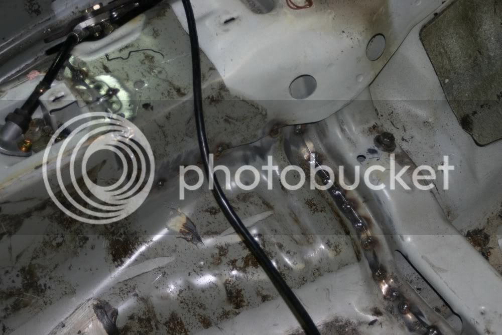

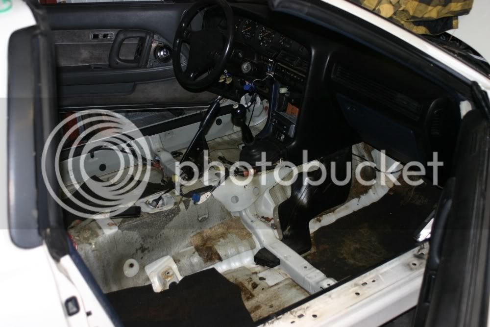

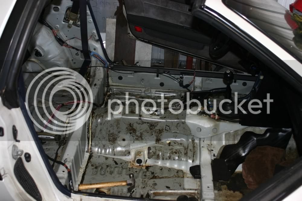

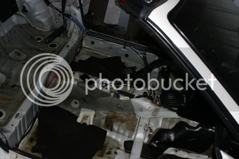

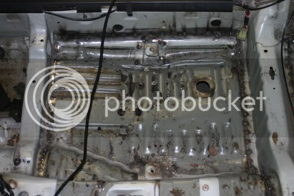

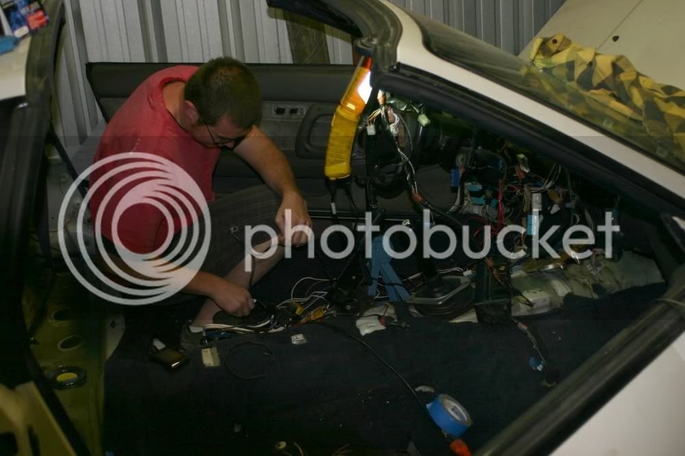

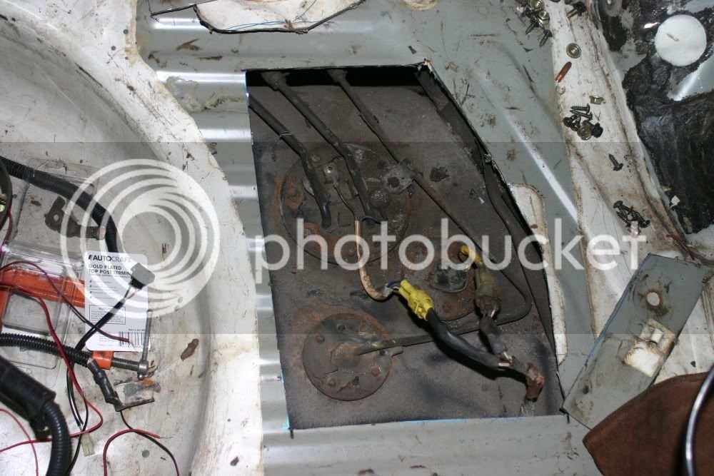

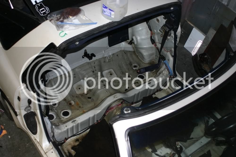

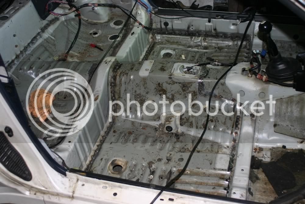

Okay stripped a good portion of the interior today. Im removing the sound deadening and stitch welding it. Drop some weight and make it stiffer, bingo!
Found an AT&T LG phone in the car, any of the past owners (few on this site) want to claim it haha?

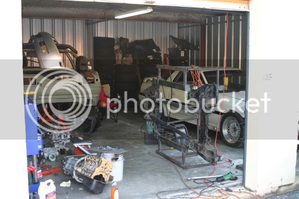

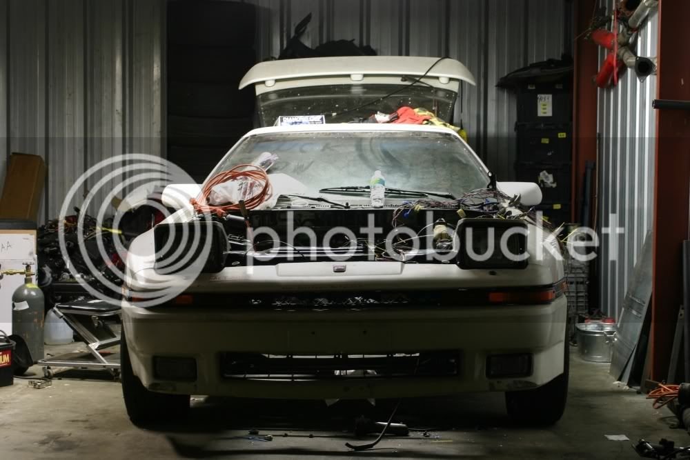

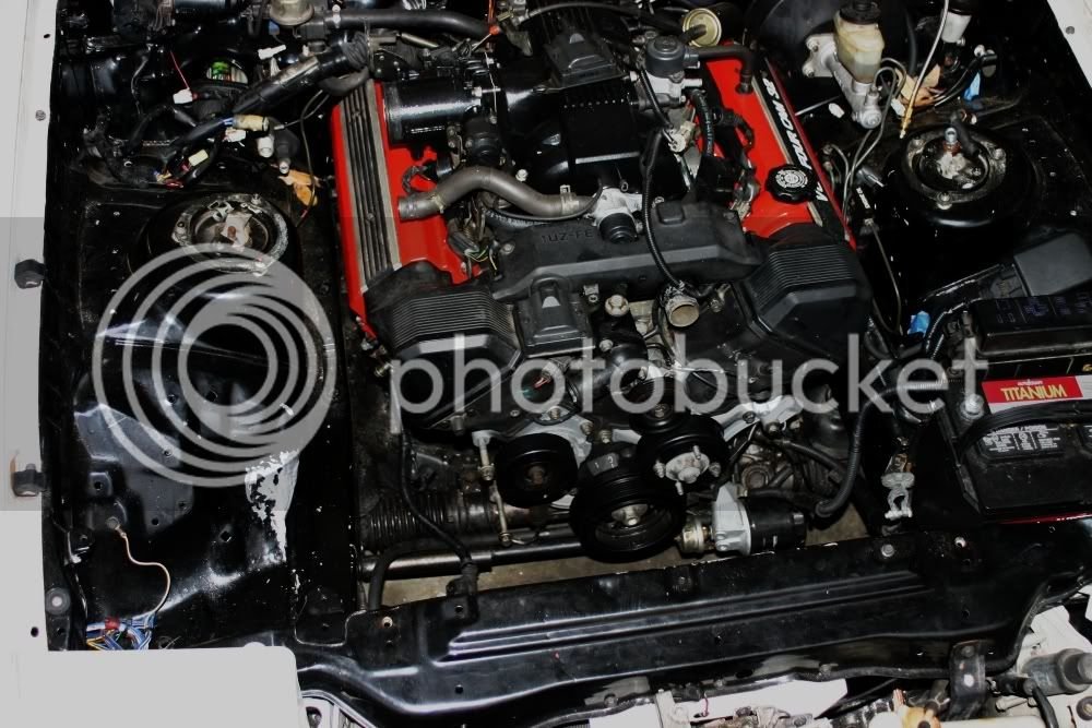

Started to take some stuff out of the engine bay...
Pile of shit
Some stripping...

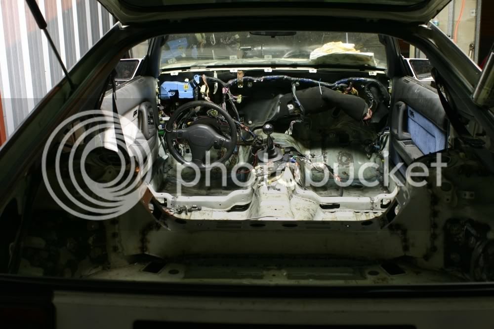

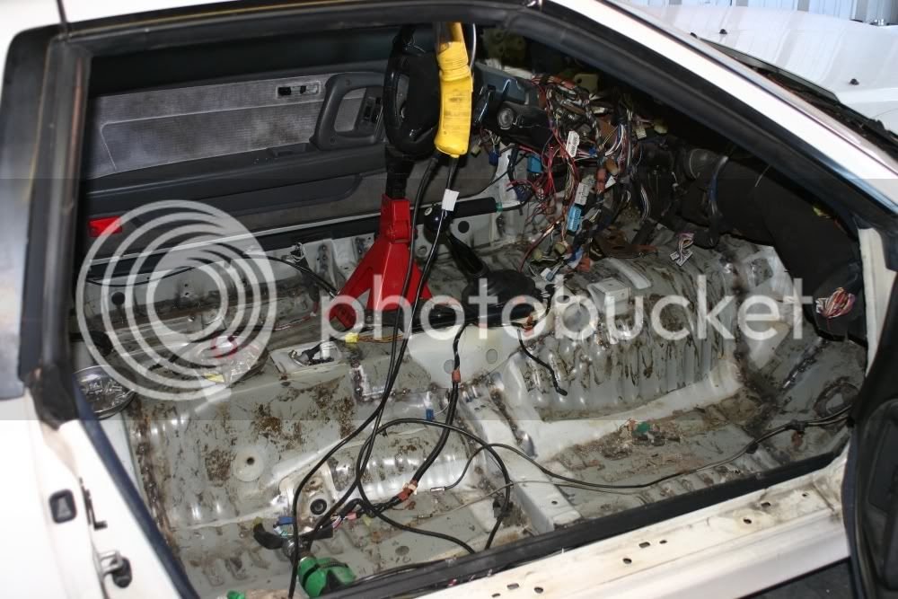

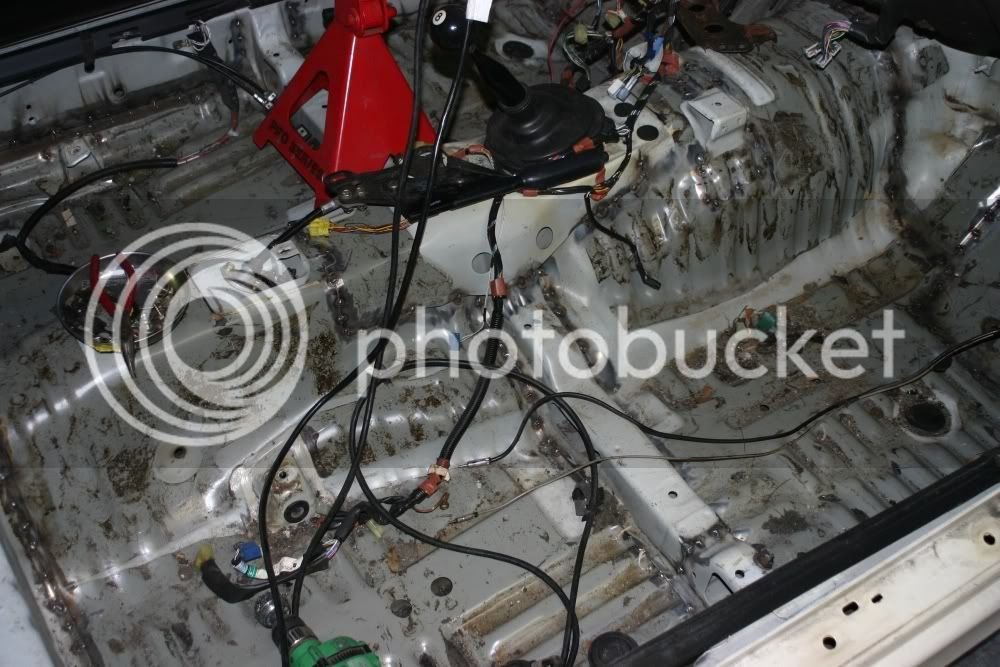

Got a bunch out today... with only 3lbs of dry ice I got most of the main cabin taken out.

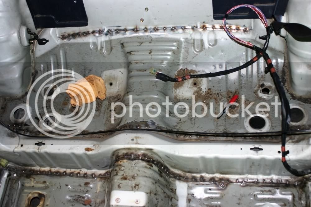

Okay Finished all the inside stitch welding.

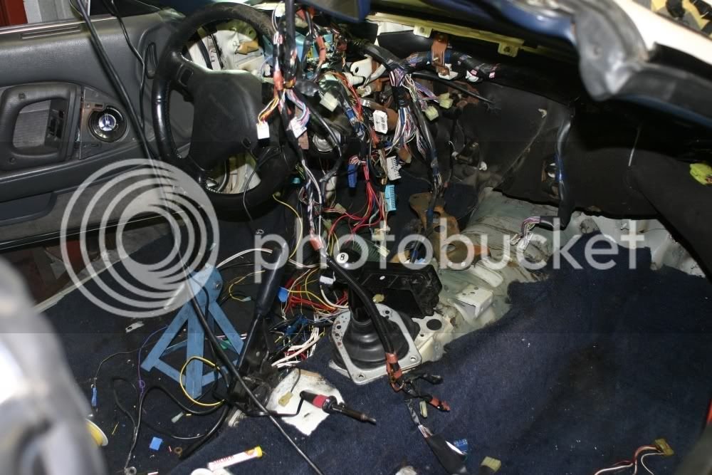

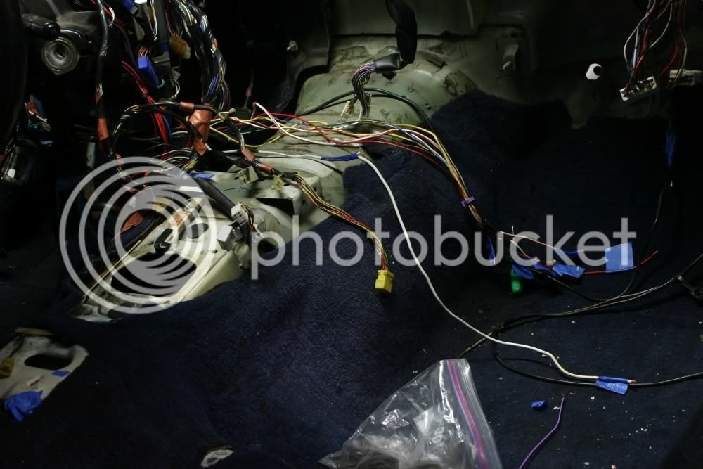

Alright so I moved the fusebox into the cabin of the car today... I did finish, but the batteries died on the camera... but here is some shots.
It is pretty cleaned up now and works still.

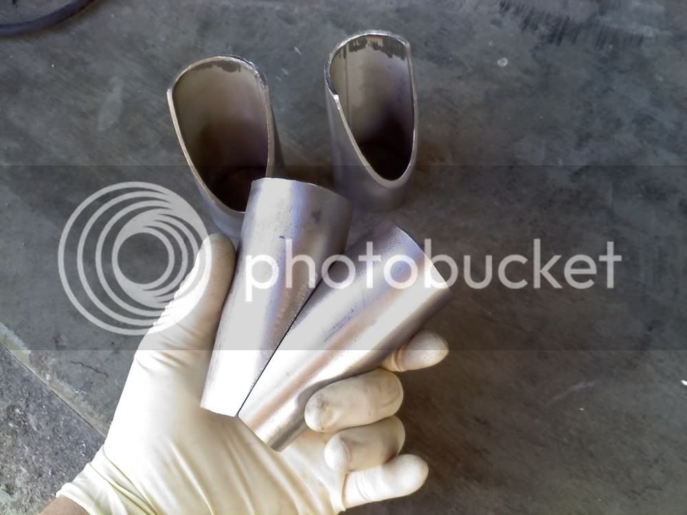

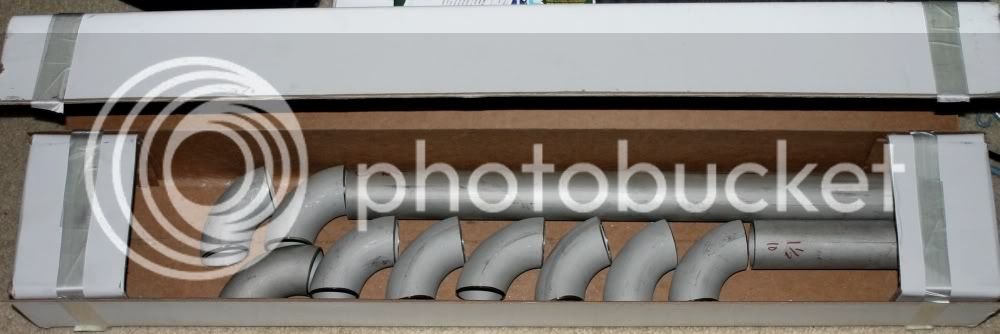

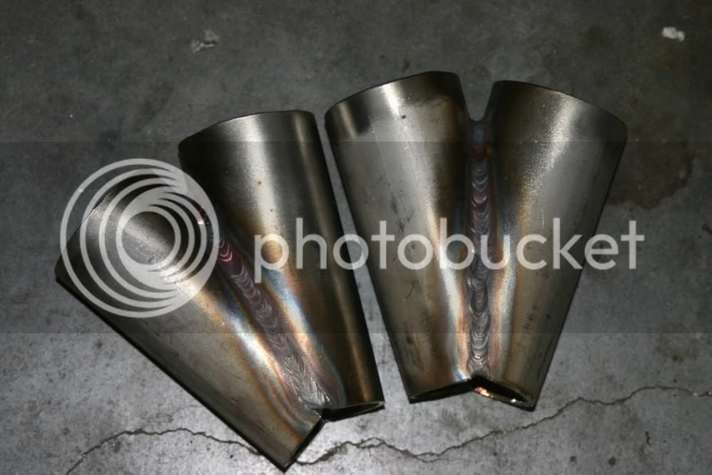

Okay well pics have been done for a bit, but now back up :). Alright I took a small vacation to give myself a break, but I am back on it. My original goal of a simple 4-1 manifold setup will not work, it just does not clear... oh well, waste of 2ft of SCH10 piping.
So now I made some 2-1 collectors, waiting to weld them, so no pics yet ;).

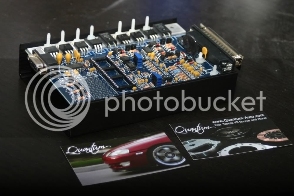

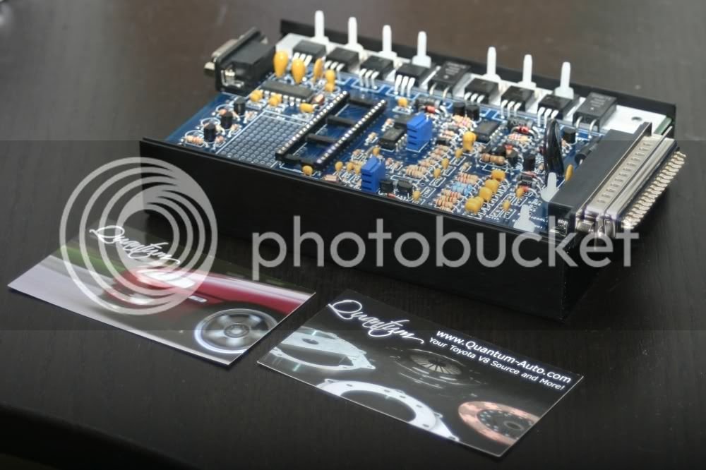

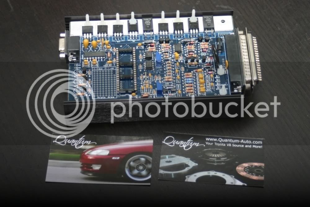

Busted ass on the MS3, I am ready to install the actually MS3 cpu and the expansion board next.
Okay dropped off some stuff at the shop. Snapped a pic of the collector, ready to be tigged.

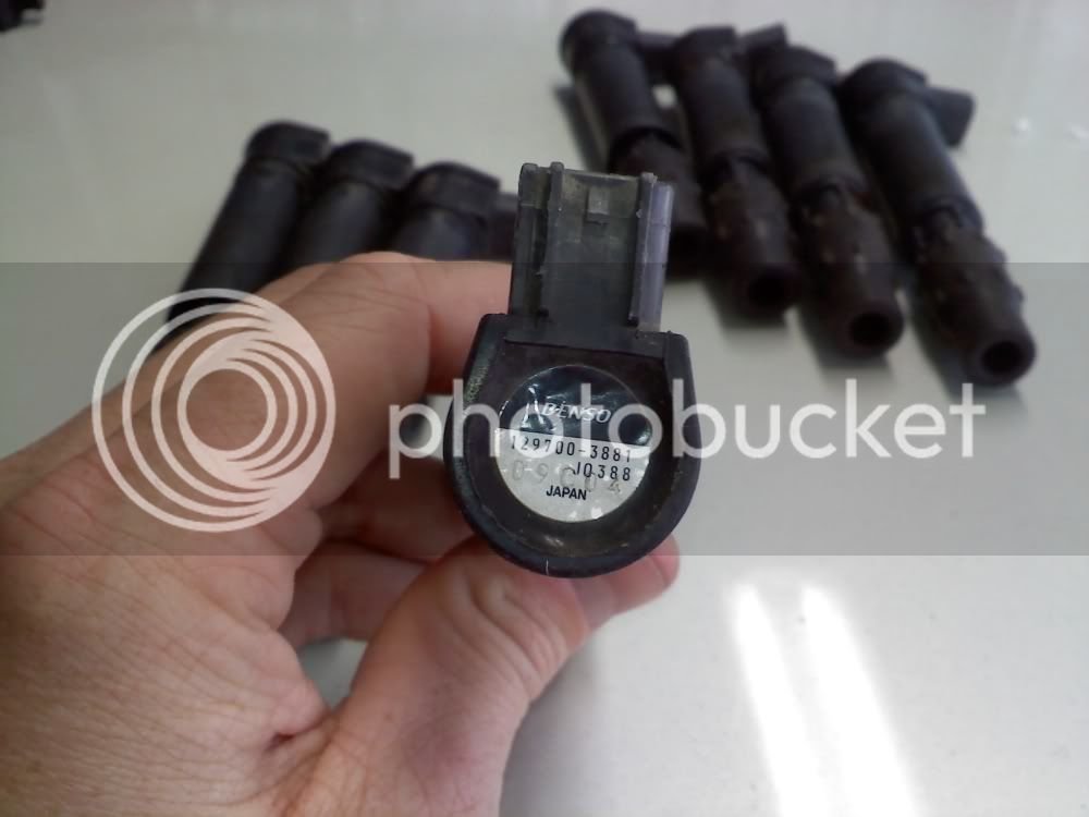

And I will try to use these CBR 600 F4i coils on the MS3x.

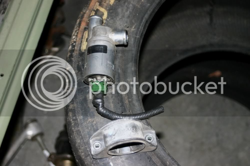

Picked up a Volvo 2 wire fast idle valve, should work well and very simple.

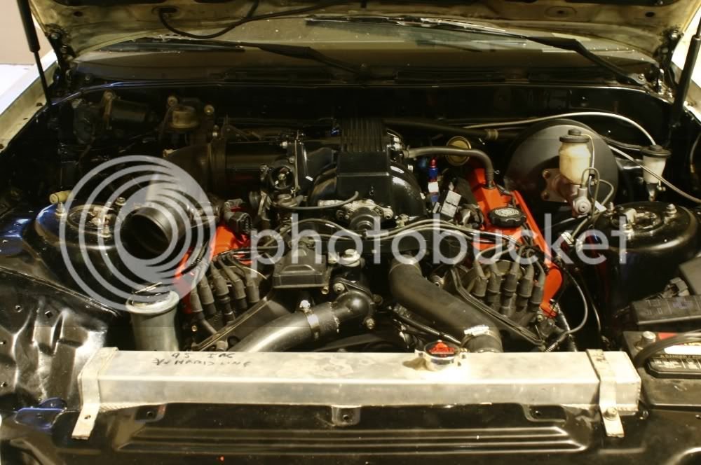

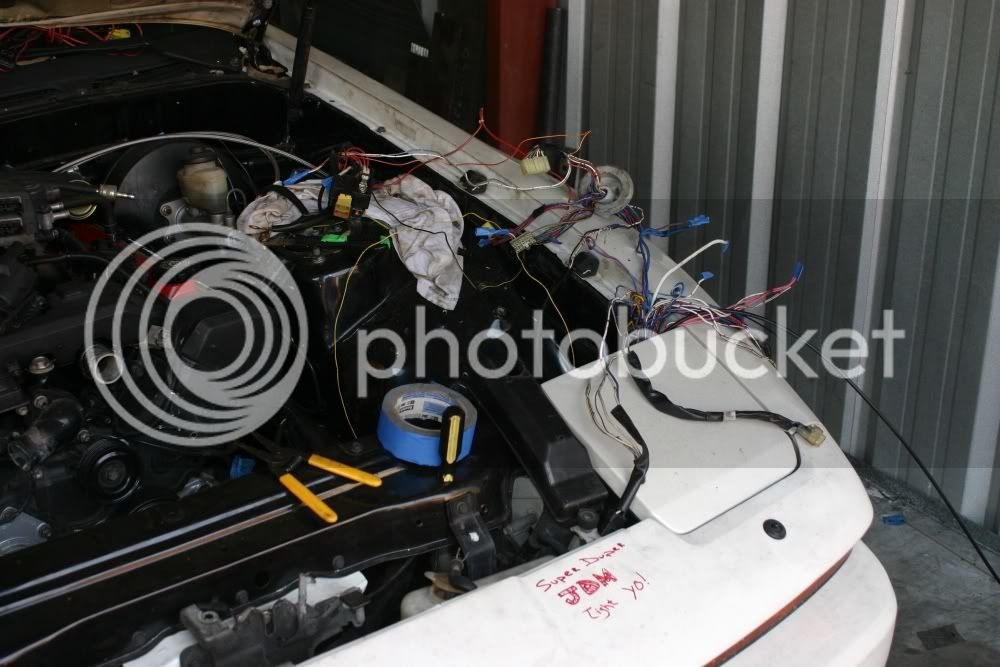

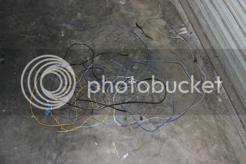

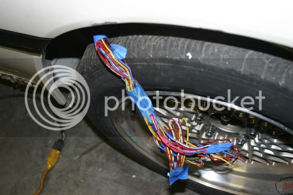

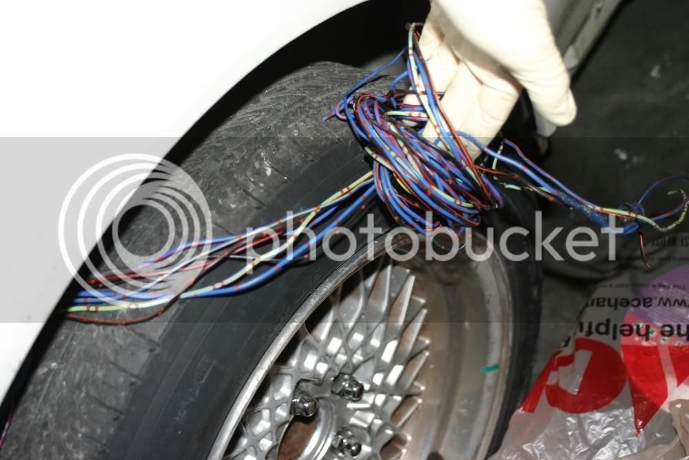

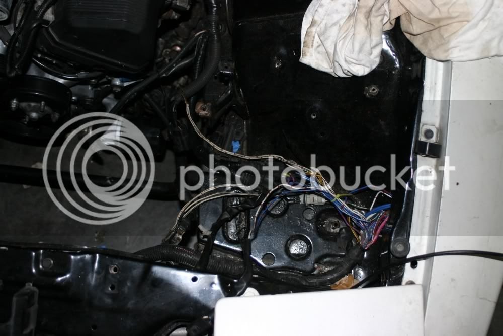

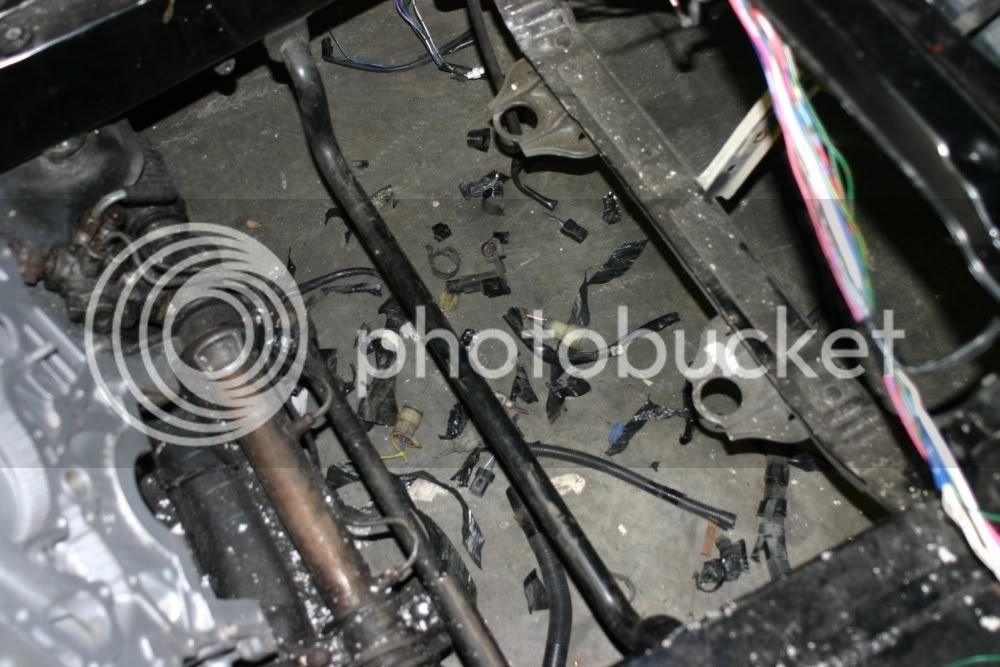

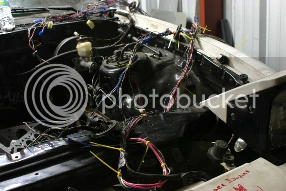

I cleaned up the engine bay wiring a lot today... pulled more and more out...
This stuff still needs to be pulled through and cut off
Looking good. Will be interested to see how the MS3 goesand those coils. Looks like you have assembled it with more components than required. I'm assuming your using the injector drivers on the ms3x board.
I only just got mine running the other day on MS2 with the Maxima throttles you sold me. It actually runs really well on the base tables that are in the firmware with just the ignition and injector setting to suit the 1uz.

Awesome glad your project is coming along. I am going to try and use these coils but in the back of my mind I dont see it working out that well. If not I will have to source a nice 3 wire setup or just do EDIS.
Don't go back to EDIS, worst case just use EDIS coils (or any wasted spark coils) and drive them from the MS3 with bip313's to give a wasted spark set up.
