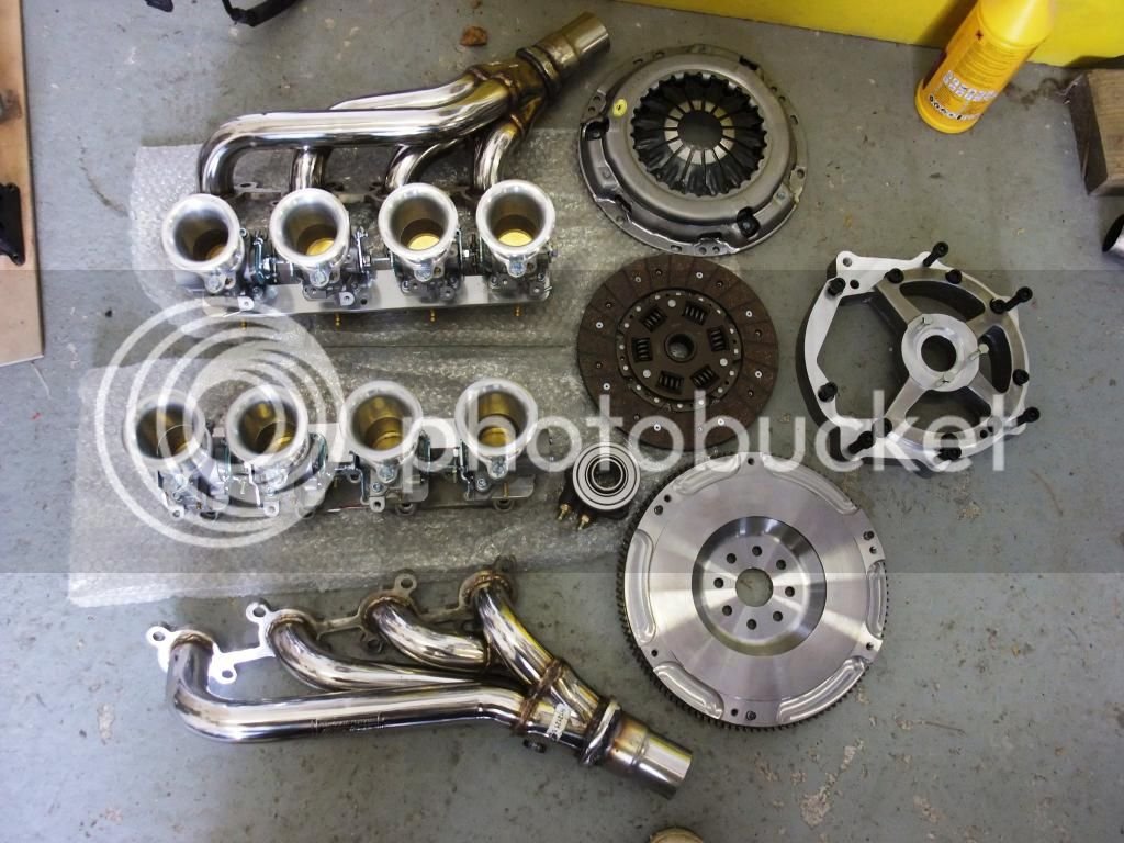

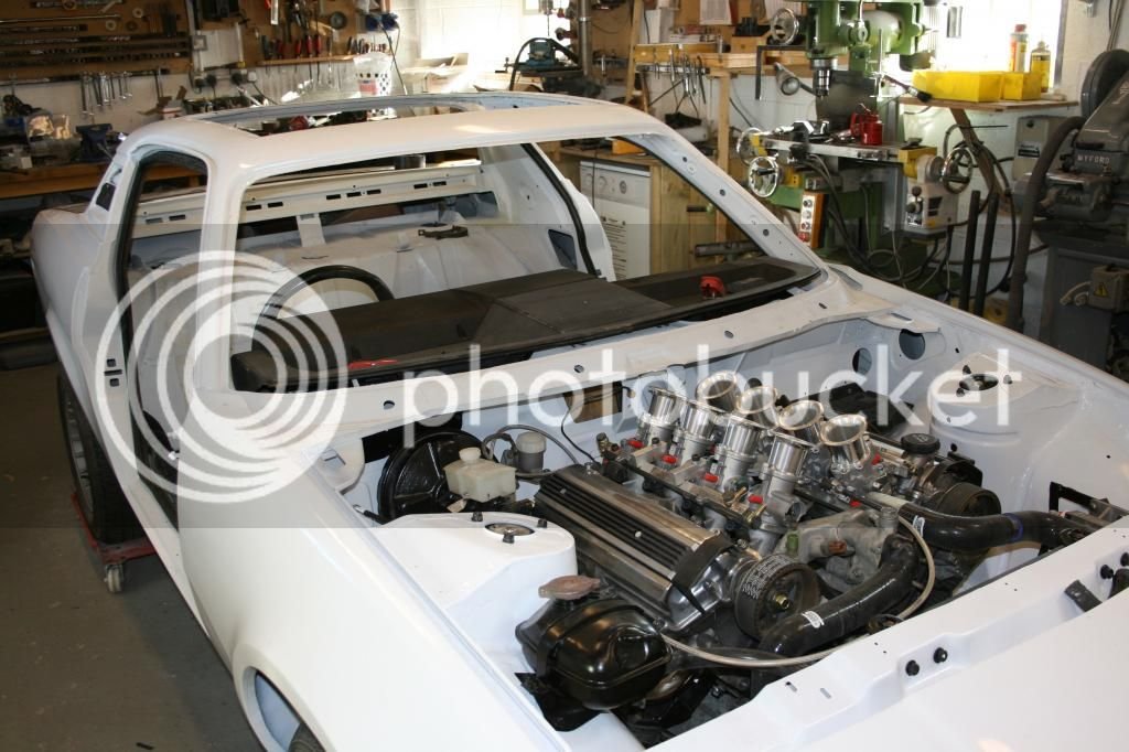

The R154/W58 are not that rare or expensive, I wanted one for my 1UZ/TR7 project and over the course of the past 18 months must have seen 20+ up for sale, mostly priced in the £500 to £800 range for a R154, and £300 to £450 for the W8. I ended up paying £700 for a R154.
The expensive bit is the flywheel, clutch and bellhousing (or adapter plate) assembly.
i was watching a w58 on ebay this week, it finished up at £675 plus postage, way too much for what it is. a cosworth t5 just ended at £1000, i must be looking in the wrong places, where did you find yours? i just had a look through your tr7 pictures, it looks like its going to be a beast, looking really nice, what sort of power figures do you expect with the itb's and what is the engine spec.

Engine is standard other than the exhaust manifolds, ITB's and ecu, I am hoping bhp to be 325ish at the flywheel .....time will tell!
