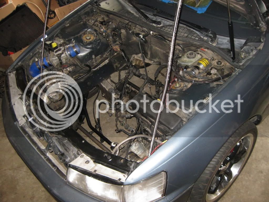

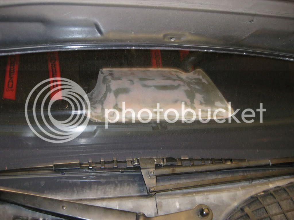

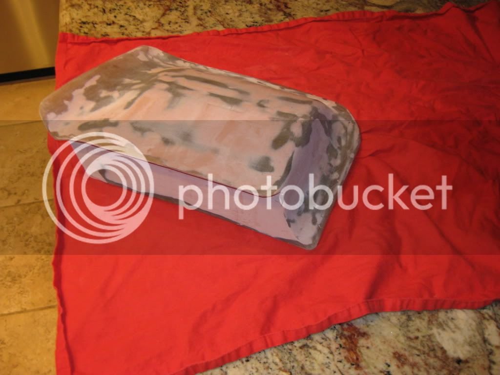

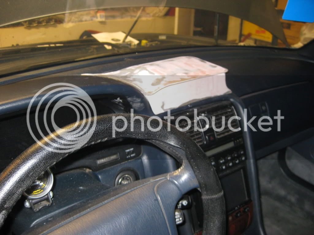

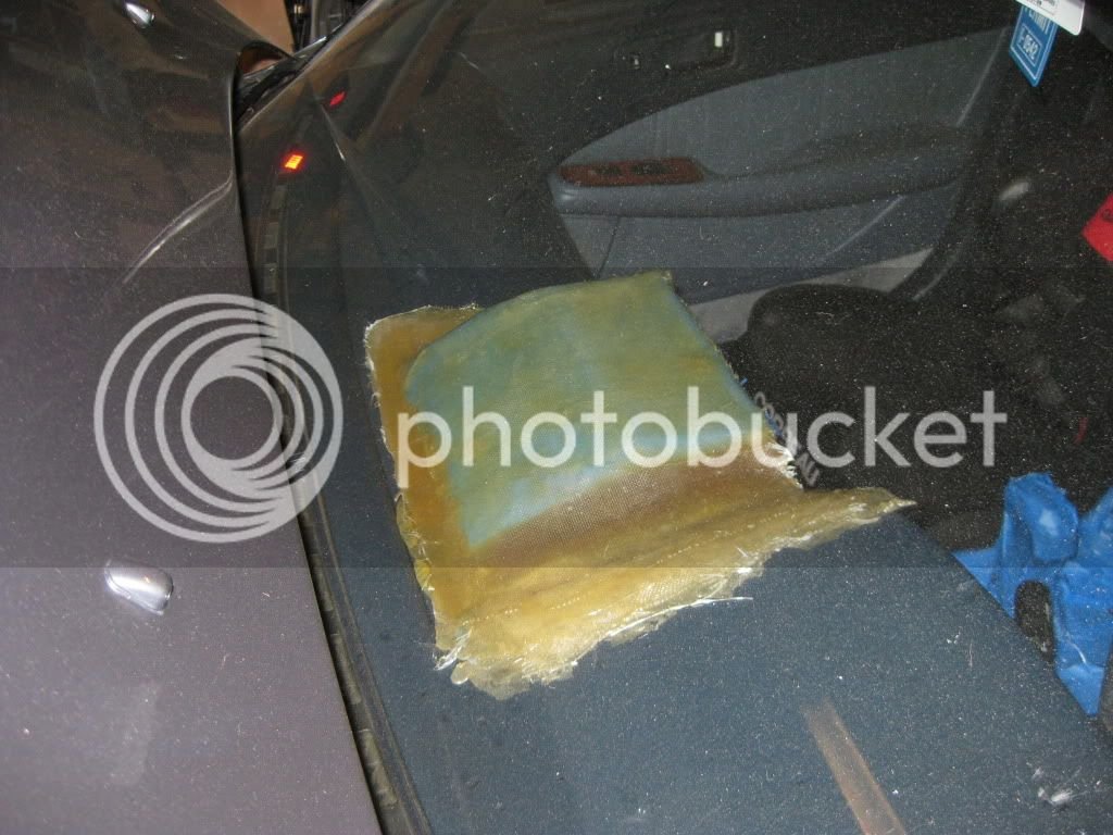

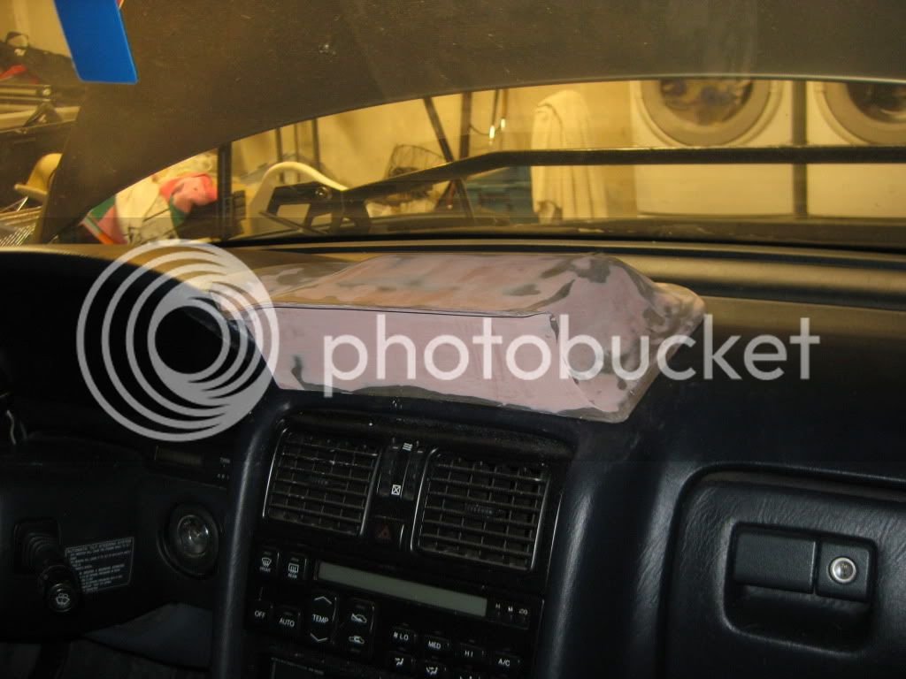

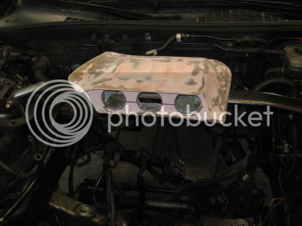

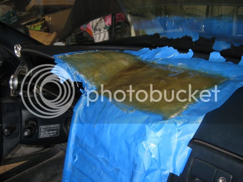

Here's a few pics of what I have been up to this weekend. The engine bay is a little greasy from the 200,000 miles since it was first dropped in, so I have grease detail all day lol. Also, since I will need 3 more 52mm gauges I need more room to mount them and don't want pedistals on my center dash to attract attention so I started a custom fiberglass cluster that i'm trying to "integrate" with the stock cluster bezel. Basically molding on an extension for 2 wideband's and a single tranny temp.
Once it's done I will cut out a backing for the gauges to mount to out of a sheet of carbon fiber and the center gauge will rock carbon face to match my boost and volt gauges.

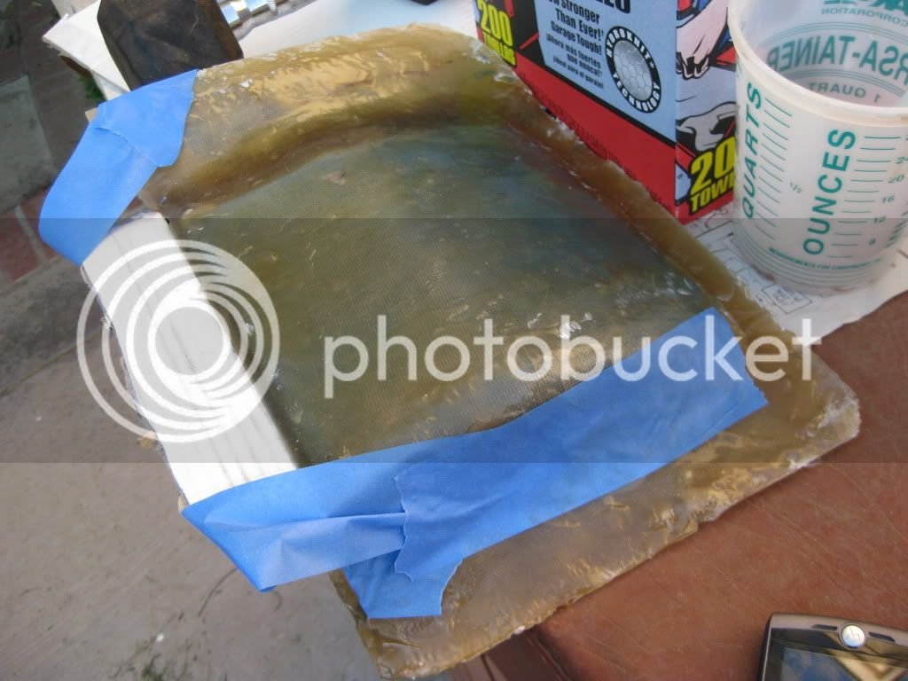

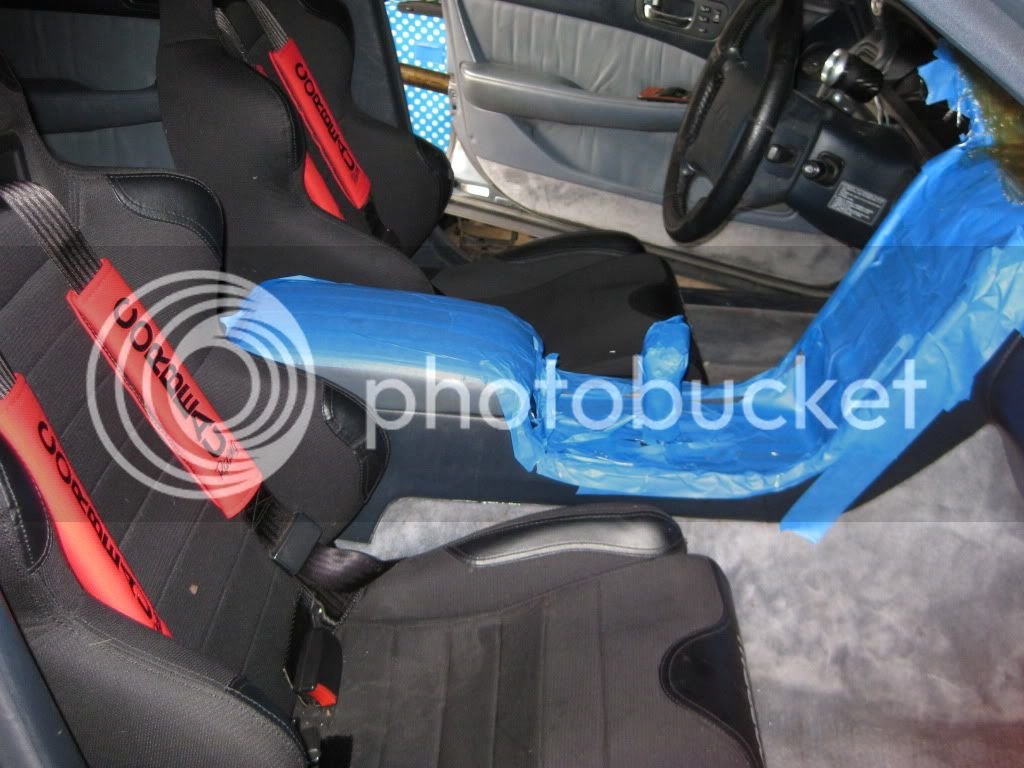

When ever I do fiberglass to an interior like that, I put down a layer of tape (green tape works best because it sticks to stuff I could not get blue tape to stick to), a layer of aluminum foil, then wax it at least 2x. Might want to cover a little more of the dash, ect. You would be surprised just how far away from what you're glassing can get resin on it.
Also, when you're finishing the part its best to let it sit for a while once you think you have it done before painting, because the glass will still be shrinking. The more time is better, up to a week if you can.
This is my 1st fiberglass job. Really wanted to give it a try... SUPER messy stuff tho, in heinsight I should have done the entire dash like u said. I have a mess of pics i'll put up later but it's coming out real nice... blends w/ dash just how i'd hoped.

here's some progress of the cluster.

here's with rough cuts for three 52mm gauges, thinking black face, black bezel UEGO wideband on each end w/ CF Autometer Tranny temp in middle?
