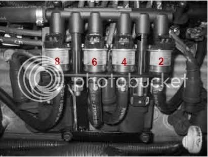

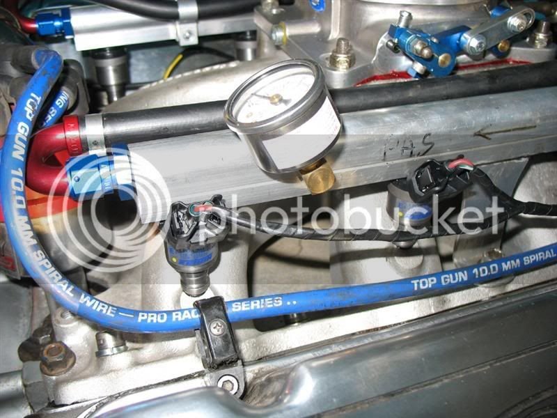

The two photos below show how the Prins' injectors (which are actually Japanese Keihin units) are commonly mounted - the first photo (courtesy of ProFire EMS) is a conventional port mount where they've replaced the liquid injectors with the Keihins.
The 2nd photo (courtesy of Prins Installation Manual) is the 2nd method that I referred to in the previous message. Each bank is mounted in a block of 4, and their inlets are connected to a common rail, then they have flexible hose/tubing running to 1/8" NPT elbows mounted in the manifold runners. So when an injector pulses open, the gas has to travel down this tubing to enter the manifold, and then to the inlet port. Doesn't seem like the optimal way to do it, but apparently it works.
