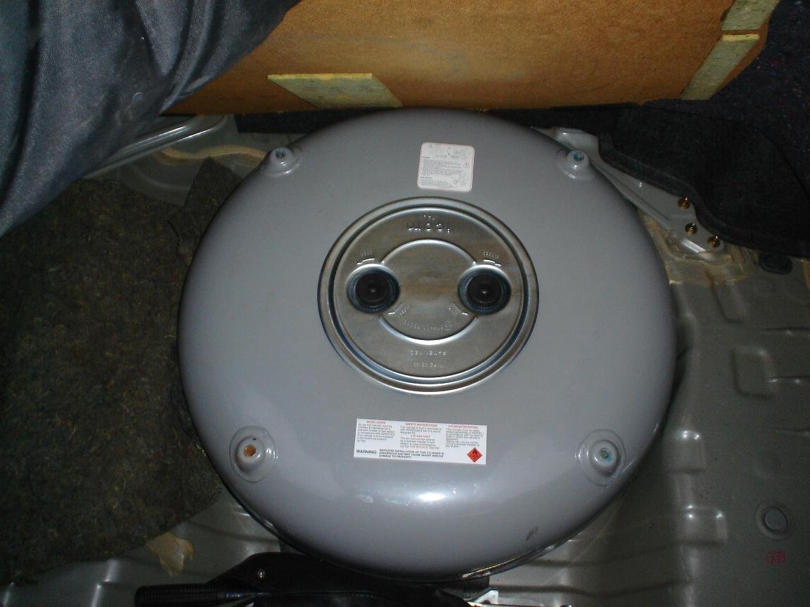

What are you doing for an LPG tank?
hey guys, no pics of the prins setup atm, just waiting to get some time for the install. im using a round tank in my spare tire well. only like 40-50L i beleive. The car is currently tuned for 14psi with a stock turbo and it runs fine on 98 octane fuel, so i'm presuming that it should be fine on gas just a little rich. it will be running the largest keihein injectors which i think are 93cc but dont quote me on those figures.

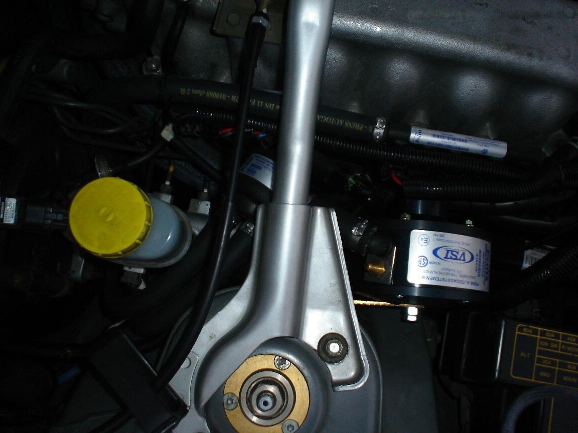

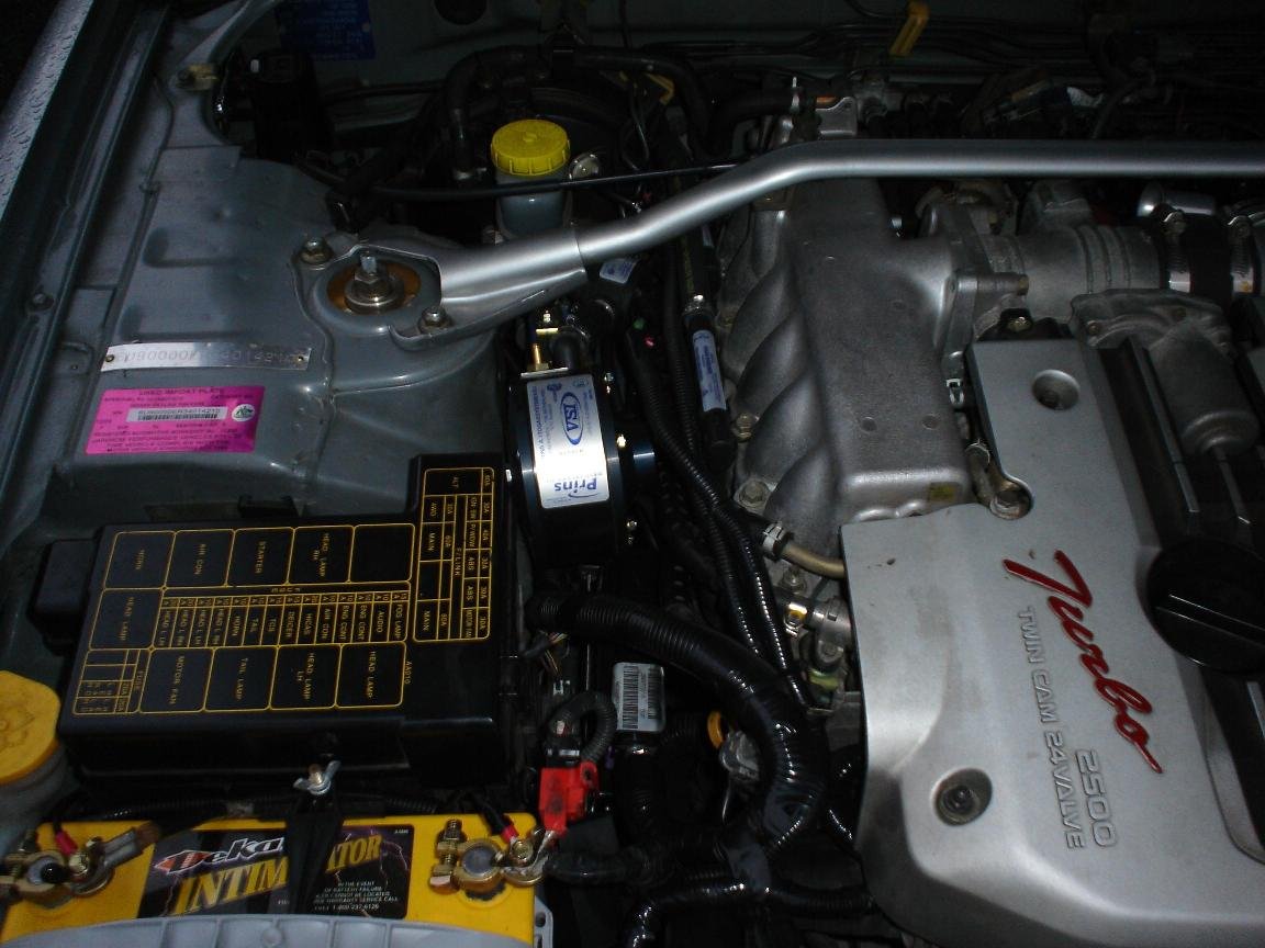

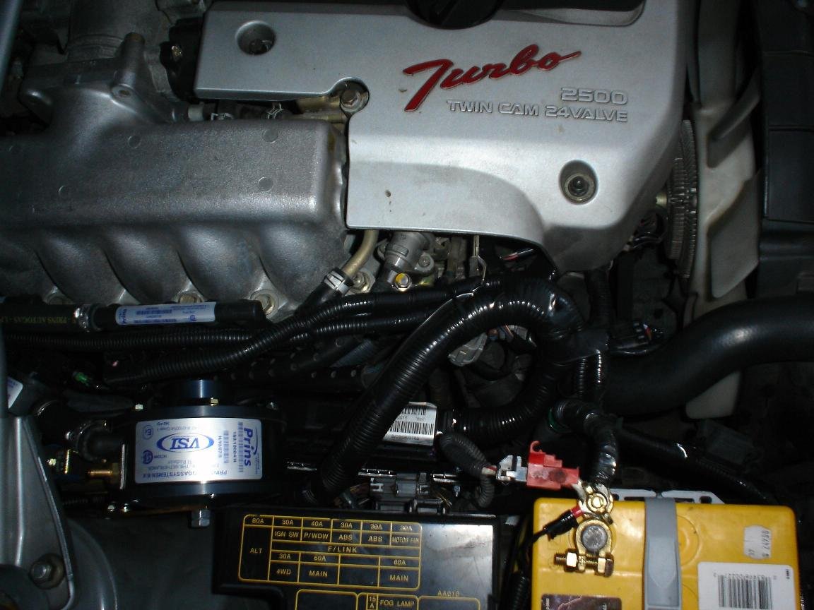

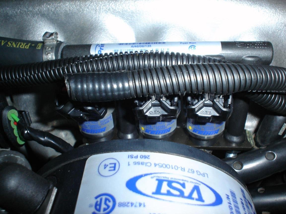

hello ppls of the world. finaly got a camera that would work. so here are some pics of the Prins setup on my GTT skyline. the car runs great for untuned car. it costs me $35 to drive the same distance it used to cost me $70............. and there is no knock wat so ever on gas. the car pulled 244rwhp on petrol with a dodgy tune. so it should be interesting to see what happens when it goes back for the final tune. i would recomend this conversion to any 1 who has $5k floating around with no good use.
chris
