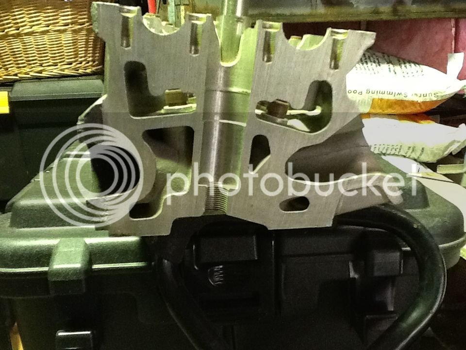

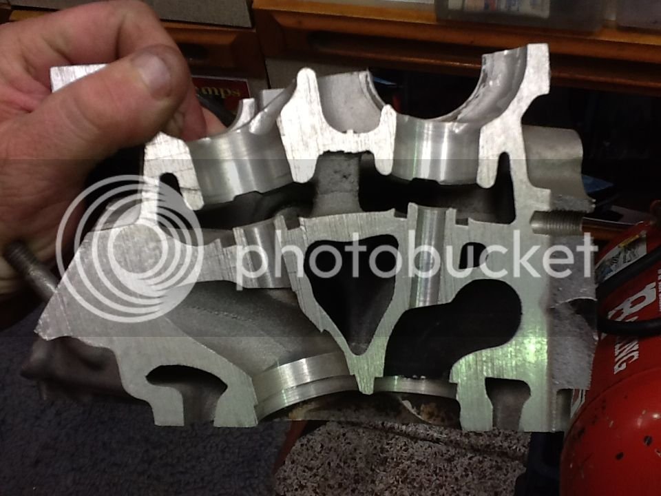

JustenGT8 New Member Jan 6, 2013 #31 Shows how easy it is to port thru into the water gallery on the exhaust side....which a mate did with dramatic steam bath results on the dyno
ash New Member Jan 6, 2013 #32 JustenGT8 said: Shows how easy it is to port thru into the water gallery on the exhaust side....which a mate did with dramatic steam bath results on the dyno Click to expand... See, it's shows I'm a nice guy to share pictures And More importantly, the spring seat area , so u can put a better spring into the head
