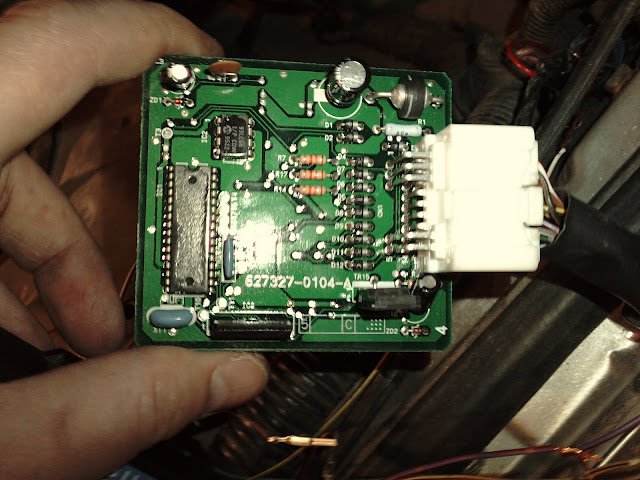

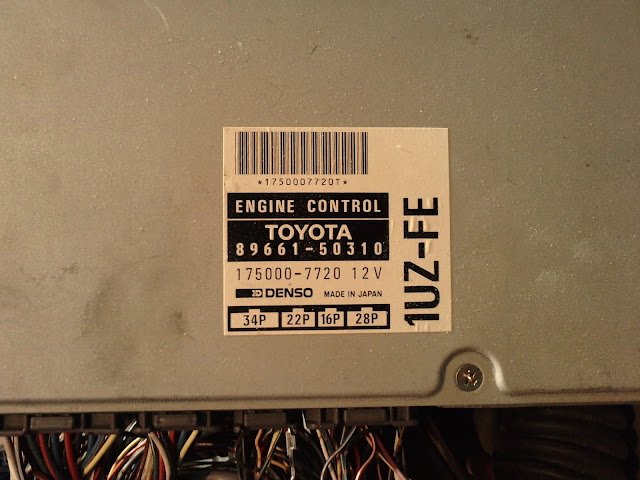

can you put out photos of the immobiliser ECU. Sounds like you have a coil/spark issue. Also what is your engine ECU number? maybe a photo of that too. Cheers

I have only photo of the inside of immo unit
ecu

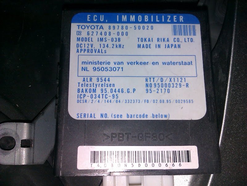

that immob ecu does it have a box it comes with
what does it say on the box

its usa ls400.. I have a box but didnt took a picture of it (I'll get one today)

here we have Immobilizer ECU
