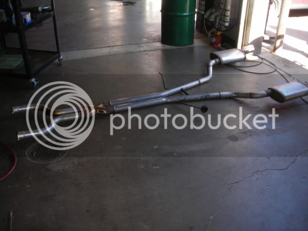

Sorry for the late reply on the exhaust. Here's a pic of my 2.25" setup:
2.25" mandrel aluminized steel
2 magnaflow straight thru's
swaged pipes from 2.5" to 2.25" for header fmanges
magnaflow X-pipe (H-pipe is fine also)
4" tips

Nice exhaust in above post....
