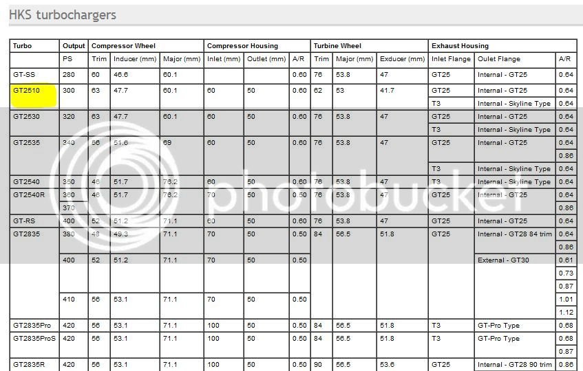

NISSAN GT-R
Engine size 3.8L
The GT-R is slighter smaller than a 1uz and comes with a pair of IHI turbos. and according to This article http://www.2009gtr.com/2008/02/r35-gt-r-turbo-get-to-know-your.html
they are equivalent to the HKS 2510 that I highlighted in the pic below.
![Capture-5.jpg Capture-5.jpg](https://www.lextreme.com/forums/data/attachments/21/21500-2a0b1f6ad4804dd04e38100c1b2da5c2.jpg?hash=KgsfatSATd)
The Funny thing is the BMW turbos are smaller than the GT-R ones, even though the BMW has a bigger engine. which is confusing. I would imagine a GT-R doesnt have much if any lag.

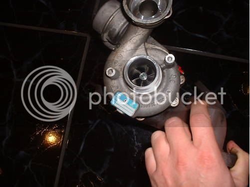

BMW
Engine size 4.4L
Just a bit bigger than a 1uz, The TT 4.4L BMW X5 M comes with a pair of Garrett Turbos the model is MGT2260SDL and it looks like this..
![Capture-3.jpg Capture-3.jpg](https://www.lextreme.com/forums/data/attachments/21/21498-411bec032d9d1cf14b94a1ba8ee07700.jpg?hash=QRvsAy2dHP)

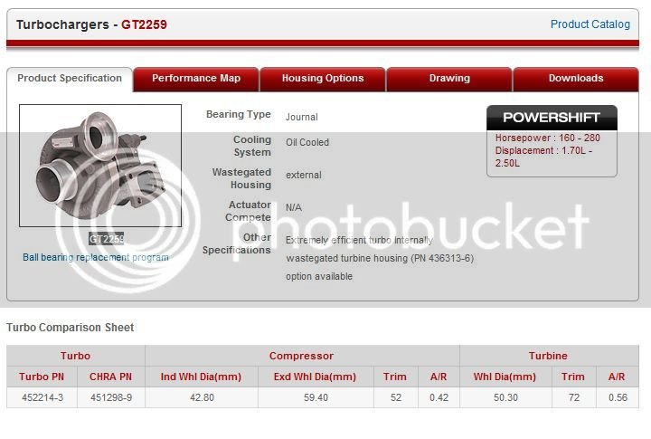

The new M5 TT comes with a slightly larger version, but nonetheless are still really small turbos.
I cant seem to find the actual specs but based on how they look compared to the hand Im guessing they are comparable to GT2259

NISSAN GT-R
Engine size 3.8L
