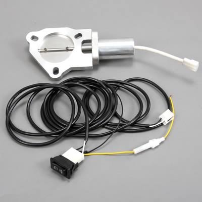

Rod, how about a couple of exhaust valves?
This one from Summit is on ebay for $130
Install it inside one or both pipes. One pipe may be all that is needed.
Close off enough flow to meet requirements and open for max flow.
Illegal, engineer won't pass it. Big fine too (ps i work for the EPA ;))
Wow, the ZO6 Corvette has exhaust valves stock. The old Infiniti Q45 did as well and probably some I am forgetting. I understand if they are installed as cutouts but I am talking inside and inline each tube after the muffler but before the tailpipe outlets.
