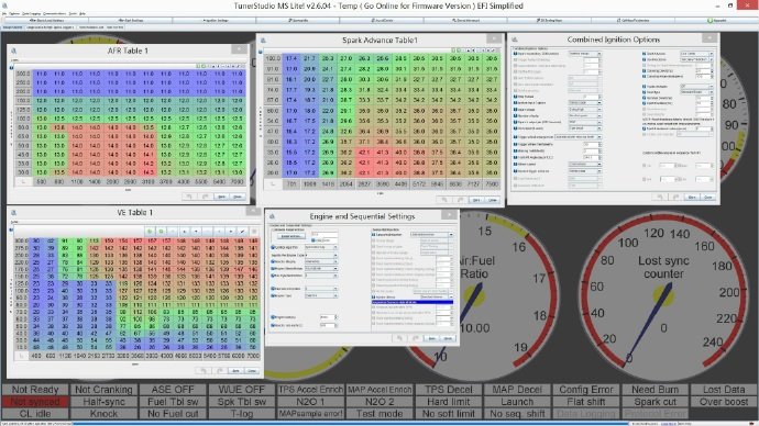

I have put AFR meter on the car and tried to tune fuel correctly. And we have PWM controller for vvt and set it as 0 advance/retard. Cranking spark advance is 10degree, and required fuel is 6ms.
I am trying to upload the screen shot of Tuner Studio.88e6ea4bjw1eky7hvbh0pj21kw0w0x0b.jpg
maybe this one got better quality
