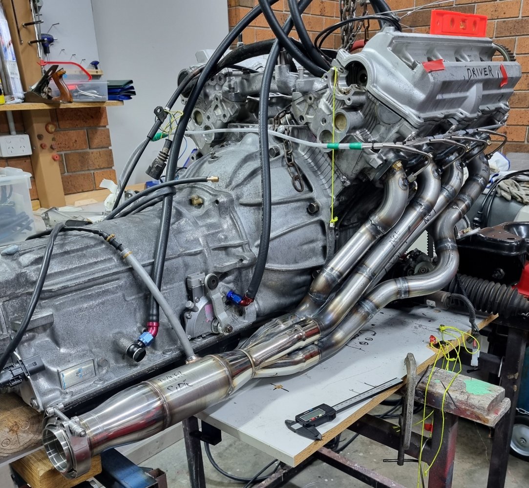

Any fabricatied purpose built pipes will cost a lot more than purchasing an off the shelf set. People just don't realise the cost of material and labor involved. I just completed a set of pipes with 15 degree merge collectors a little while ago, a mix of mild steel from the heads to stainless from the collector, with EGTs. Then HPC coated. My cost was approaching 1900$ AUD. To set would be asking around the 3k$ mark. Full stainless would have added another 150 - 200$ because the material is much more expensive.
Picture below taken b4 HPC coating

Very nice! You have your level up top and everything. So what you’re saying is…..you can build me a set of RHD UCF30 headers? I’m well aware that custom fabrication is substantially more expensive, the people I know that can build custom headers don’t even really like to. I would love a set that are more long tube like yours. The PPE have good reviews and I think could be modified, I’d just like to see if someone has tried. Plus I would keep the two catalysts to keep the stink down. But of if I have to get the LH PPE and get a right fabricated, I will probably be ready to eat the cost by the time that could happen. Maybe even get a set of long tubes made if I’m really doing well. Thanks for the reply!
