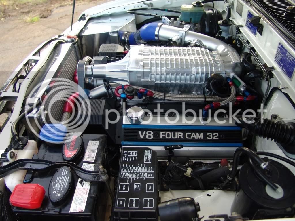

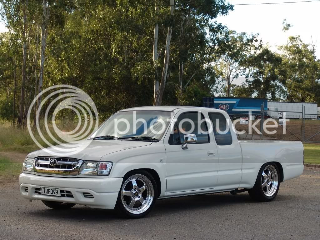

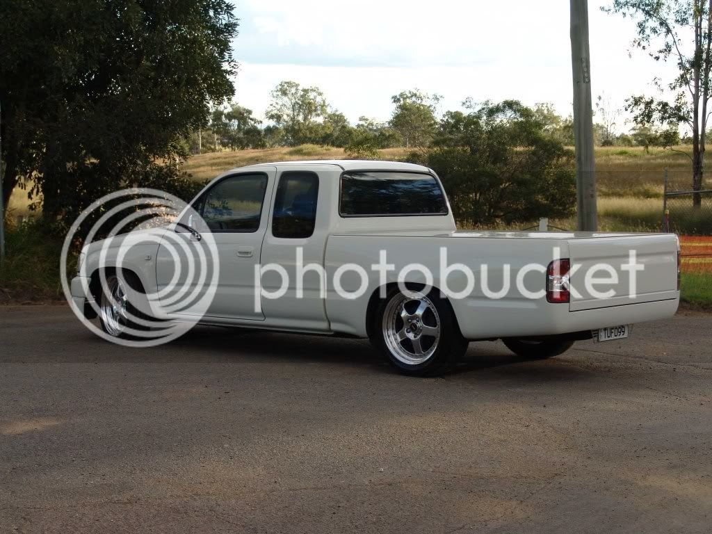

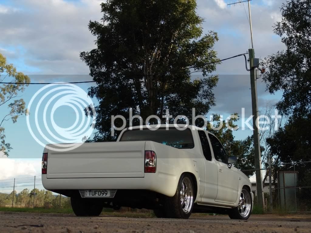

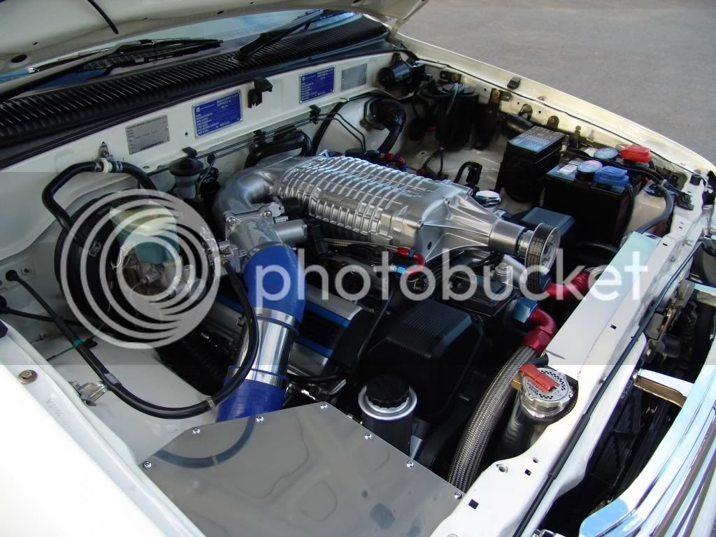

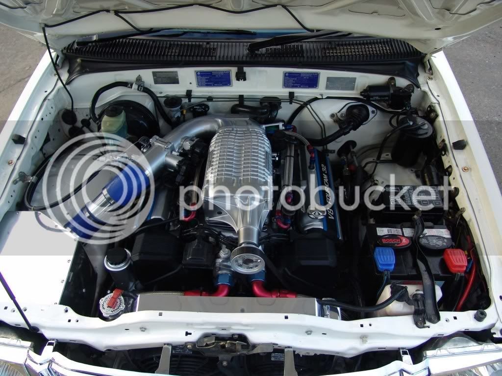

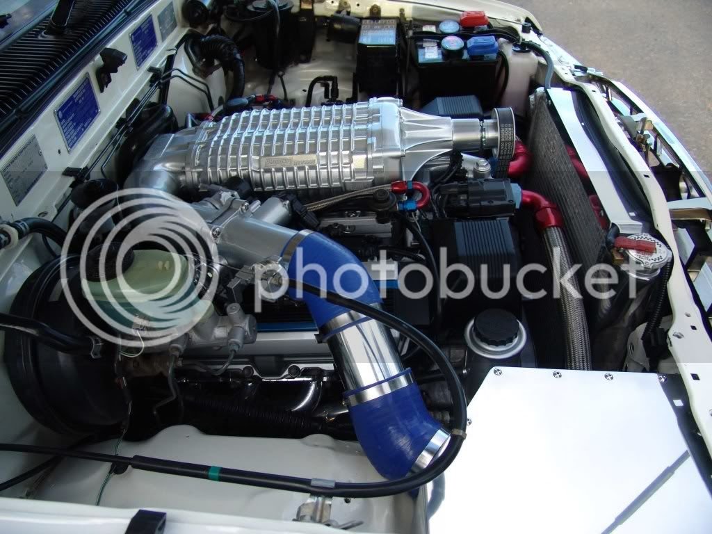

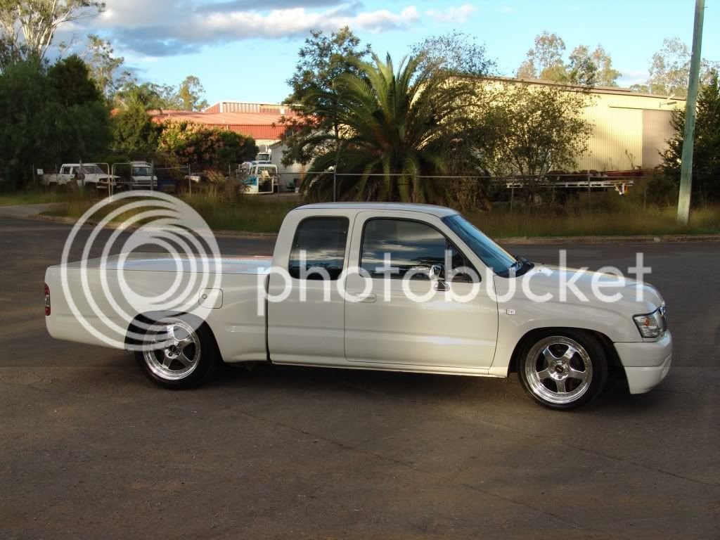

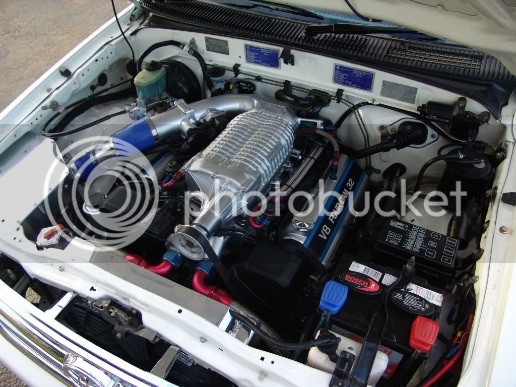

Okay guys.... Finally got a chance to get the old girl all cleaned up for some happy snaps. So have attached below a few pictures of the finished supercharger setup and the ute itself as well as a some brief details of the whole deal.
Car:
-1999 Toyota Hilux Extra Cab Ute
-2002 4WD SR5 Complete Front End Upgrade
-18" FR18 Simmons Wheels

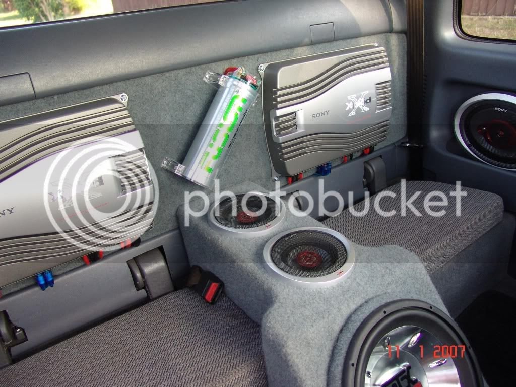

-Sony Stereo Setup & MTX Sub
-Custom Alloy Hardlid
-Reset Leaf Springs & Lowering Blocks, Drop Spindles, Pedders Lowered Shocks All Round

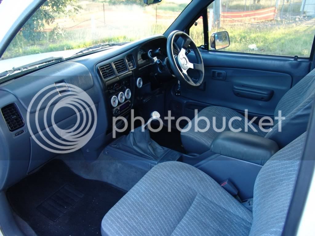

-Innovate G2 Analog Wideband Air/Fuel Ratio, Boost/Vaccum, Water Temperature & Oil Pressure Gauges
-Autometer Level 2 Digital Pro Shift Light
Engine:
-Standard Internals Import 1992 Soarer 1UZ-FE
-Harrop HTV1900 (Eaton TVS) Supercharger With 80mm Pulley 9.5psi
-Bullet High Flow Supercharger Manifold
-Modified Bullet Rear Supercharger Intake
-Qty 9 Bosch 968 42lb 440cc Injectors
-Walbro 255lph High Pressure Intank Fuel Pump
-Autronic SM4
-Twin 2.5" Exhaust With X-Pipe & Hi Flow Cats
-Custom Cermaic Coated Tri-Y Extractors
Driveline:
-Bullet Bellhousing
-Heavy Duty 10in Clutch
-Factory W56 Gearbox (W58 Soon To Be Fitted)
-Standard Hilux Diff Fitted With Torsen LSD & 3.7:1 Diff Gears
