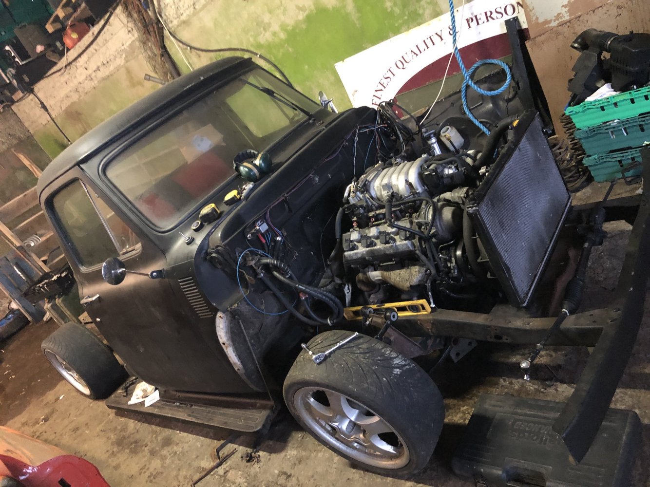

progress has been slow but ive managed to buy a lot of parts lol.the list includes
new front and rear brakes discs
front rear pad
all new suspension consumables inc rod ends,bushes and joints ,enough to fully rebuild the Irs/Ifs
full air set up built up,wired and pressure tested
all old f-100 suspension stripped from chassis
new chassis mounted booster/master cylinder fitted
Ls430 eng and box in and out for Ifs locating
new wiring loom built abroad to inc fly by wire throttle,cruise,autobox and immob delete.new fuse block added and redundant cabling removed

added a few pics in here
https://www.flickr.com/gp/zagamuffin/ToQ8w3
44727051040_8616c79c34_k.jpgIMG_0979 by rob virgo, on Flickr
