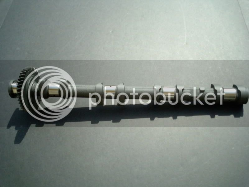

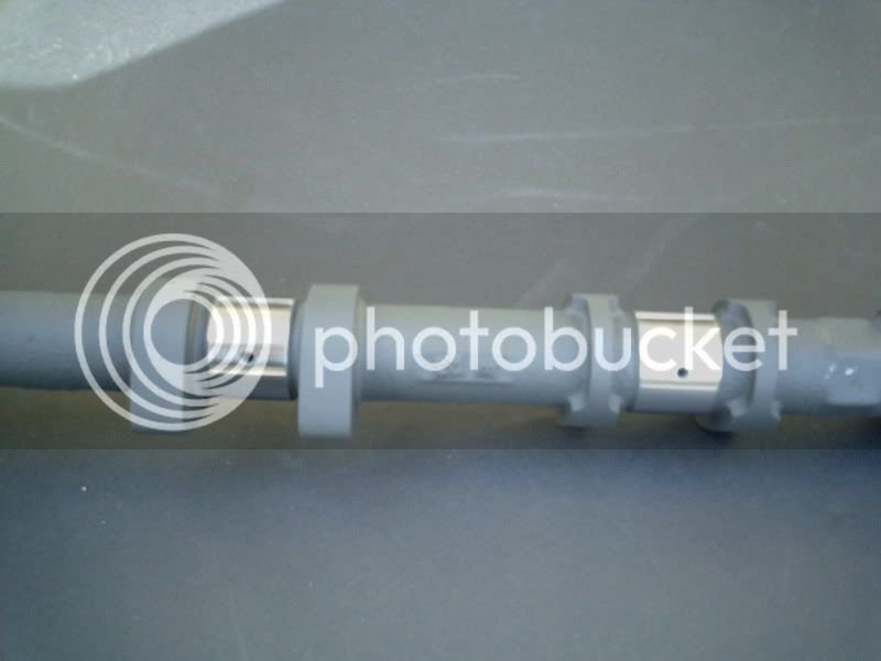

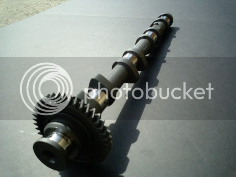

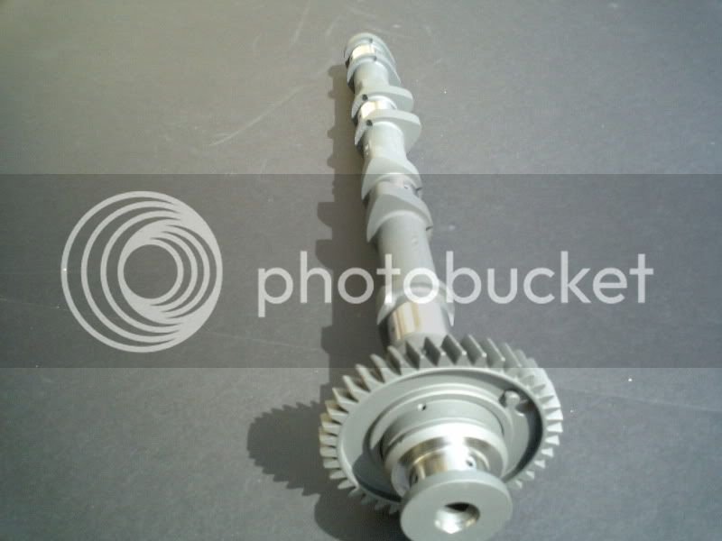

Wayne awesome Tundra will be the first to receive these hardwelded/ ground cams. Stay tuned for updates!
These particular cams are a 208, 208 @.050, and 354 lift.
Compare to stock 188, 194 @.050, and .314, .315 lift.
These are MUCH more aggressive. LOOK AT THAT QUALITY!

Eric,
Please correct me if I'm wrong but as I understand it these cams are welded and reground to the new profile.
If this is the case please change the name of the Thread.
Noted gents, and the thread has been brought into compliance. These are hardwelded cams, as there are no 2uz nodular iron billets in existence as of yet. Either way, these are not for sale through the Lextreme.com, and serve only as an example to what Wayne Ryther and others are doing for their 2uz-fe.

We don't want to sell any because i havent try or test them out yet. I don't like to sell parts just because the specs sound great but rather how the part or parts work with other parts as an unit or as a system. We are still figuring out the valve, spring, bucket, shim, pistons clearance other issues before anything is solid. Hardweld and regrinding is just part of it, but how it work as a system is another story. Secondly, you should not disclose your customer first and last name. I think privacy is violated here too. By the way, how much power would these cams will gain? It would be nice if we can see some real numbers before someone putting out $2K for those cams.
The average USA cost for a person to walk into a machine shop with a single set of cams to regrind is $200-250usd a cam. So the average 4 cam is looking at around $800-1300usd by the time they do cams & if they do springs/shims/bucket conversions etc.
The lobes have been parkerized like any other cam.
It looks good to me. I mean, what is there to screw up when you are having a machinist make a cam? It all comes down to how good he is VS his understanding of the engine.
A dyno would be nice. If running back to back is out of the question, just a generic after dyno would be well enough. *with the admittance of if there is, or is not any management tuning*
Just to show off the basic change of the powerband curves.
Wayne has made it public knowledge in another thread that these are his cams.
