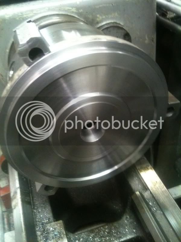

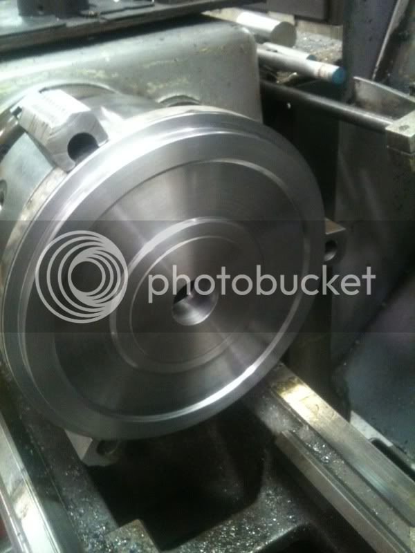

I present to you my billet steel flywheel.
and yes, it's not quite finished, but I think you get the idea

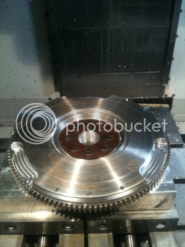

Well done! Now the inevitable string of questions:
1) Is your ring gear machined from the same billet, or is it a separate ring gear, shrunk on? Is it hardened in any way? If not, it might be a good idea to have it hardened somehow.
2) How much friction surface will the flywheel have, and/or which clutches will work?
3) What will it weigh?
4) And, of course, how much will it cost, and what's the time to delivery?
The ring gear is a OEM off the shelf item. It appears to be forged then machined.
It's shrunk on and tack welded minimally.
This flywheel is setup to use the standard Rxx and Wxx series transmission clutch discs.
friction area outside diameter is 9.5"
so far weight is 24 Lbs, Which isn't wonderfull, but it's not bad either.
cost (just a off the hip guestimate) should be around 4-500$ I'm trying really really hard to keep the costs down.

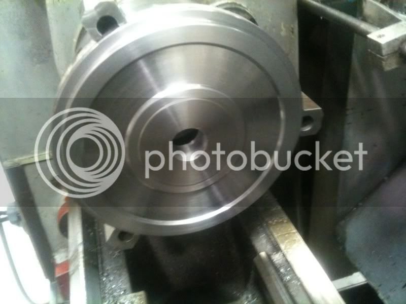

I got the flywheel down to 17 Lbs last night. phew....

I indicated the flywheel back onto the lathe and turned 7 Lbs. off the backside, I could have turned more off but I wanted to leave a good strong base to accept large powerloads. Plus I think I'll be able to shave a couple or few more pounds off when I do the millwork. So, 15Lbs is definately do-able.

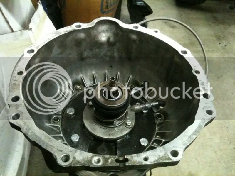

and for my hyd. throwout I have a real solid setup that works with several different flywheel and presure plate combinations.

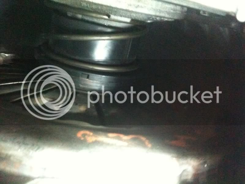

Utilizing the GM Hyfraulic throwout bearing! Which works a million times better than any of the howe/quartermaster for these transmission swaps. Plus you can buy a dorman unit from rock auto for about 80$ shipped. Only drawback is that it would be nice to have a bigger clutch master cylinder for obvious reasons. But the clutch pedal isn't horrible with the stock one. It's Just not perfect.
we actually cut out the bottom of a 1uz bellhousing to make sure this hydraulic throwout bearing setup worked absolutely perfect.

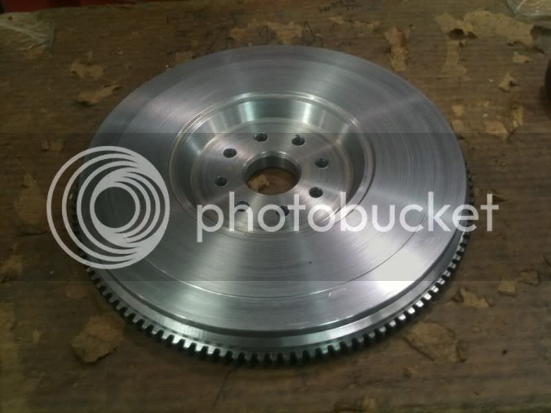

little bit of an update. I made another flywheel and managed to get the weight down to 15 Lbs. I'm pretty sure this is going to be the final weight.
the sig is my sire, and the flywheel design is currently being road tested.
off the hip price estimate is between 450.00$ ±100.00$
