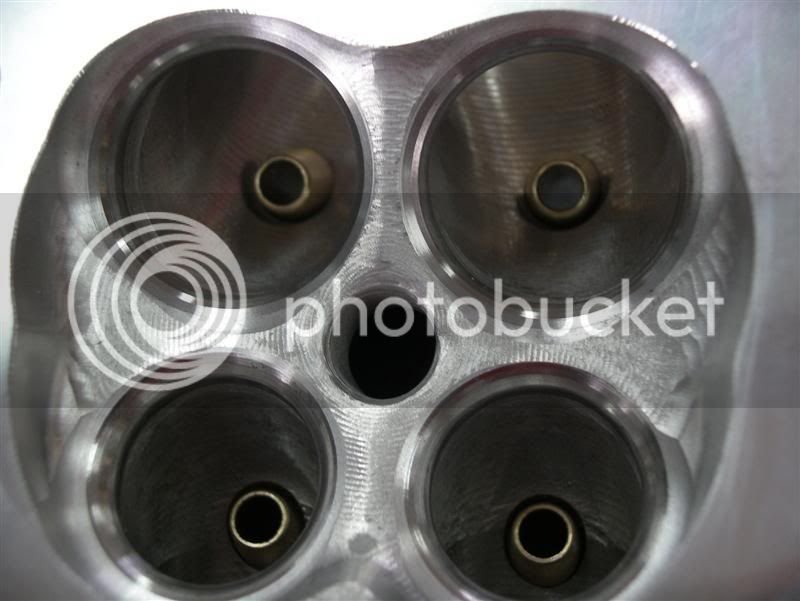

$3600 AU ...
Plus any facing, oversize valves etc..
I inquired other places like Kelford,Kostecki etc
These are good value..
Repeatable port & chambers produce repeatable power and torque curves.
If I was starting agaain I would jump at them at that price.

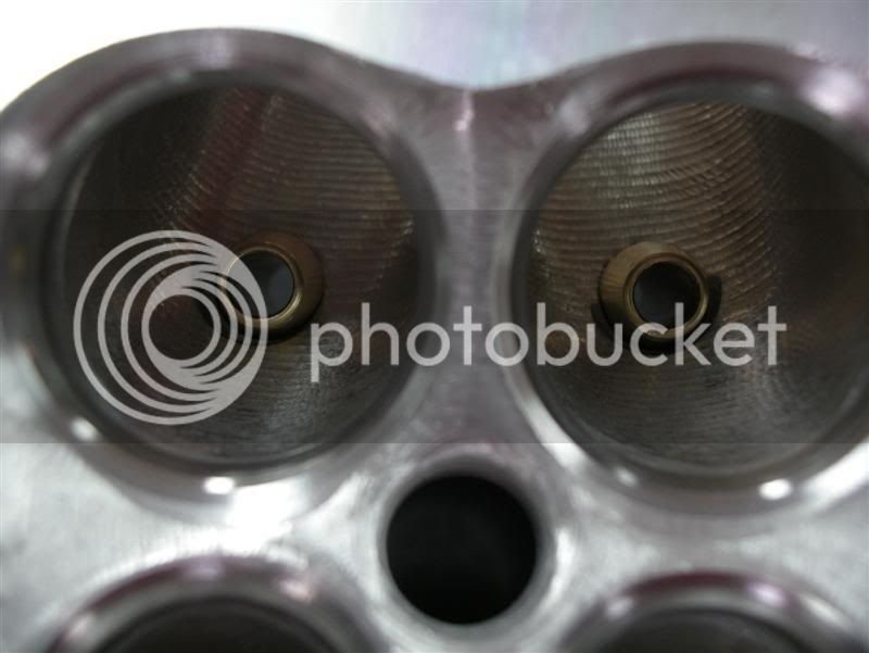

I guess I have twice that invested in my heads and I know each port is an individual, hence flows different amounts of air.
I would have been tempted to do away with the excess valve guide length and the flat area around the exhaust valve's guide.
Me too....
