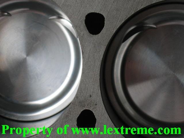

Here is a close up picture of 2uzfe block. Imagine inserting sleeves then you don't have much meat left to support the sleeves. Secondly, looks like the water jackets will also be alter too. So I really don't think the 1uzfe or 3uzfe block would work with 3.700" sleeves (2UZFE bore).
you are only talking about .06" larger around the bore. That isn't all that much, but I guess it could be. Would have to see how thick the supporting walls are at the bottom of the bore.
