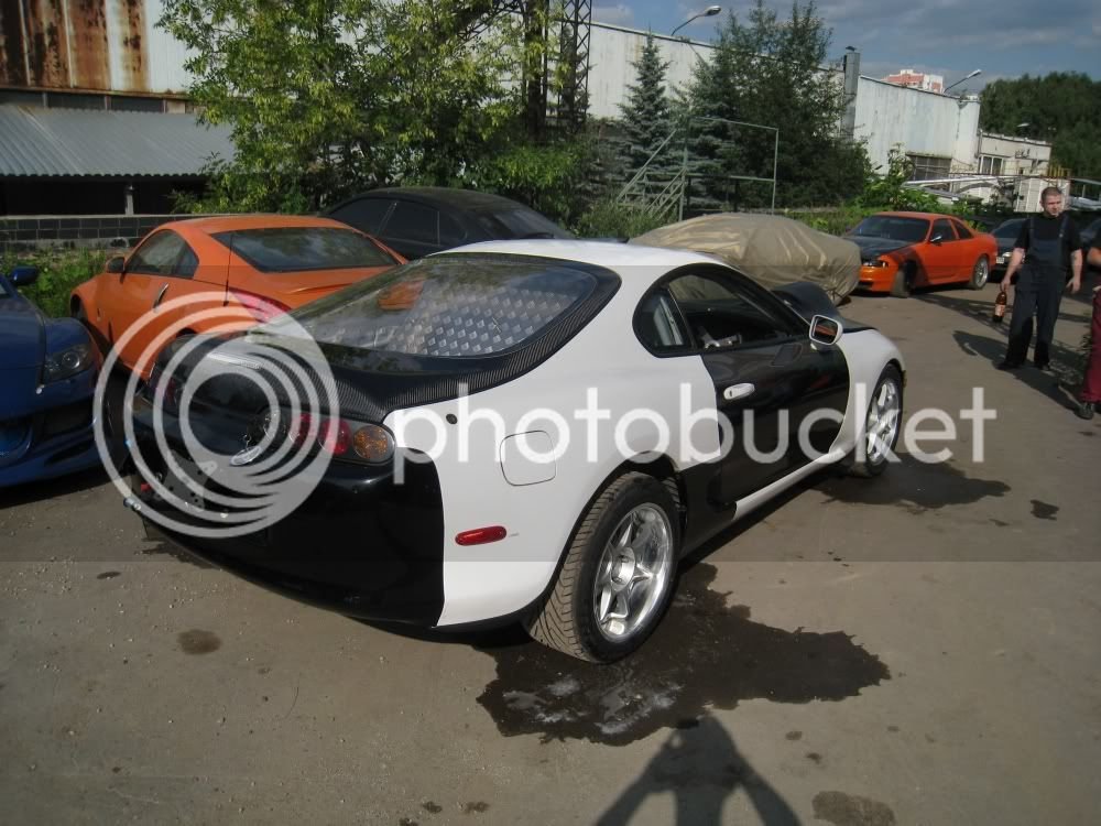

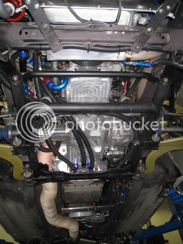

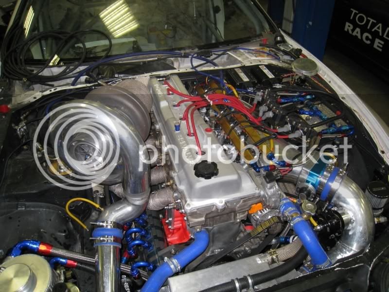

Bored last night scanning forums and cam across this 1-off AWD supra, that was based on an SC400 first. The turbo is obscene but well worth it. No 2jz in here either... 1FZFE 4.5L from a Landcruiser running CNP's and full dry sump. What do you all think? Seems like a good effort towards AWD awhp record?

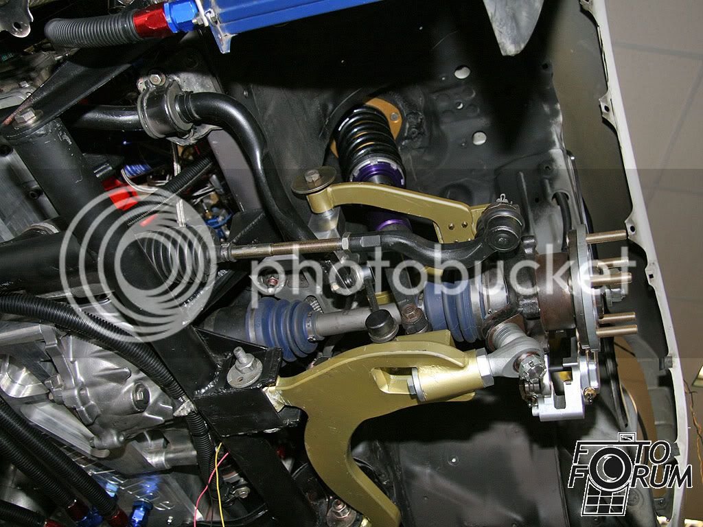

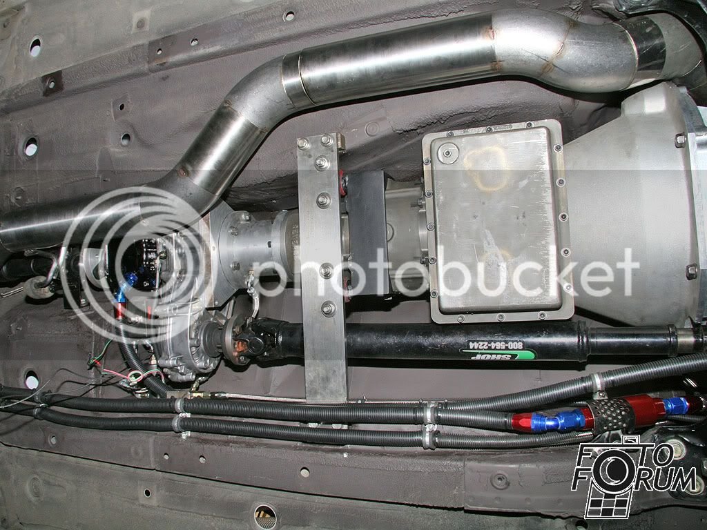

At first glance it looks like they are using a BMW center diff + BMW front diff and drive shafts on a custom ( CNC'd ) sump.

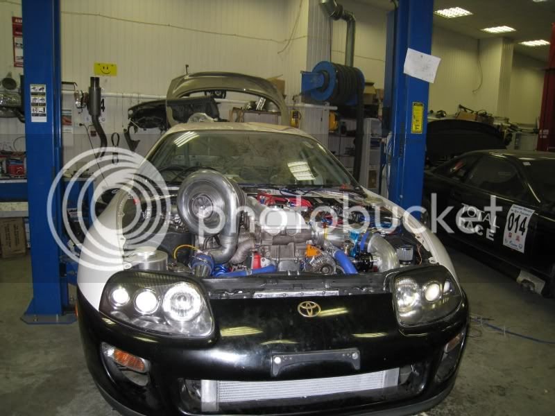

Wonder if they didn't find a smaller turbo...
Wow, lot more going on there than one would suspect.
I would have tried different turbo packaging including a smaller diameter compressor with a front, mid, low or rear mount option and or twins.

Im absolutely convinced they could have found a larger turbo.

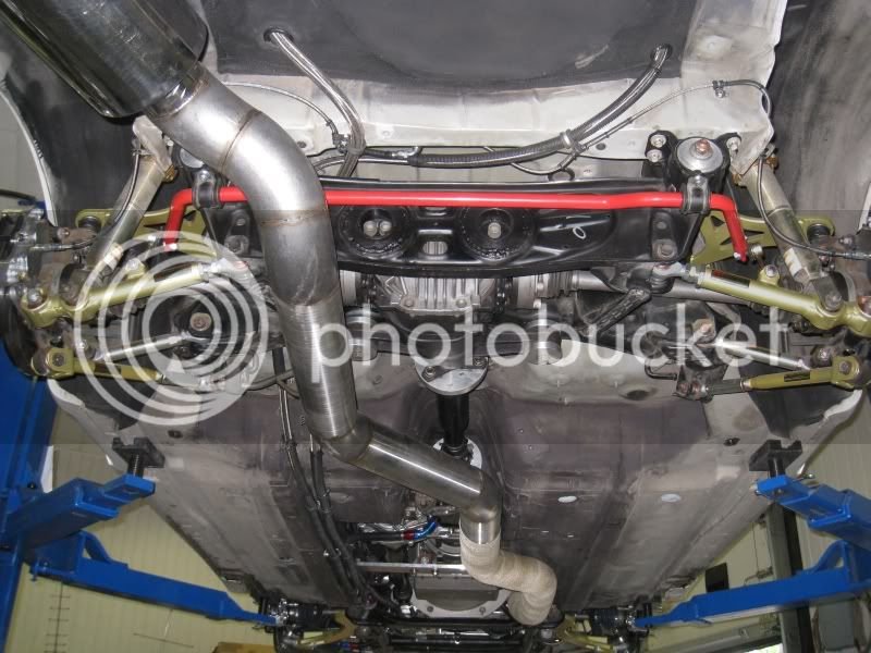

that one is TINY!!! not allot of the original subframe's left in there.

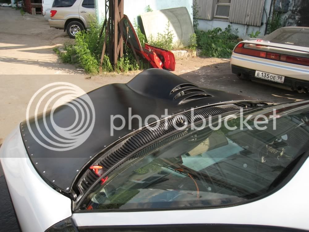

I like the custom work but the car looks bad with that big turbo outside the hood and all together I really ask why would you do this?

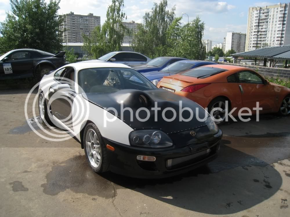

This wan't a cosmetic chime-in but as you can tell in the 1st pic the supra is rocking a chute... not very street oriented. It's a drag monster, AWD for instant hookup and a large displacement 4.5L I-6 to overcome the lack or torque on a standard stroker 3.4. When I see funny cars I don't assume it needs to look "streamlined" and "cool" it's all about performance and cosmetics take a back seat every time. Frankly i'm shocked to even see a hood, the top of the valve cover w/o the massive Borg Warner still hits the hood. When your building something of this magnitide it's based on a single purpose... to go fast in a straight line, not for crowd attention, but IMO it's already done that :)

ten points for originality and build quality (suspension - wow)... but i dont get the reasons for some parts of that build... That engine plus the front driveline would have made that supra pretty nose heavy, it will already be more inclined to understeer with awd, plus more weight forward... i'd doubt its any quicker around a track than a well set up rwd supra with similar power... Also I dont think the turbo is actually as big as it looks either, huge housings tho, especially compressor - why?
If its just intended to break an awd drag record i kinda get it tho - those FZ engines sure can make power
