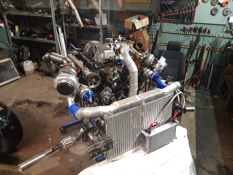

Alek22

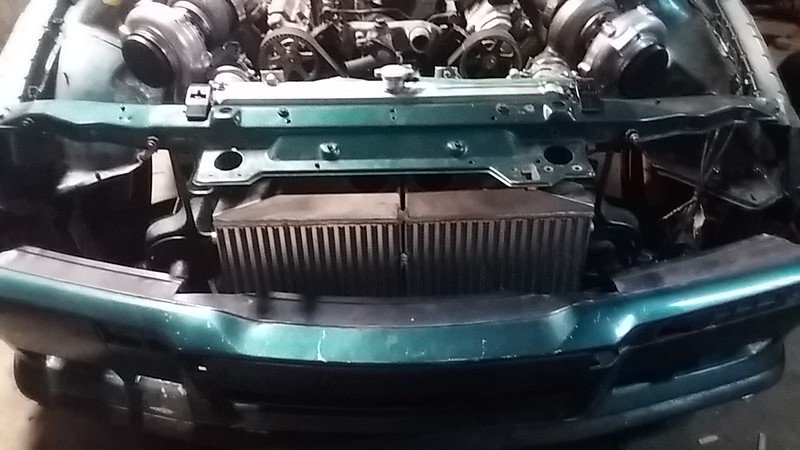

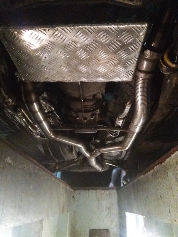

Hi after a long break, E36 changed the face (new engine) definitely, came up with Japanese v8 TOYOTA 1UZFE
After finishing many turbo engines (inline six turbo BMW 700hp + ) : D , came up with the idea for a twin turbo v8, of course the plan was that it would take a max of 4-5 months and the car rides.
But as usual, it collided with reality and I built the car for almost 11 months ps. only in the evenings![Smile :) :)](https://cdn.jsdelivr.net/joypixels/assets/8.0/png/unicode/64/1f642.png)
This is my first v8 twin turbo, took a long time to make custom parts that had to be invented and put in places to manage to fit everything.
The mask can closes: D
The car gives the NM feast feeling, now boost is 1.5bar (22psi) on E85 I will go to dyno after camshafts grinding and change valve spring ( more revs yeeeaa. )
SPEC CARS:
Engine:

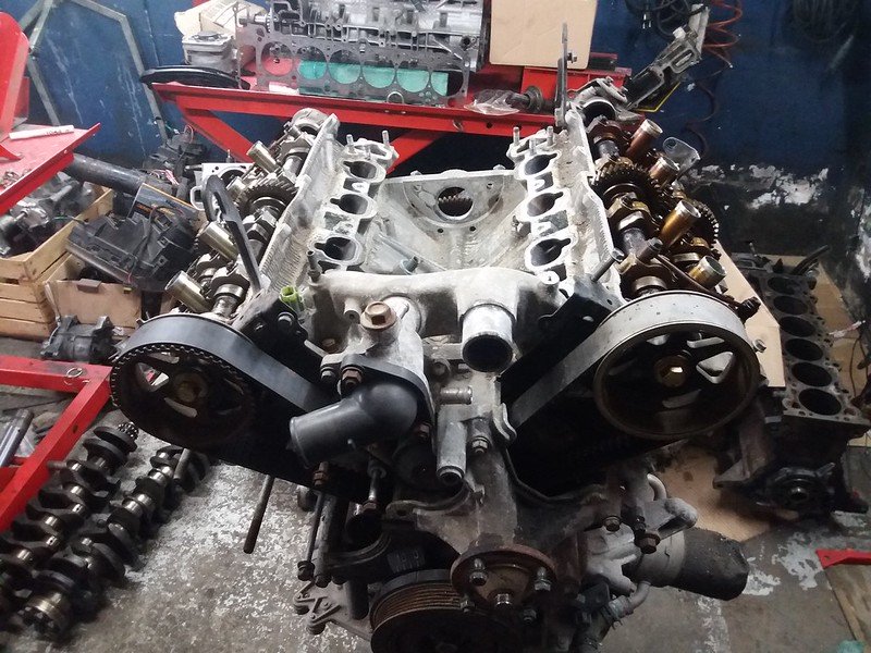

- Toyota 1UZ FE V8 4.0 engine
- Cometic steel head gaskets
- Valve seats milled to three angles / ground valves
- ACl bearings
- M12 head bolts 12.9

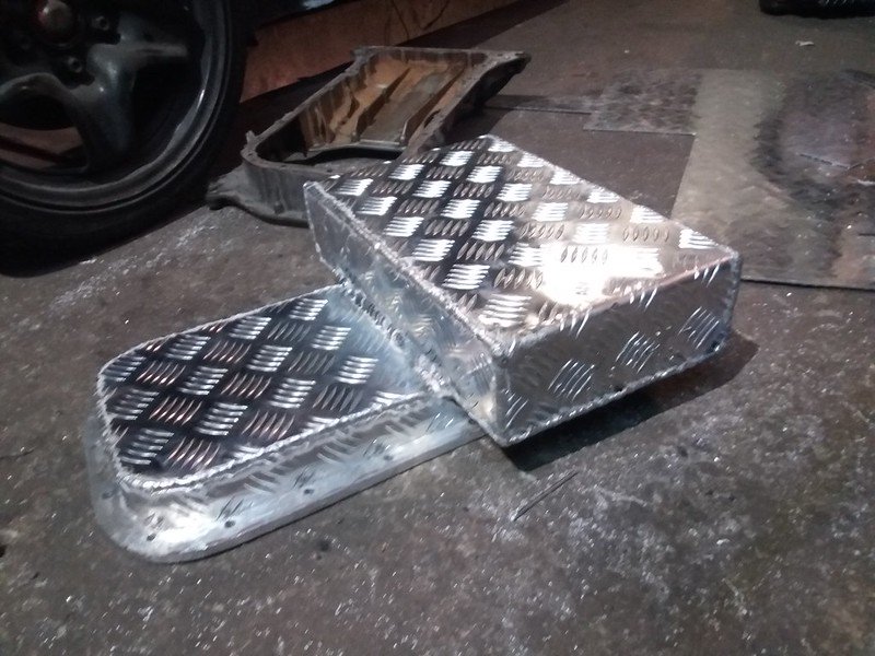

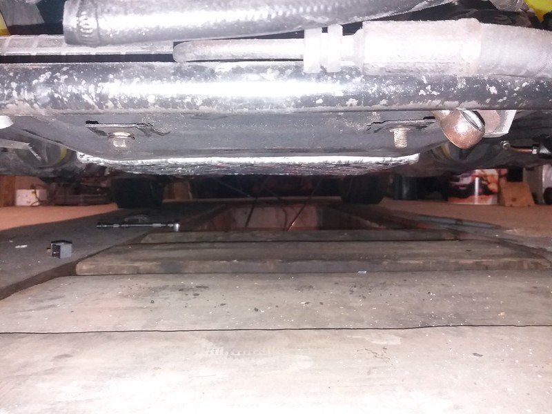

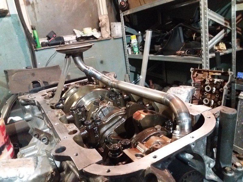

- Oil pan custom by Alek

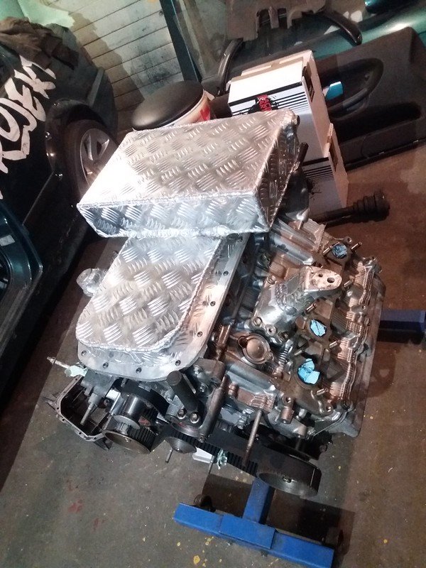

- Engine mounts by Alek

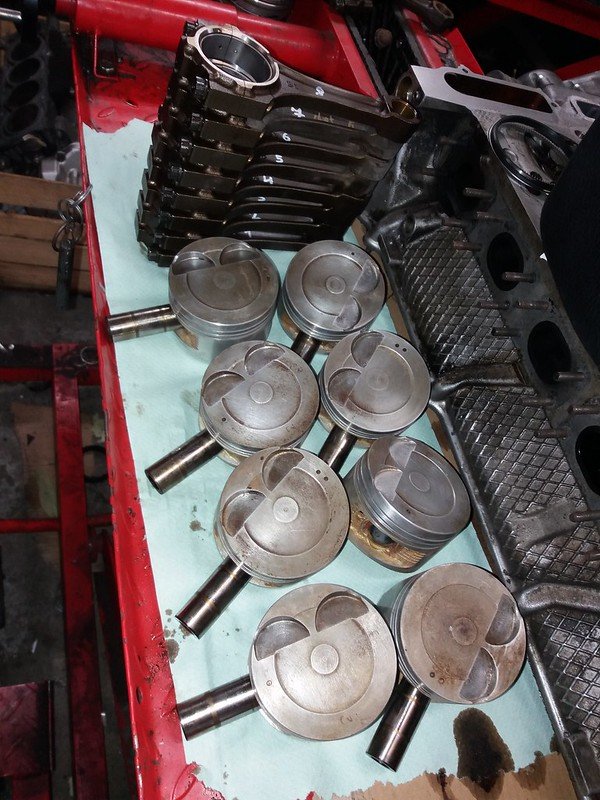

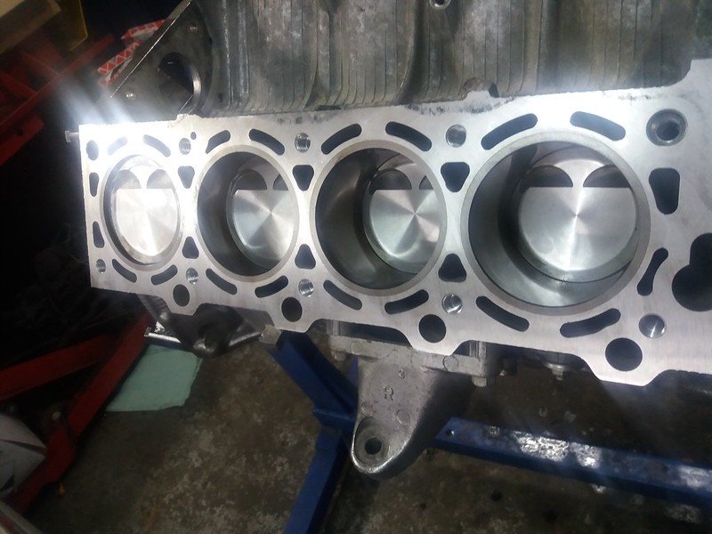

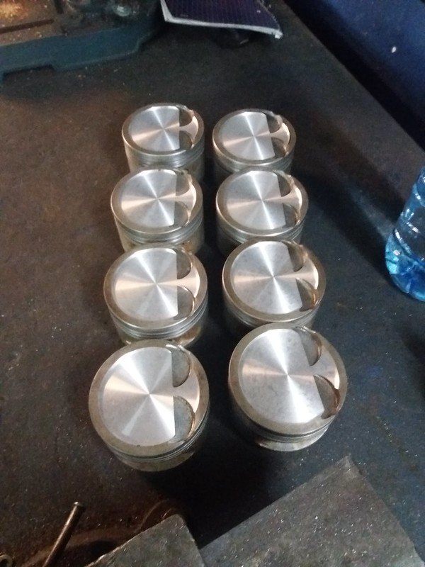

- Milled oem piston bowls to reduce compression 9;0 : 1
Turbo / Intake

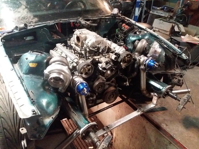

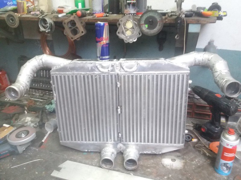

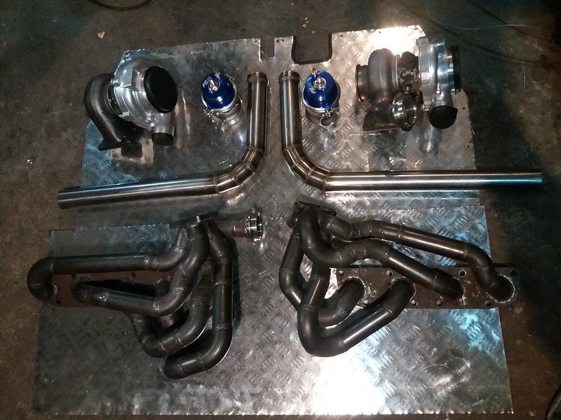

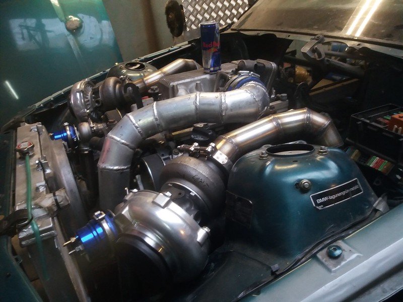

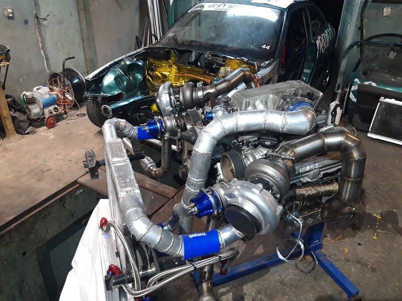

- 2x Turboworks GT30 58mm ar0.63
- Intercooler Custom By Alek

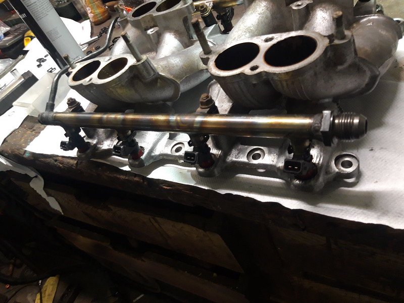

- OEM intake manifold converted for electronic body vdo with bmw v8 m62b44

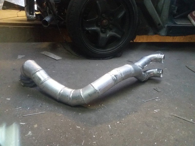

- Intake 2x60m to ic / 76mm to the throtle body

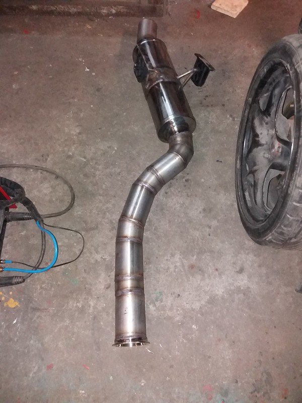

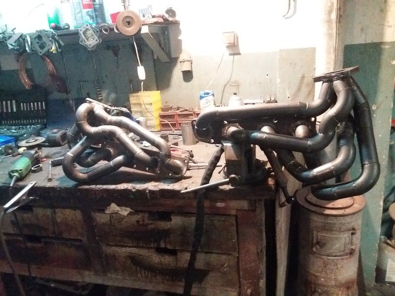

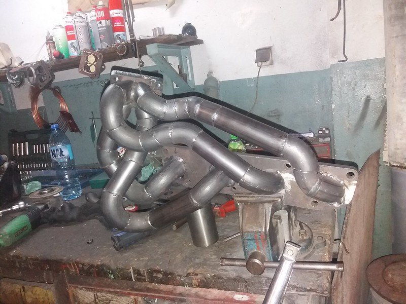

- Custom By Alek exhaust manifolds
- 2x WG 60mm
- 2x scream pipe 50mm

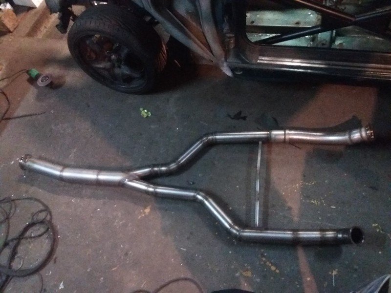

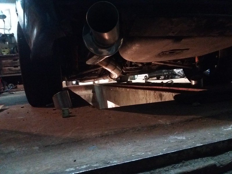

- Exhaust 2x2.75 inches is 3.5 inches
- Bov 44mm
Fuel
- 3x 044 pumps

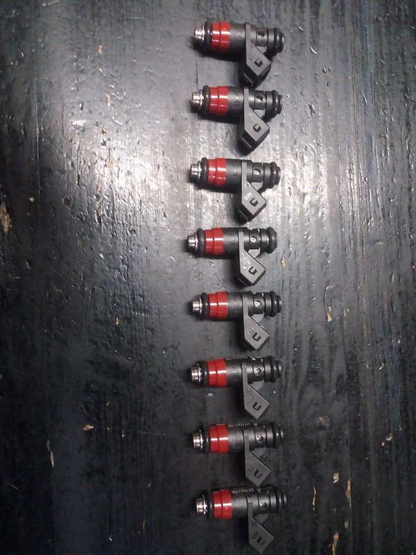

- 8x deka 875 short injections

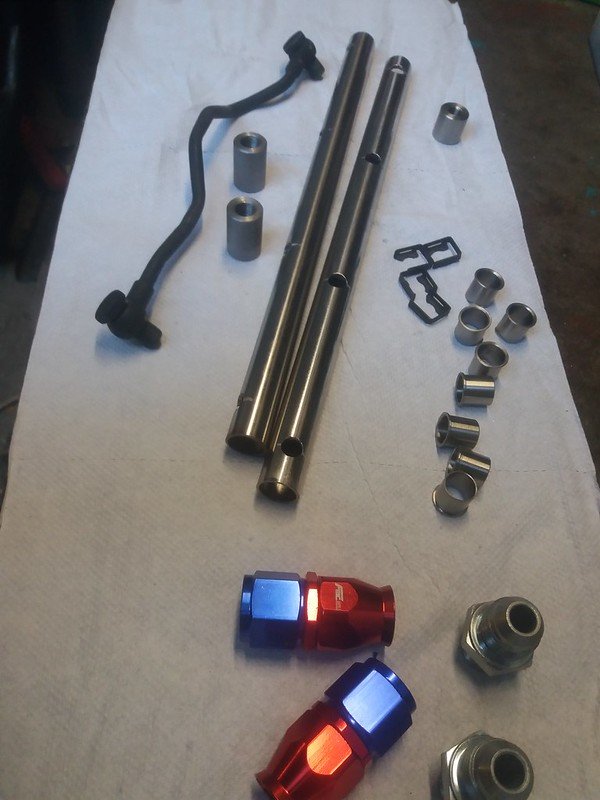

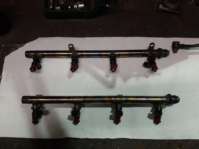

- 2x custom 20mm fuel rails by Alek
- AN10 teflon feed
- ALU 50l fuel tank plus 2.5l swirl pot
Drive

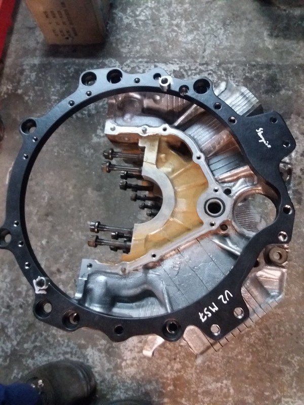

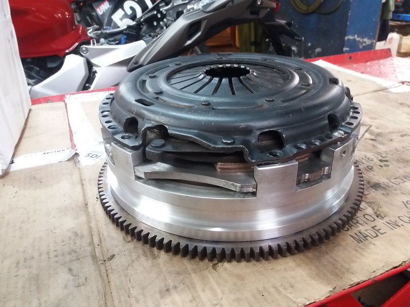

- Sintered double disc clutch on Alu flywheel from Poweride Dt and downforce from VW TDI
- 5b gearbox from mw m57b30
- E36 2.8 shaft shortened
- diff. 2.56 tds
Hinge / steering

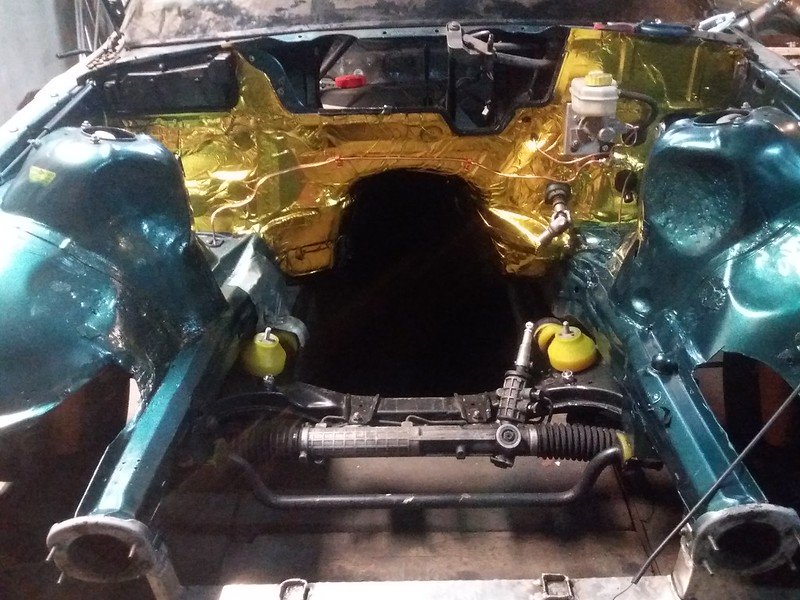

- Moved steering column
- Electric power steering pump Opel / steering gear oem Bmw e36
- Extension arms / custom front hubs / custom steering rods
- Hinge front travel xyz / rear Horses with adjustment
- All rubbers changed to polyurethane and alu
Electronics / Control

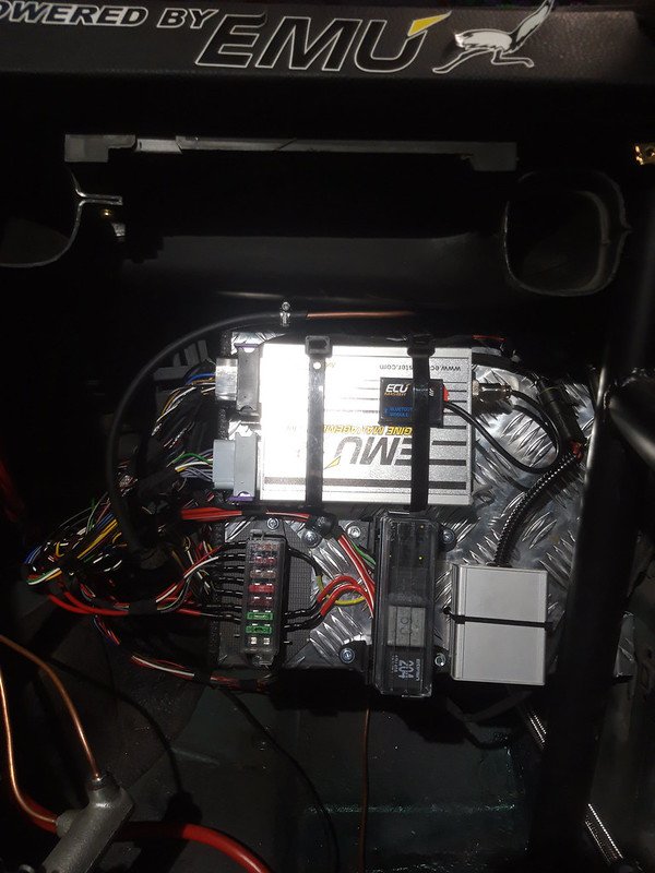

- Ecu Ecumaster Emu silver tuning by Alek
- Coils Denso / Honda K20
- Electronic throttle body
- oem triggers with 1uzfe![Smile :) :)](https://cdn.jsdelivr.net/joypixels/assets/8.0/png/unicode/64/1f642.png)
Interior

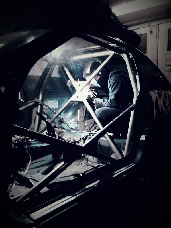

- Cage with attachment J. from Ireco, self assembly kit
- Oem E36 dashboard work
- Tablet configured with Emu
- Mirco racing seats
- Main power switch
- Panel (switches: ALS / LAUNCH / MAP / FUEL / CONTROL AREA)
Video from the second training
1.5Bar
And some photos of the car and the construction:
