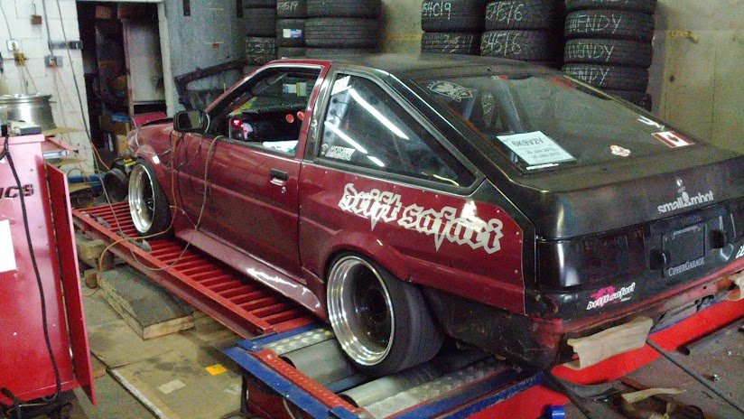

It has been a long damn time since I have posted here, so here goes. After killing my last built sr20 at Seattle FD 2011, I said I was done with sr20's. The last one was caused by a broken fuel pump. Stupid causes are always the most painful.
So I bought this:
A 1998 GS400 VVTI 1uzfe.
Put a w58, Aluminum flywheel, ACT 6 puck clutch, custom exhaust, Haltech Platinum Sport 1000, and way too much time into this car.
I had a baby girl come into my life last Sept, so the build process was slow. But no big deal, I kept on trucking.
Here are some of the pics of the build:

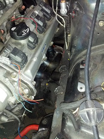

Headers:

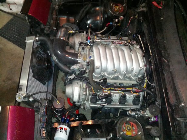

exhaust
wiring started, also a shot of the modified cruise control to bypass drive by wire

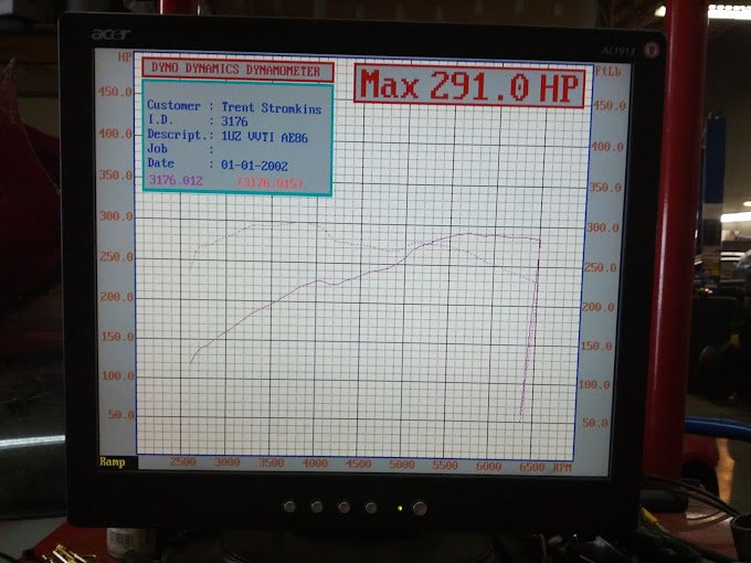

and then a video of how is sounds. The car has not been on the dyno for tuning yet, so the numbers and drivability are still unknown, but it feels torque happy. The subframe was not dropped, the tranny tunnel was just pounded a bit more then for the SR. Fun.
https://vimeo.com/51039191
Since that video, we did some street tuning, and man this car is stupid fast now. Next season will be a blast.
-Trent
