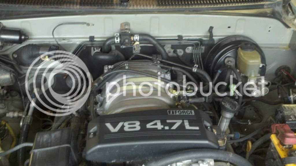

99 4runner 2UZ-FE conversion
sweet .. im going to running 40's with a 1uz im afraid its going to be gutless in high.. i have dual cases with 4.7 cases in the back..
but just stock axle gears. do you know the hp and torque specs of a 2uz vs a 1uz non vvti?
2UZ has 245 horsepower 315 ft/lb torque.
However the pre 98 1uzfe is rated at 250 bhp with 260 tq
I want to say that the two engines have similar horsepower ratings but the the 2UZ has 60 more ft/lb of torque.
The 1UZ is cammed to run higher rpms thus the more HP. I believe that in our situation, we need low end power, to climb over obstacles which the 2UZ is great for.
The 1uz has high compression pistons and needs premium or super gas
while the 2uz will run on regular.
1uz has an aluminum block while the 2uz is cast iron. I believe that it weighs 82 lbs more.
hey thanks for the info.. im used to no torque at all so the 1uz will be plenty for me.. plus i have crazy low gears behind it.
the extra torque of the 2 uz would be sweet though! .

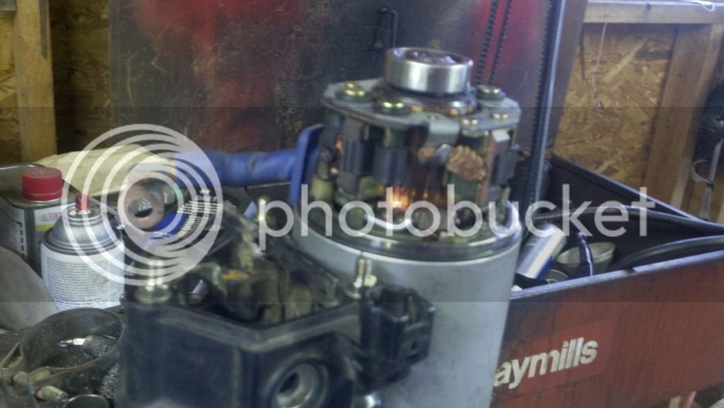

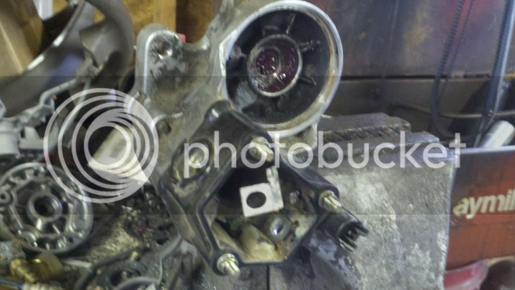

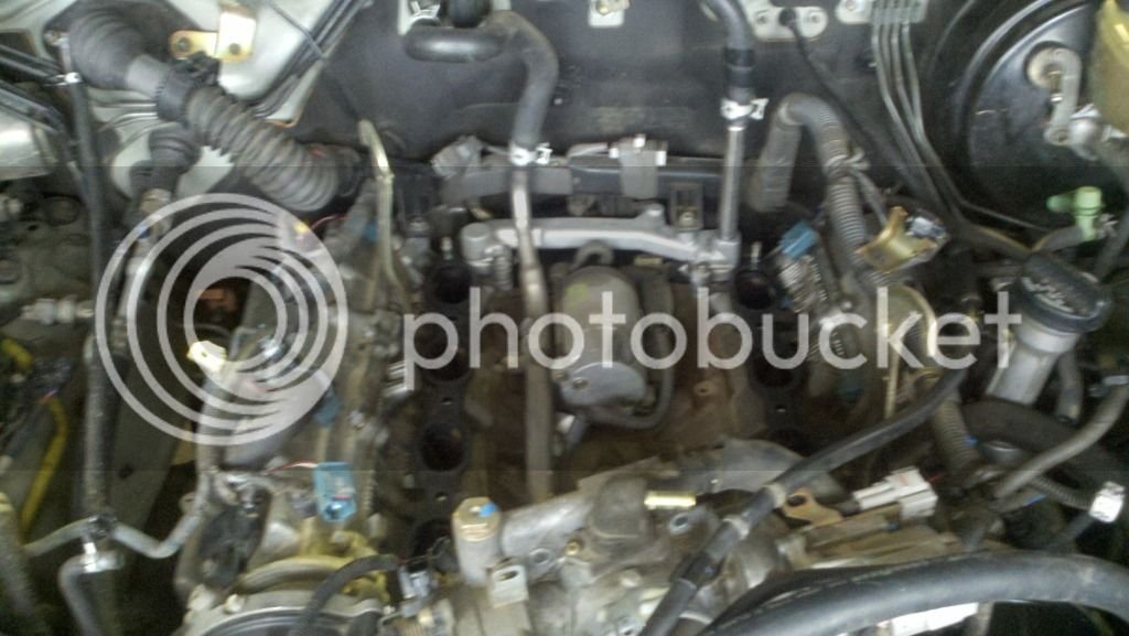

Aparently the last time I took the Ltd swimming. I must have submerged the starter.
But you know what? The snorkel works.

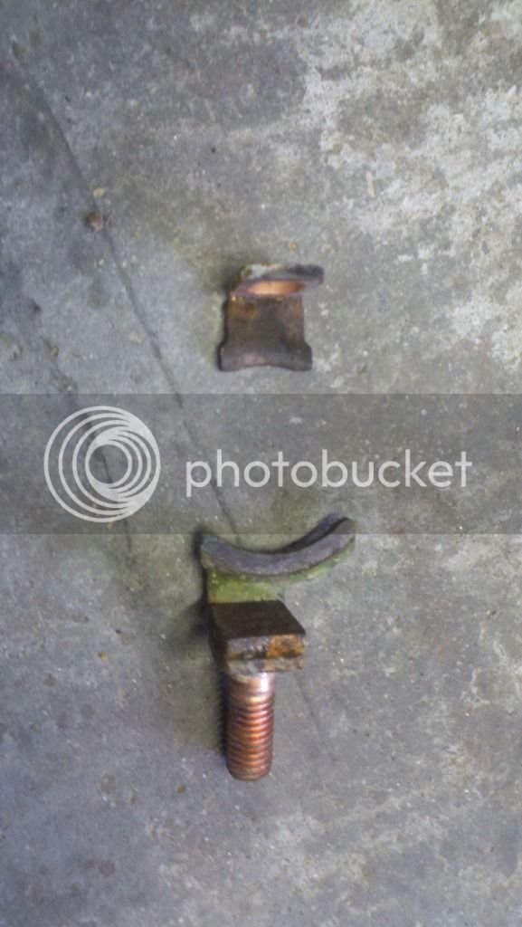

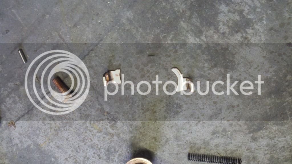

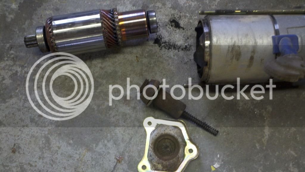

The stater was getting worse and worse to start up. first it was 2 second delay from the time a turn the switch till the time the starter works till eventually , it took a minute for it to work.
Starter contacts went out.

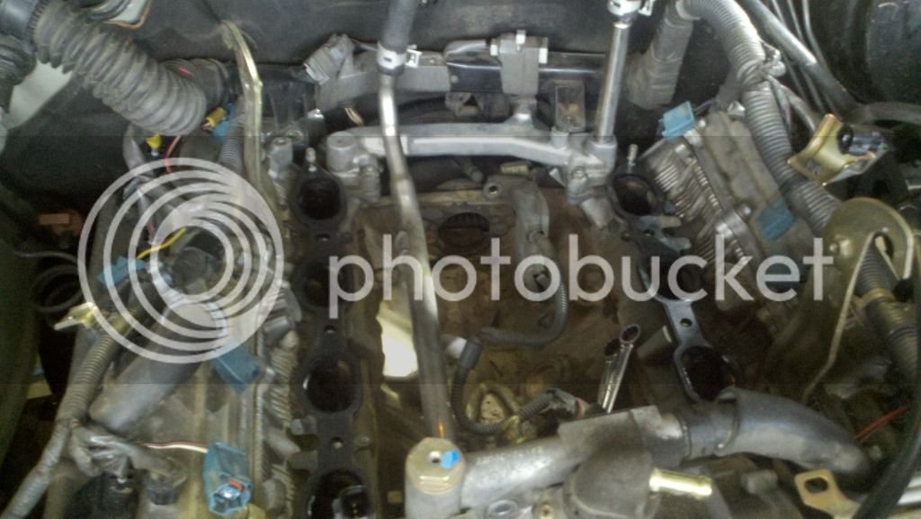

Here is the whole issue. The starter is a pain in the arse to get to in my V8 Swap. I was cursing like a sailor.
He are some photos.
Start
remove the intake manifold
See the starter.
Starter gone

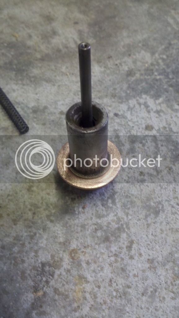

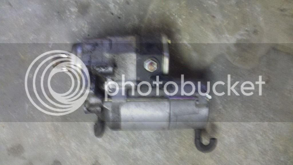

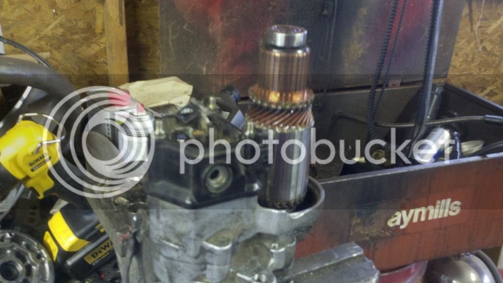

Starter
Breaking it down.
Pretty fffed up.
Sanded all the carbon off.
Pretty FFFed Up.
Sanded Down
Greased up the rather dry bearings
brushes and armature look great . Only 80k miles.
re-installed
Took me 3 hours to do it. Sucks!
