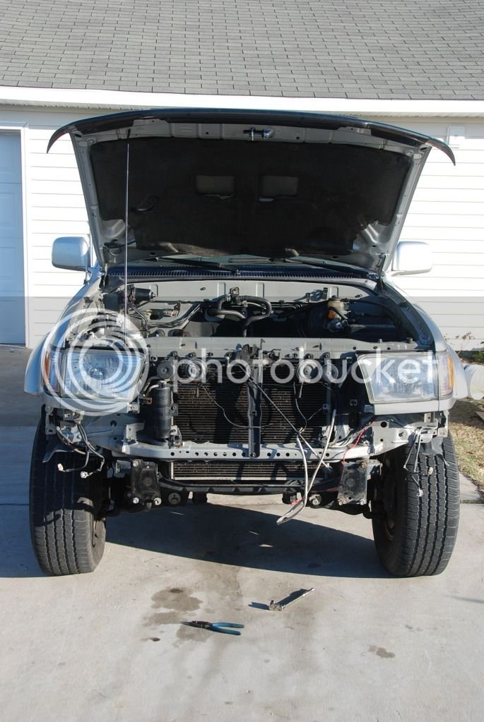

Removed the front bumper

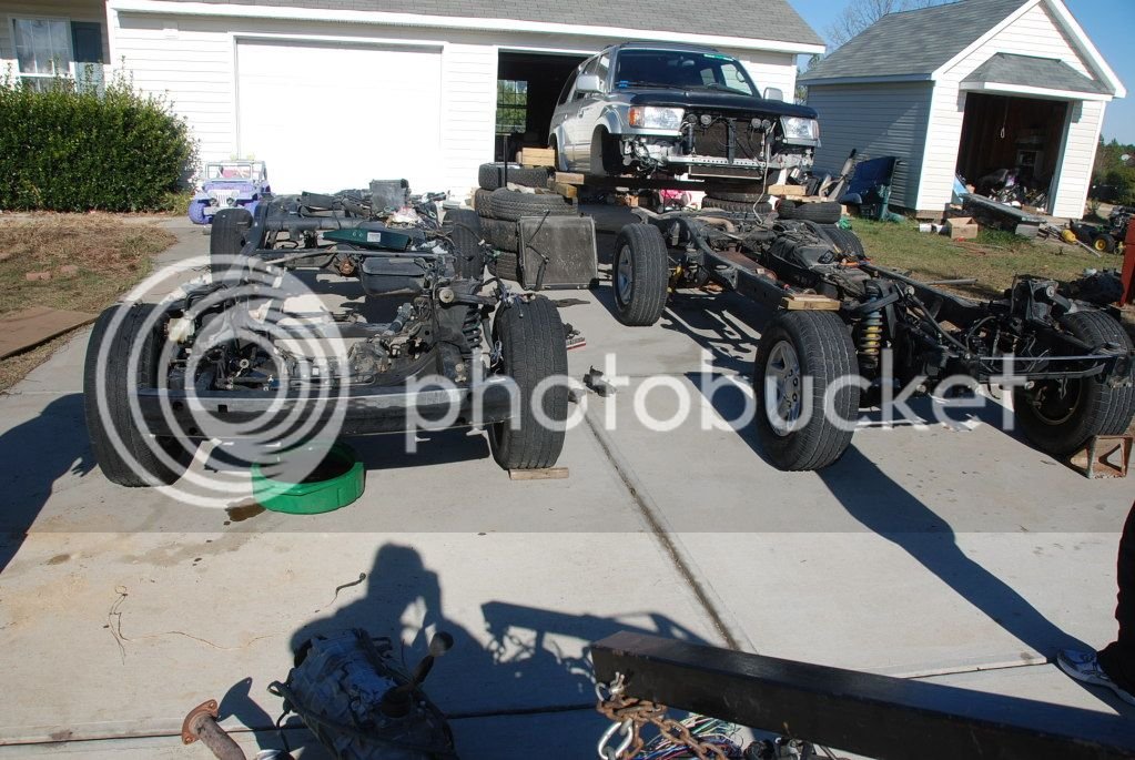

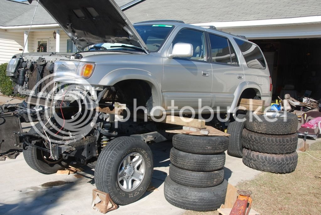

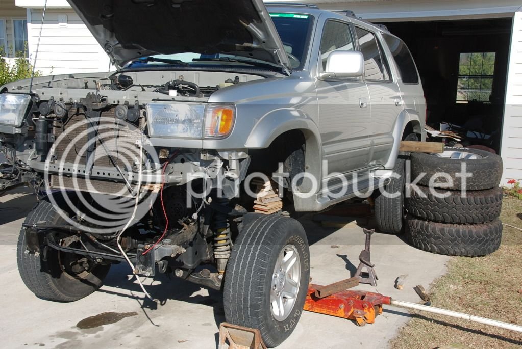

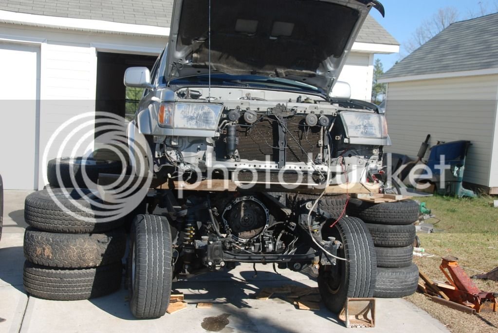

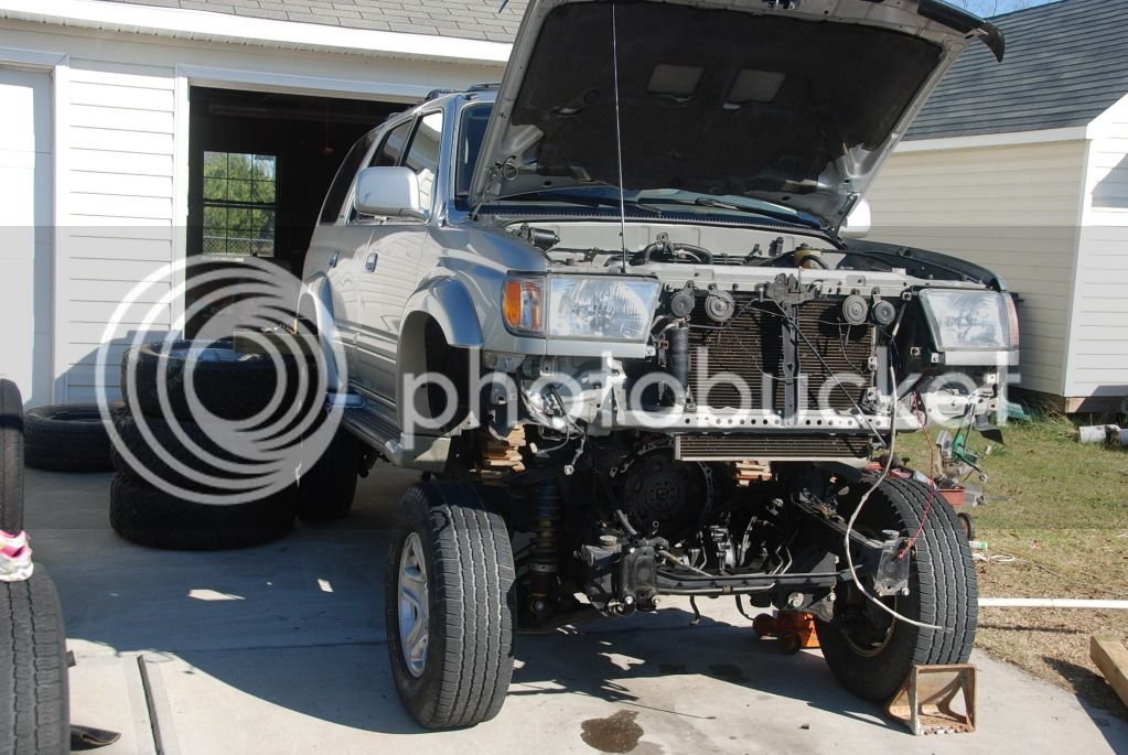

Starting to lift the body off. Inches at a time though.

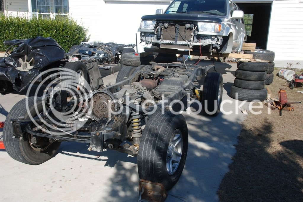

Getting ready to roll the chassis out from under the body.
It is separated

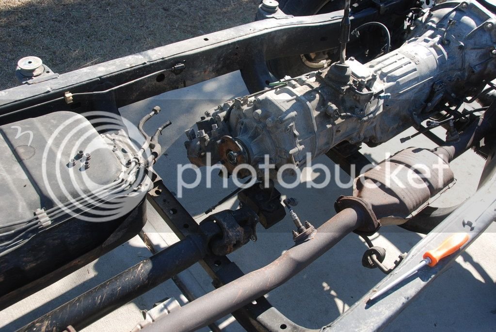

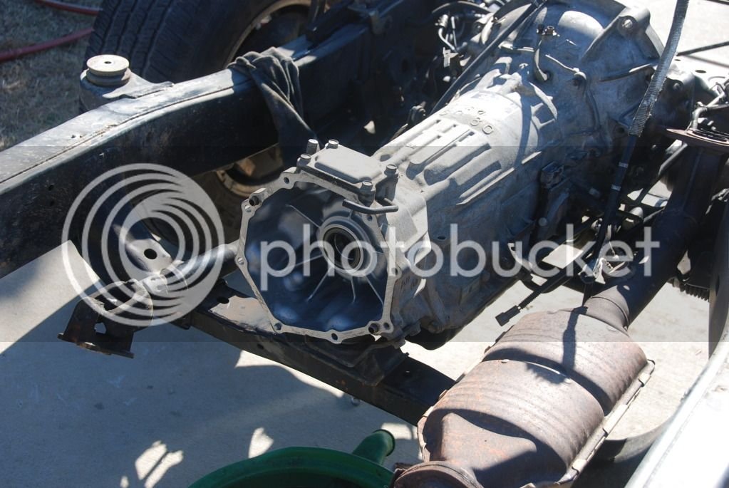

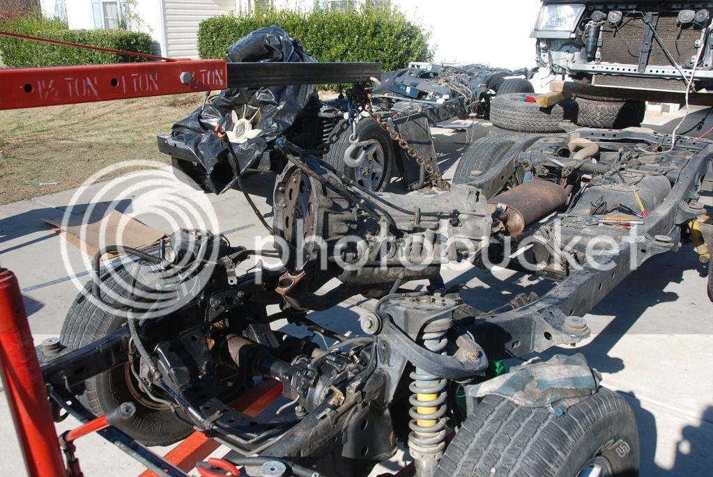

Preparing to remove the Transfer case
transfer case is gone

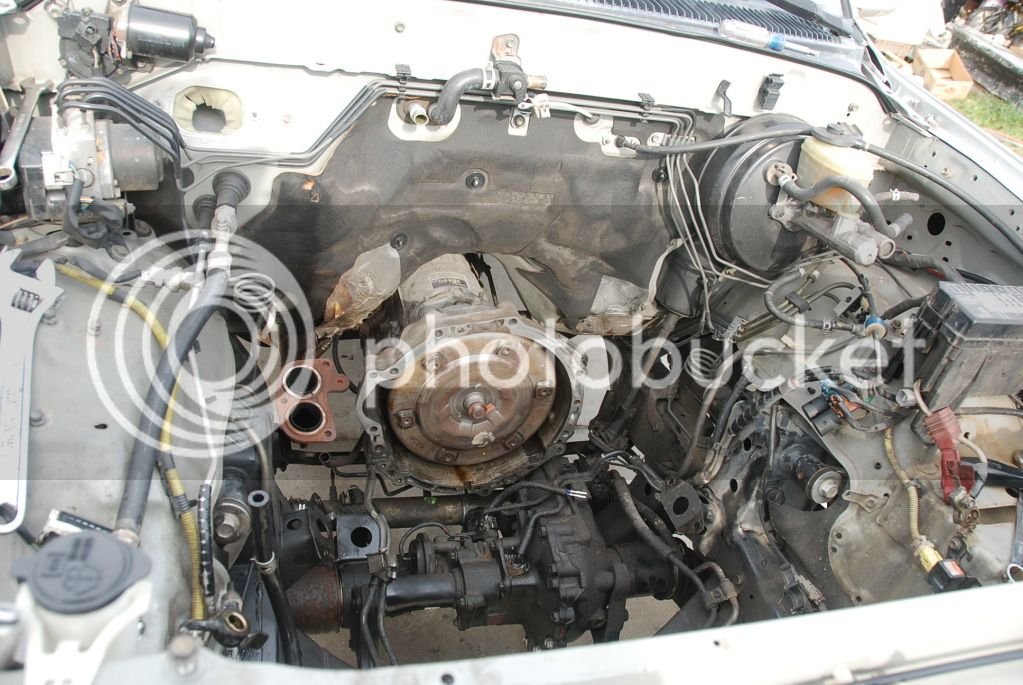

Removing the 5v trans

The tranny's are the same between the two. The 2UZ transfer case is more push button while the 4runner is more mechanical.

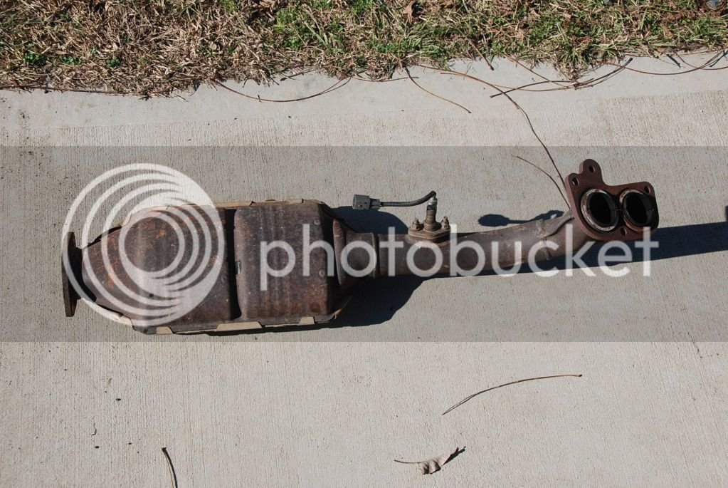

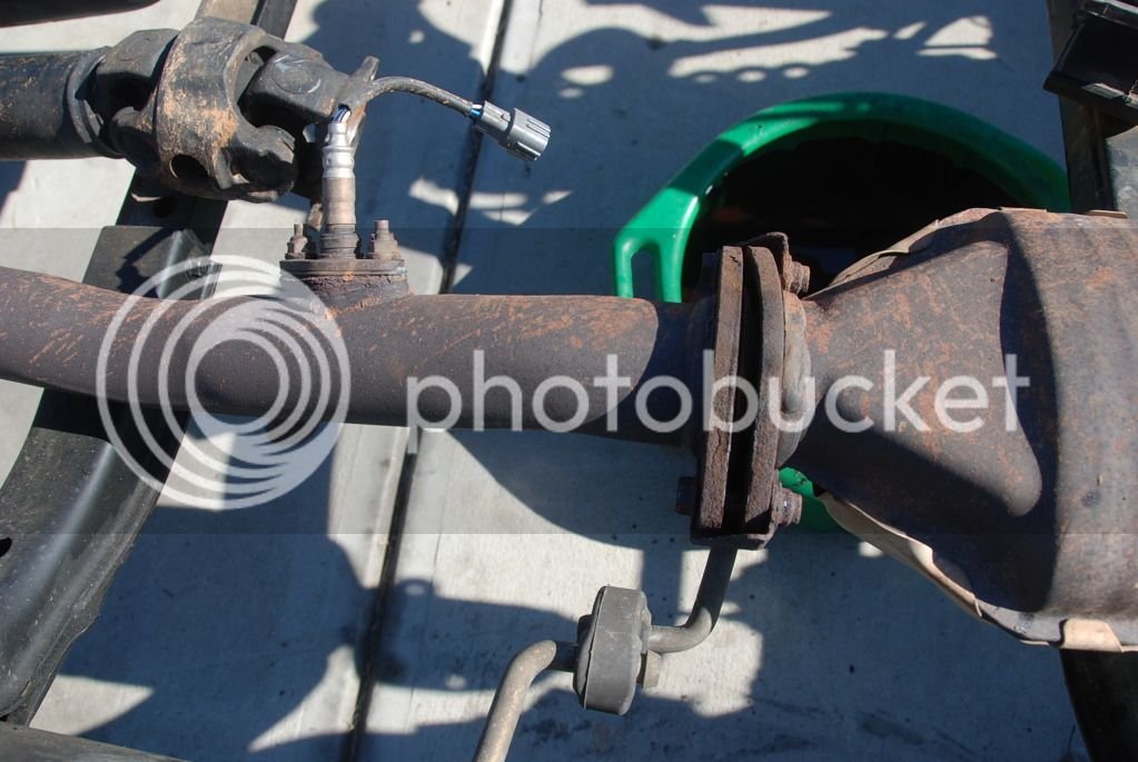

Removing the old cat. I love working on southern trucks. no corroded bolts look at o2 sensor.
Anybody need a Cat and A/F sensor?
Frame ready for transplant.

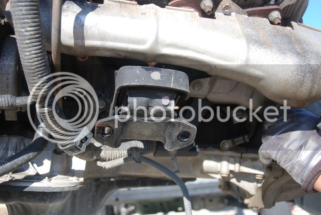

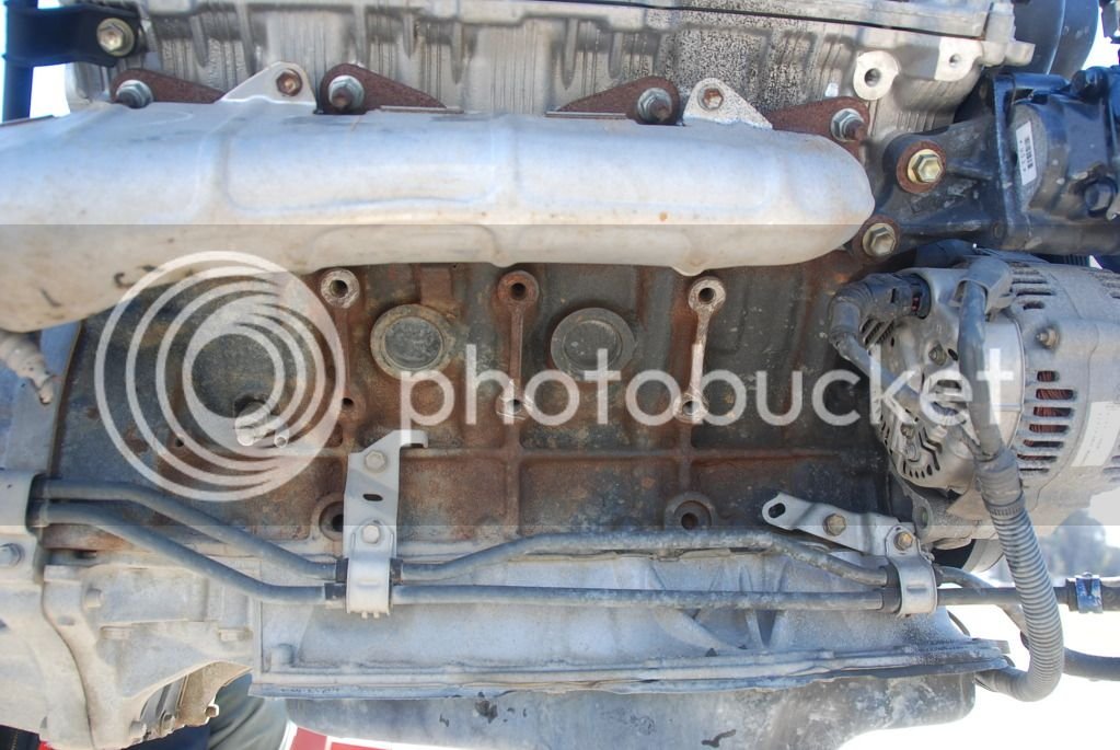

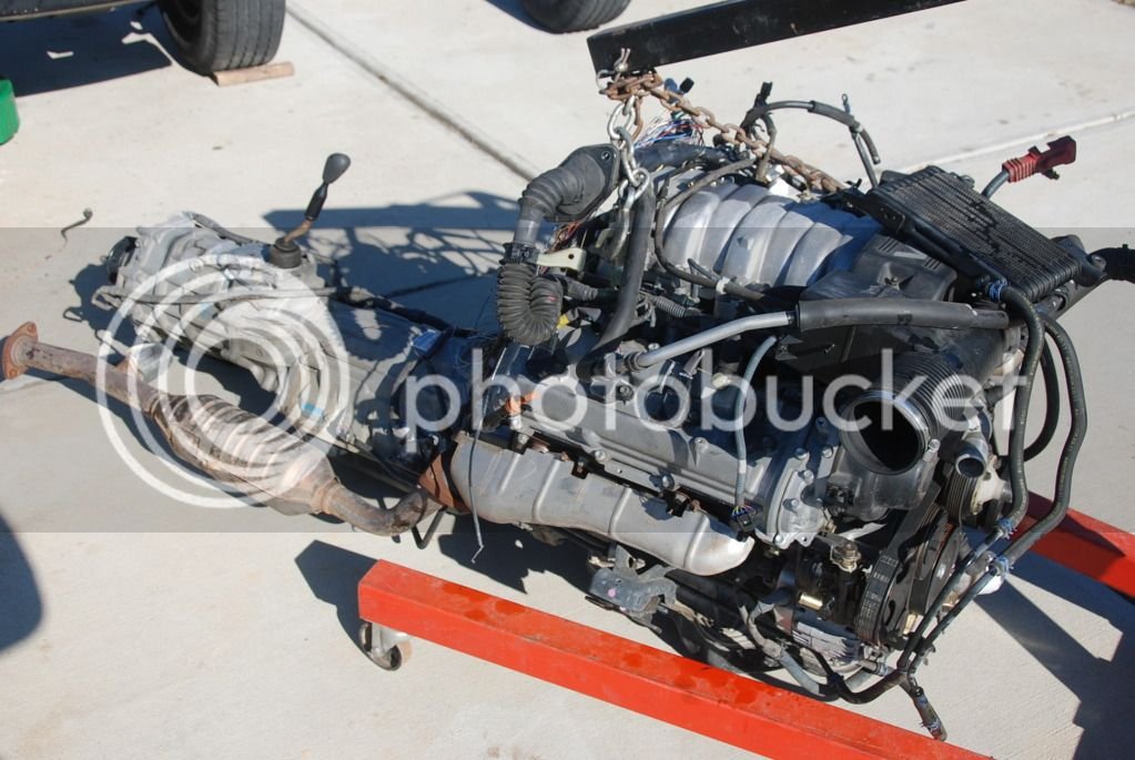

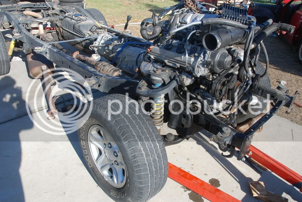

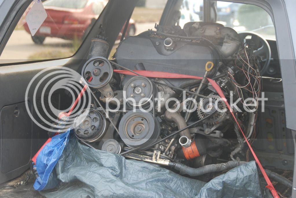

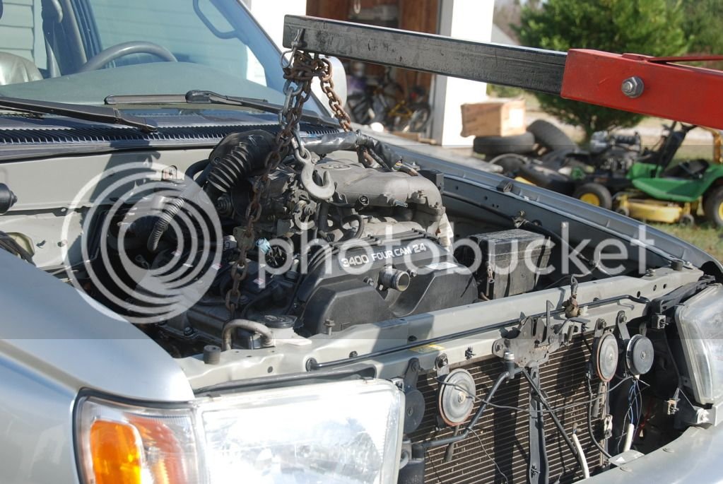

Removed the 2uz as an assemble for mocking in frame.

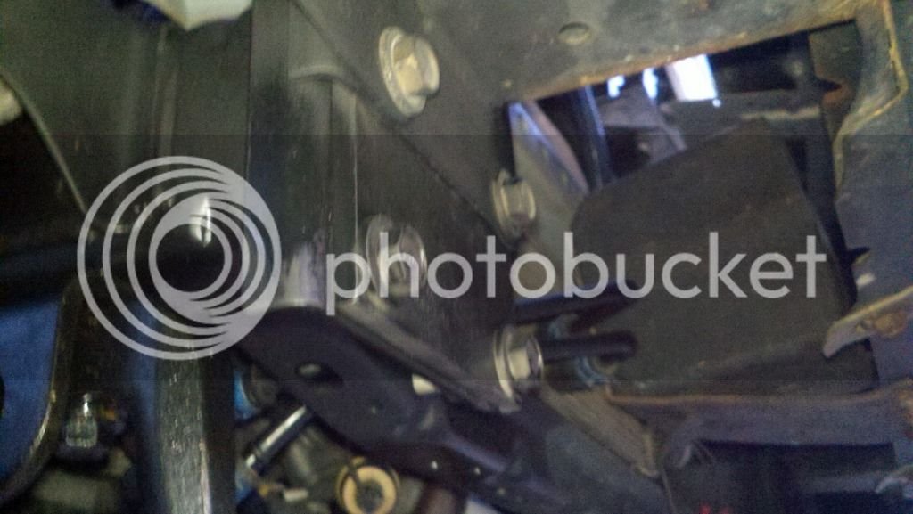

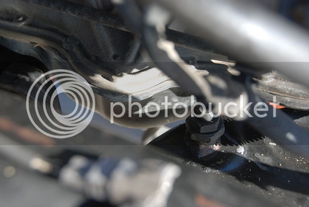

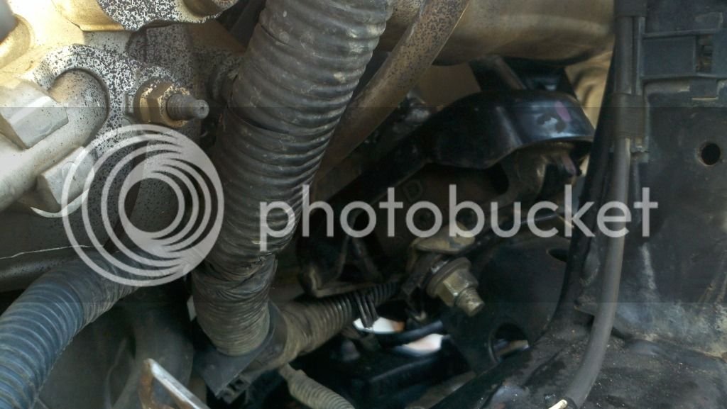

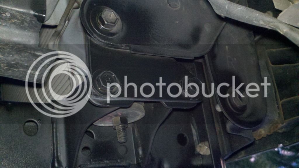

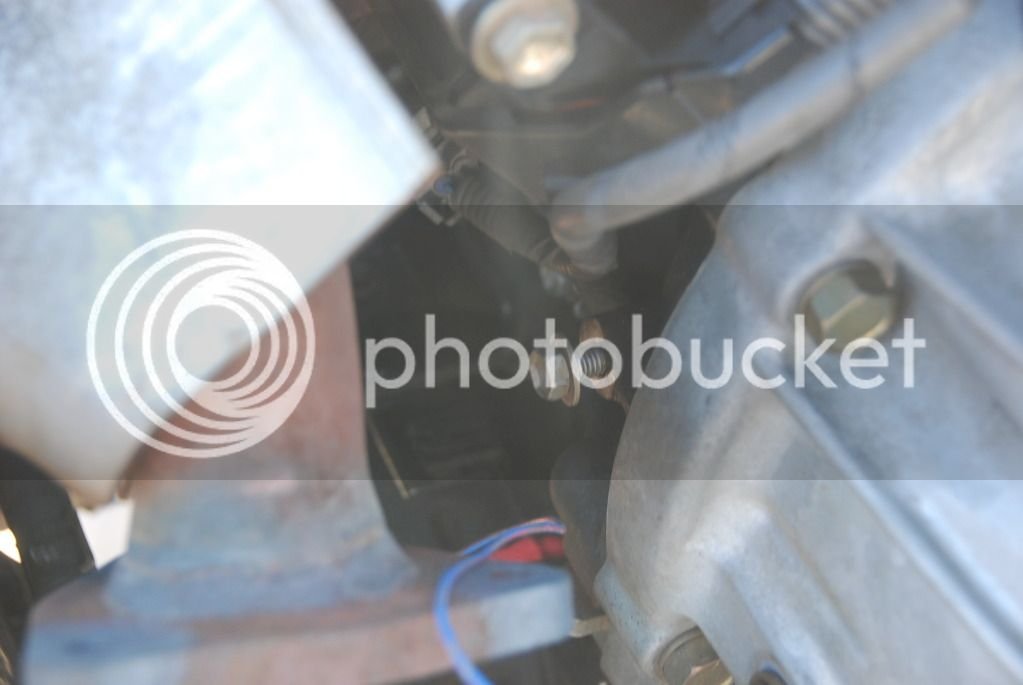

2uz motor mount
Crazy bolt pattern for 2uz motor mount.
What the hell is this. There is another one on the other side.
Mocking the engine in place
Passenger side cat has perfect fitment all around.

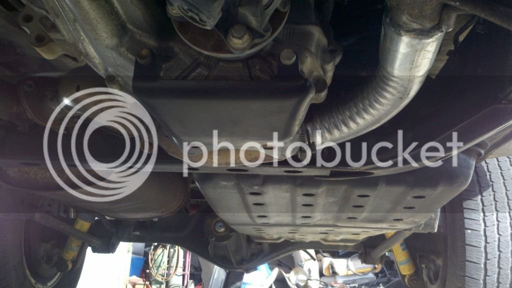

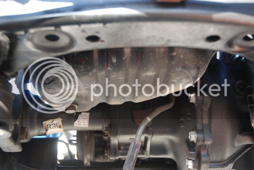

Oil pan sump fits in between the diff and the frame cross member beautifully.
Oil sump fits around the diff mounts
Oil filter is easy to get too.

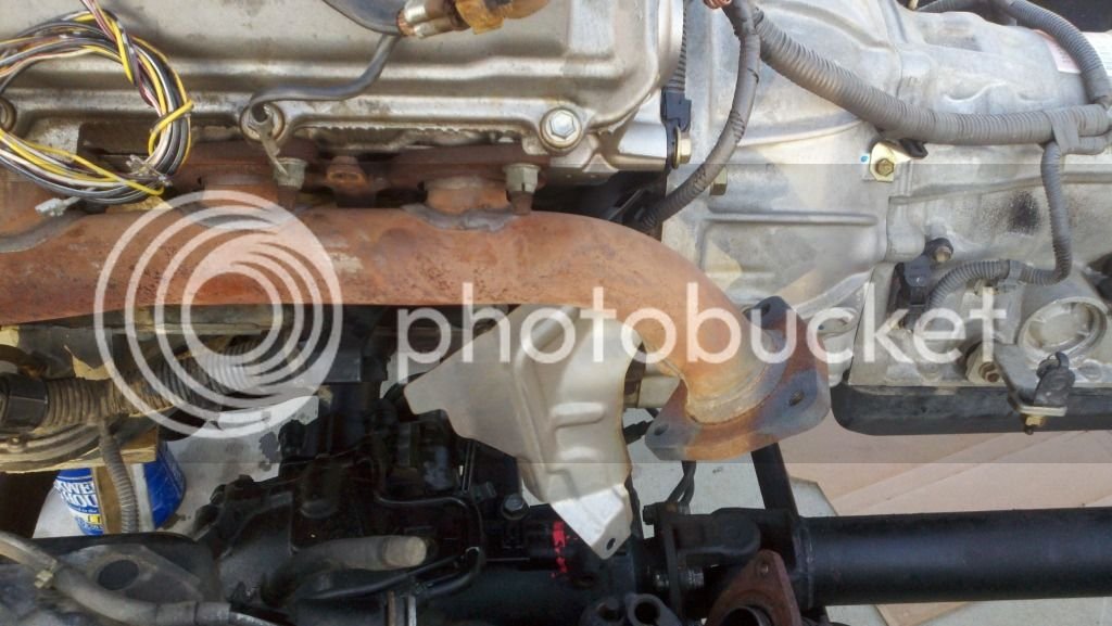

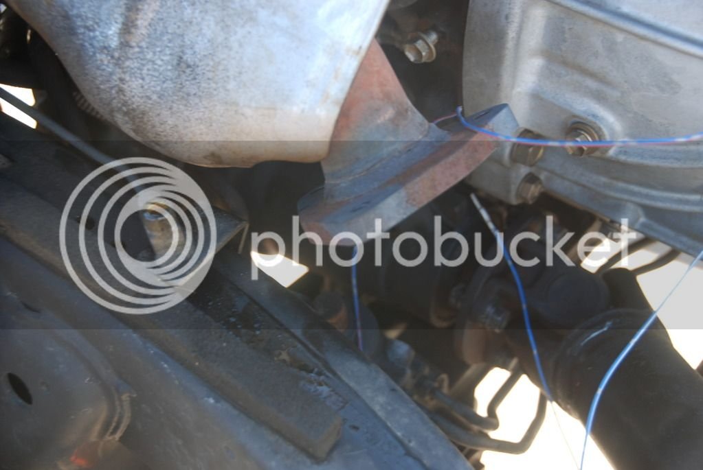

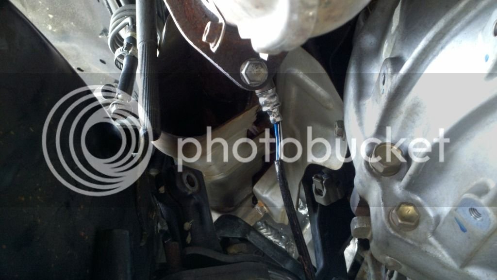

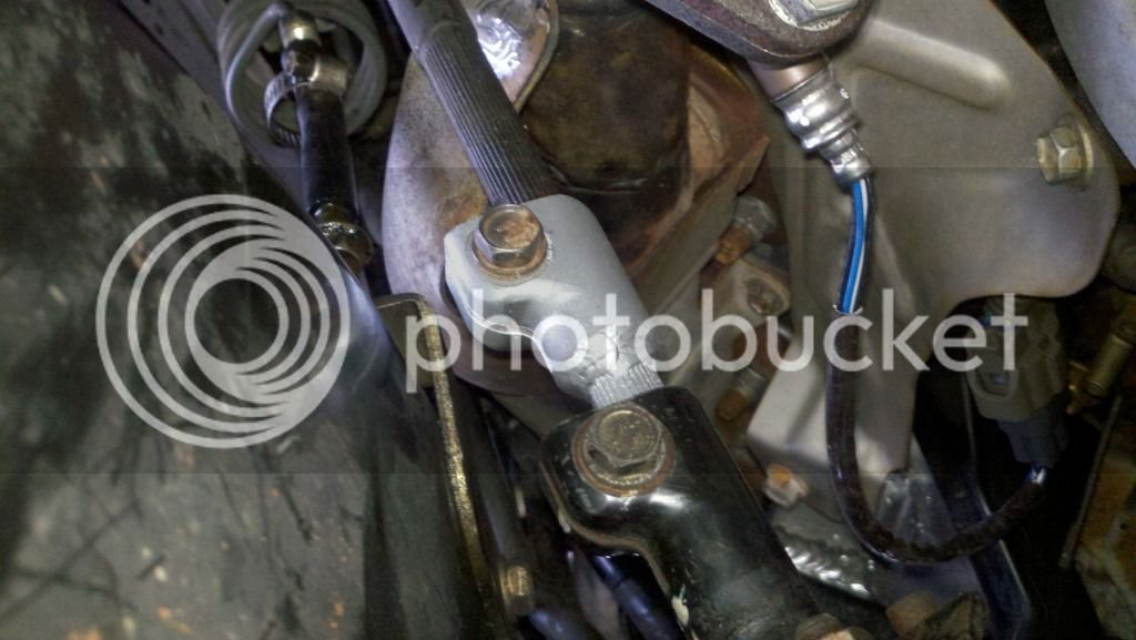

Drivers side exhaust will need work to clear the steering shaft. :(

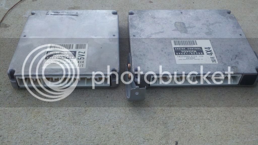

Other bad news is the the ECM is much larger then the V6.

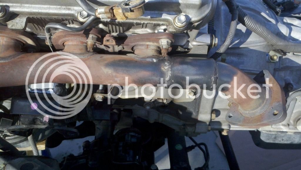

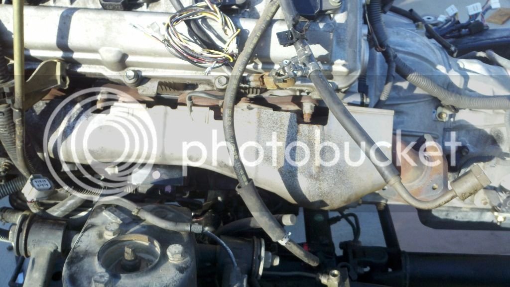

Stock Tundra (sequoia) header
Cut and extended to clear my steering shaft.
Heat shield re-installed.

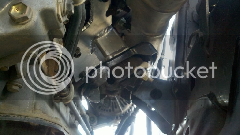

Passenger side motor mount installed
Driver side installed

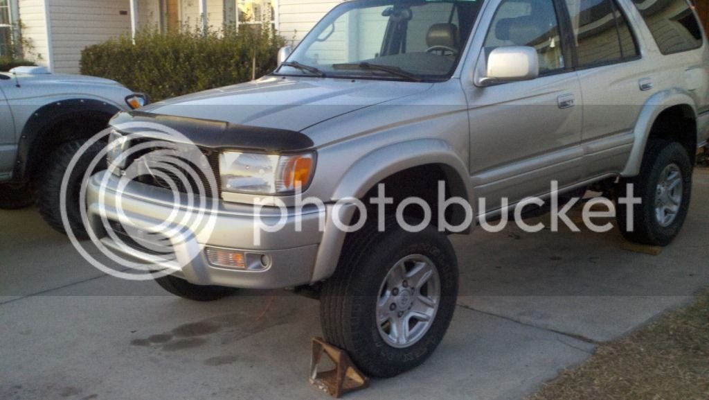

I have decided to go with a body lift.
Being the frugal and impatient person that I am. I spent $40 and made my own 2" lift. Grade 8 bolts expensive these days.

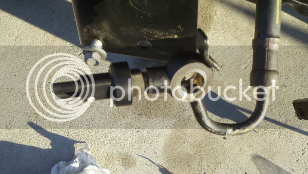

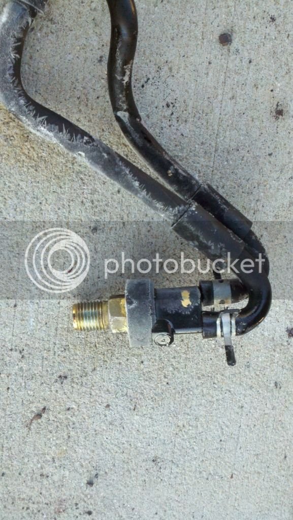

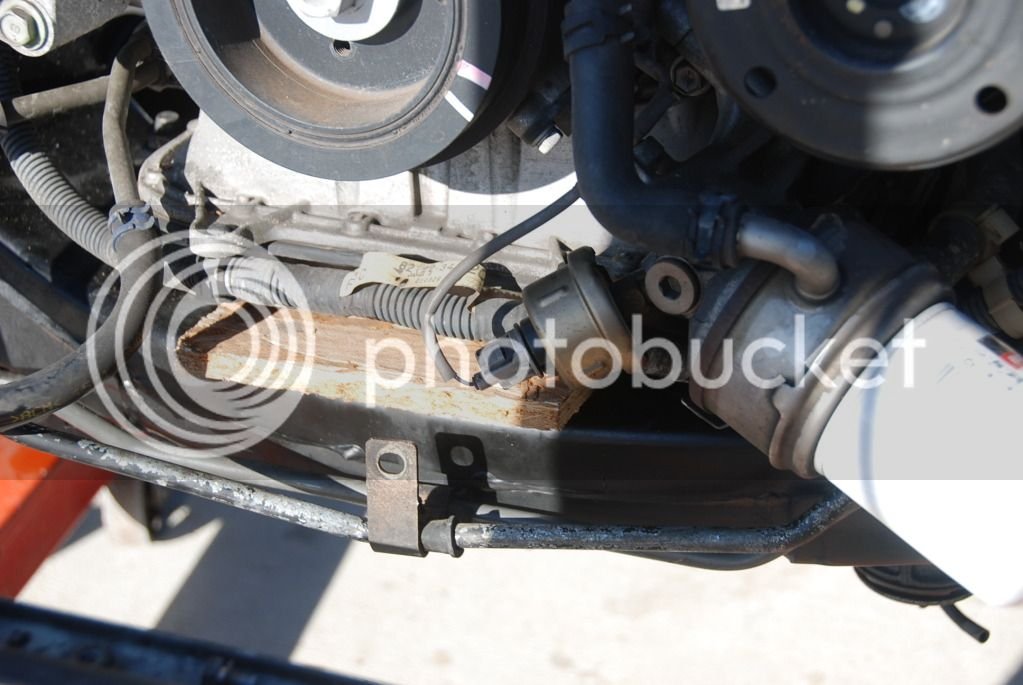

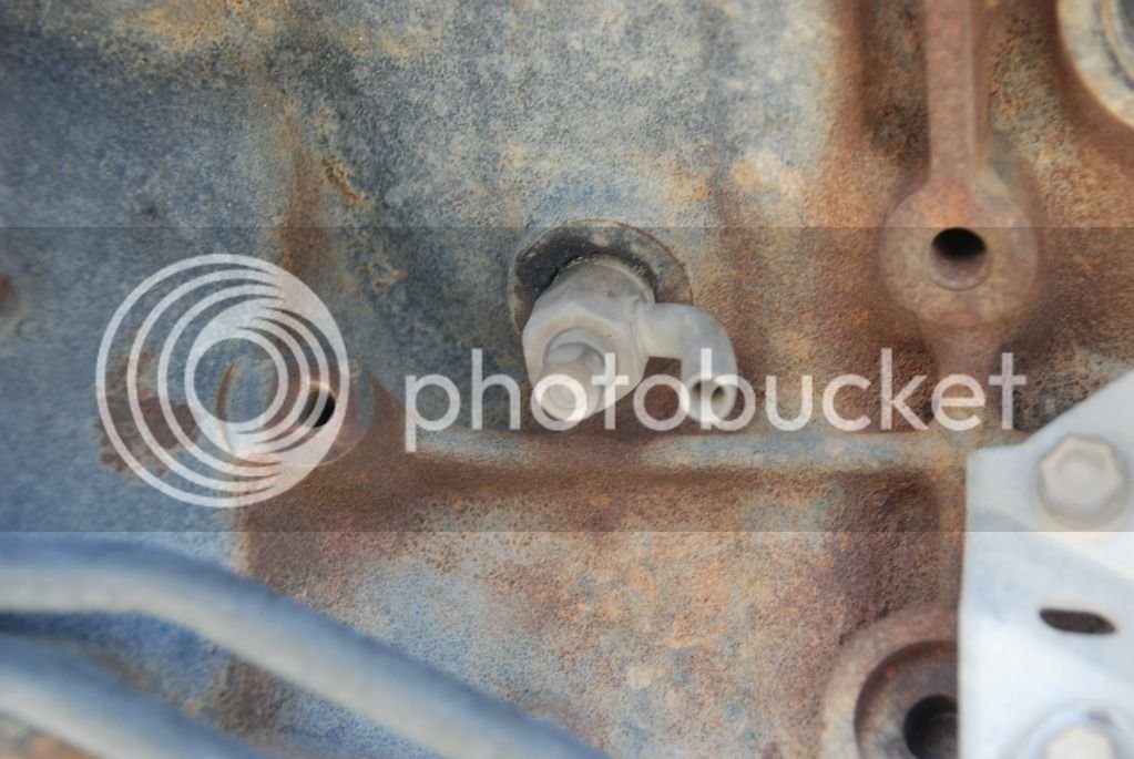

Hooked up my power steering.
The 4runner had an electric pressure sensor that bumps the idle up when turning.
The V8 was operated by a mechanical switch that let more air in past the throttle body.
It was cold this morning too.
Vol la, it the 4runner is now mechanical.

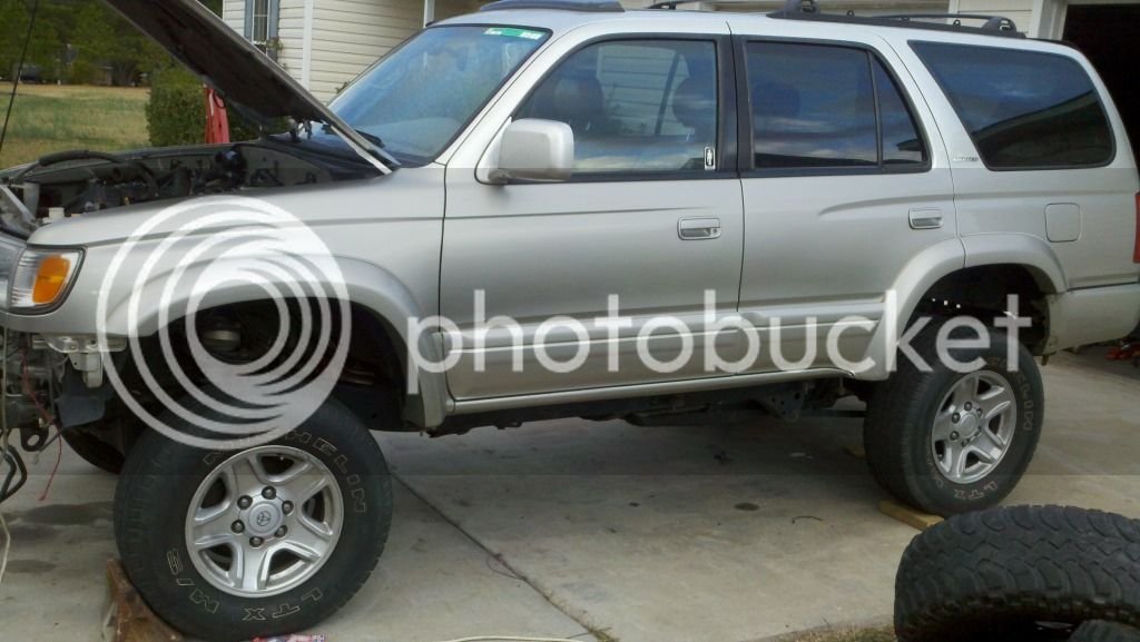

Anywho, Here is a picture of my hoopty on 255's with my 2" body lift.
I have 265 AT's to roll and a set of 285's on steelies for special occasions.

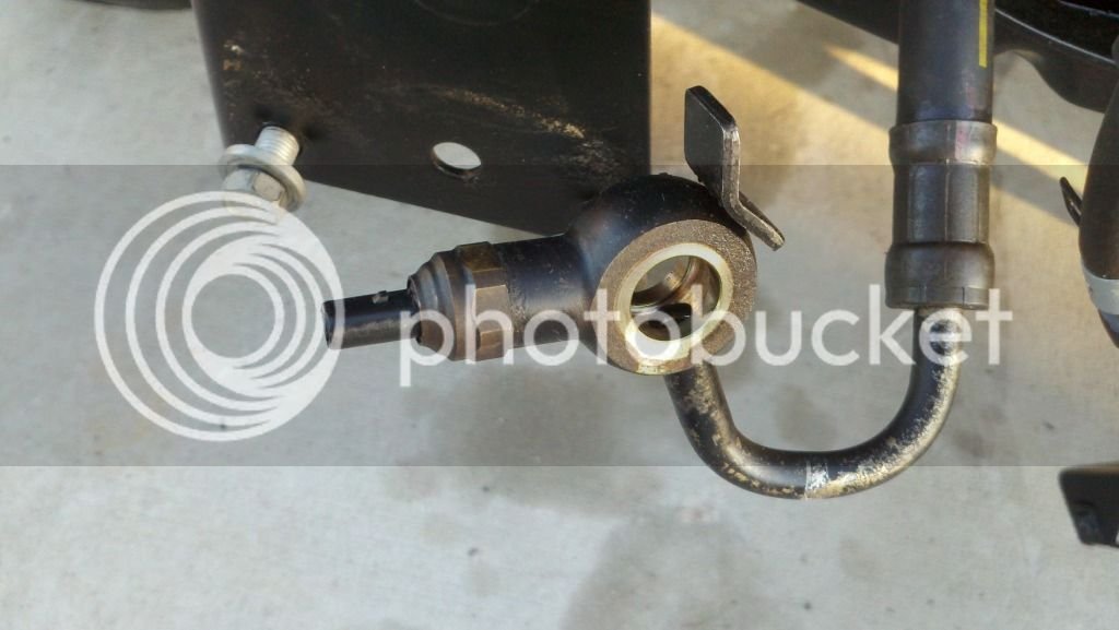

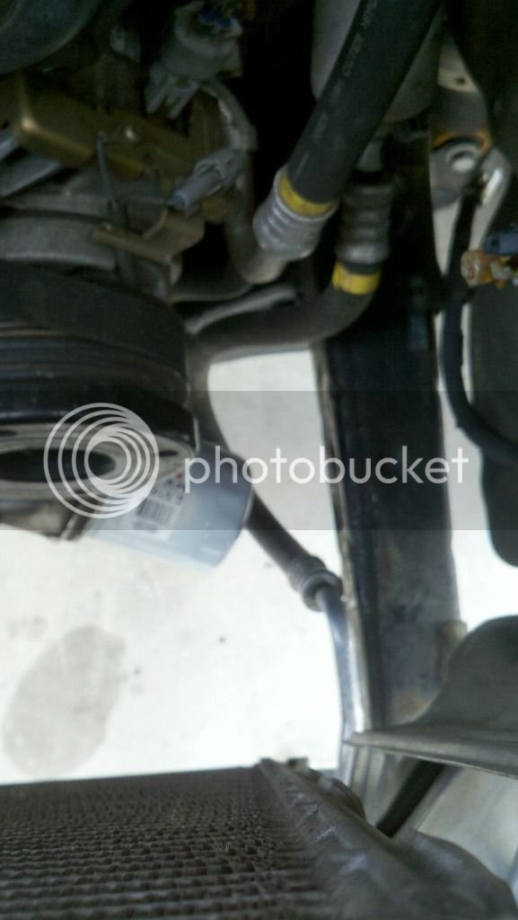

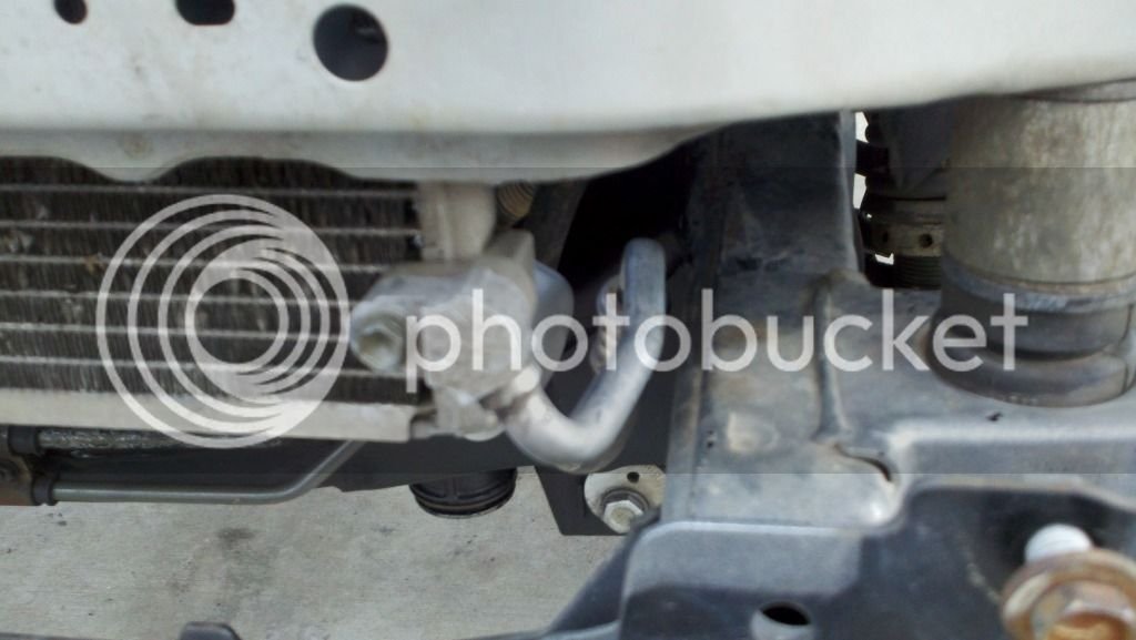

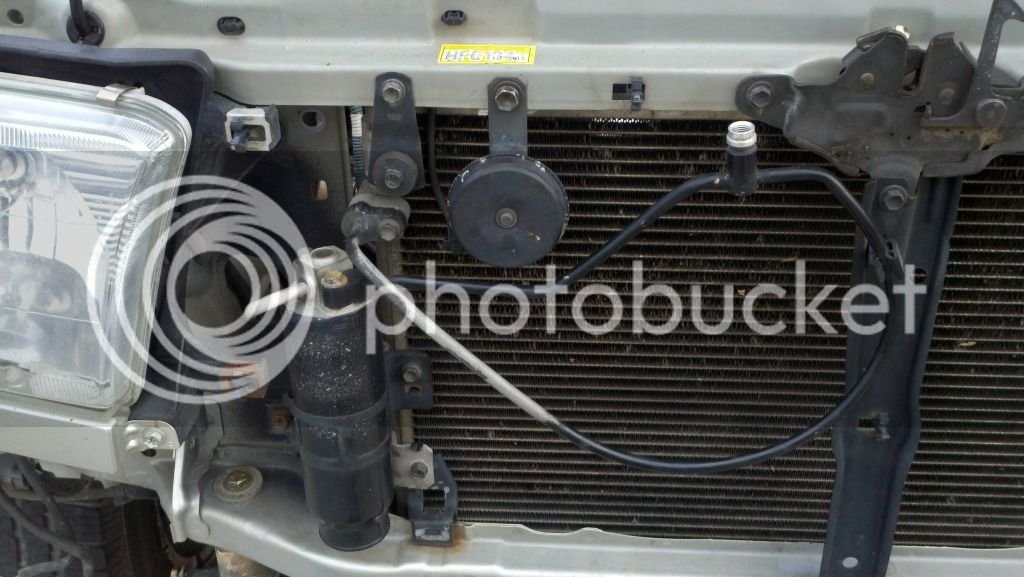

I hooked my AC.
The AC Pump is on the drivers sideon the UZ while on the 5VZ, it is on the passenger side. I had rearranged the plumbing on the AC condenser so that i can utilize the 2UZ hoses.
Hose in the engine compartment
Moving the high preassure from the right to the left and now it is from the left to the right.

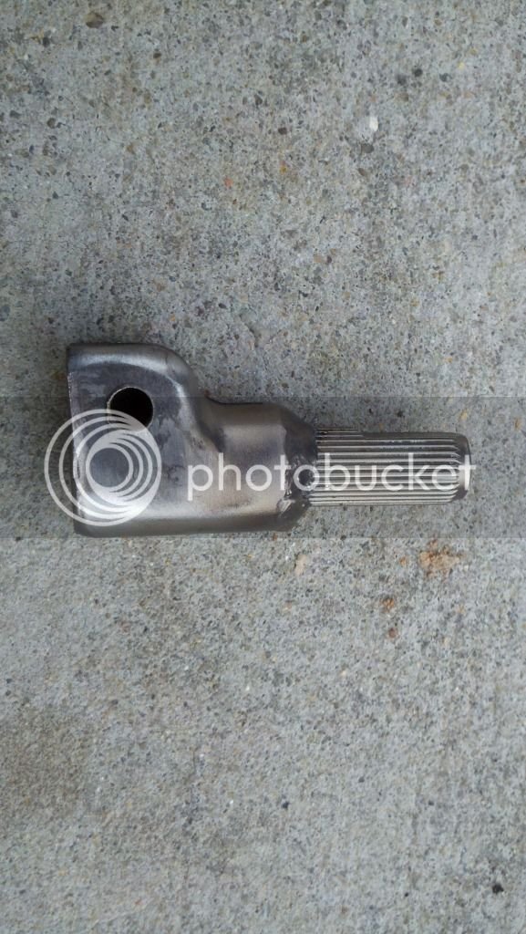

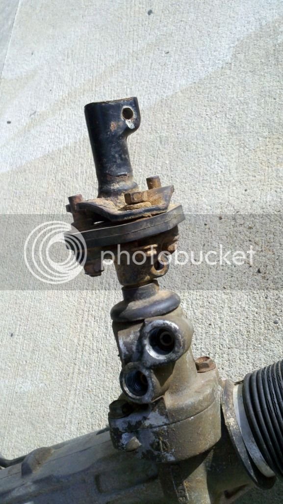

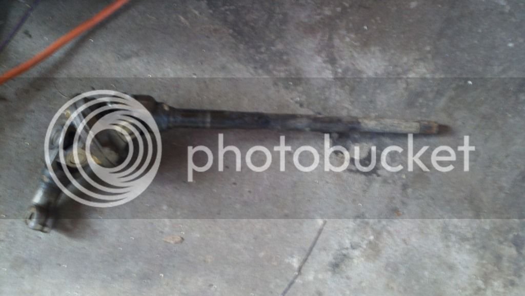

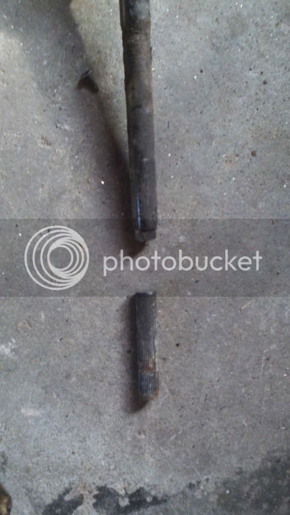

Finished my steering extension for the 2" lift.
Had an extra coupler
Had an extra shaft
Cut the shaft and the coupler and made my extension.
All welded up
Here it is installed.

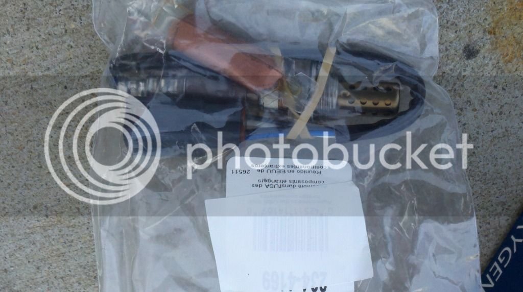

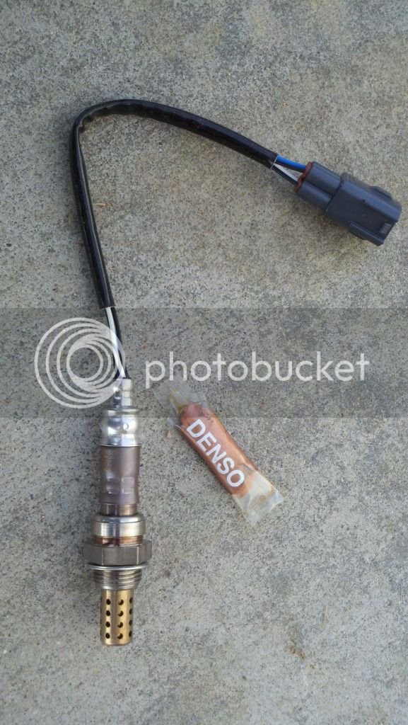

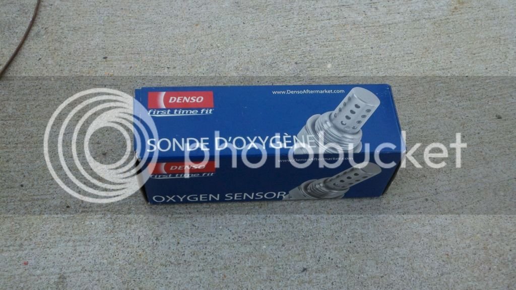

Got an O2 sensor off ebay. To replace the one that i stole to fix pop's Sequoia.
Cheap $40
New in plastic
Always use Neverseize , Denso was kind enough to send some with the kit.
Installed, So easy.

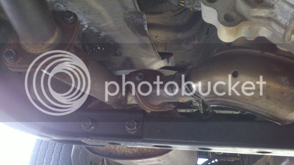

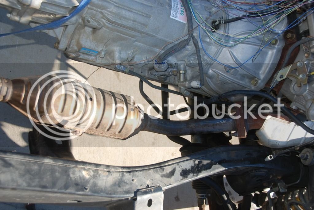

Some gratuitous exhaust pipe photos.
I tried to snake my exhaust so it is not the lowest point under the chassis.
my Y pipe.

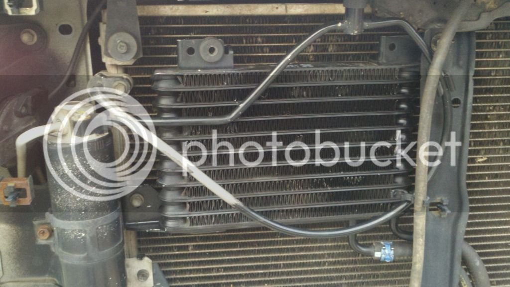

Installed the tranny cooler. This was the factory UZ cooler and just retrofitted to my 4Runner.

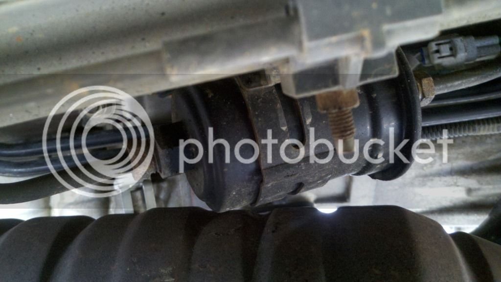

Another problem.
Fuel filter is dangerously close to the cat. i am thinking about moving it to the out side of the frame rail.

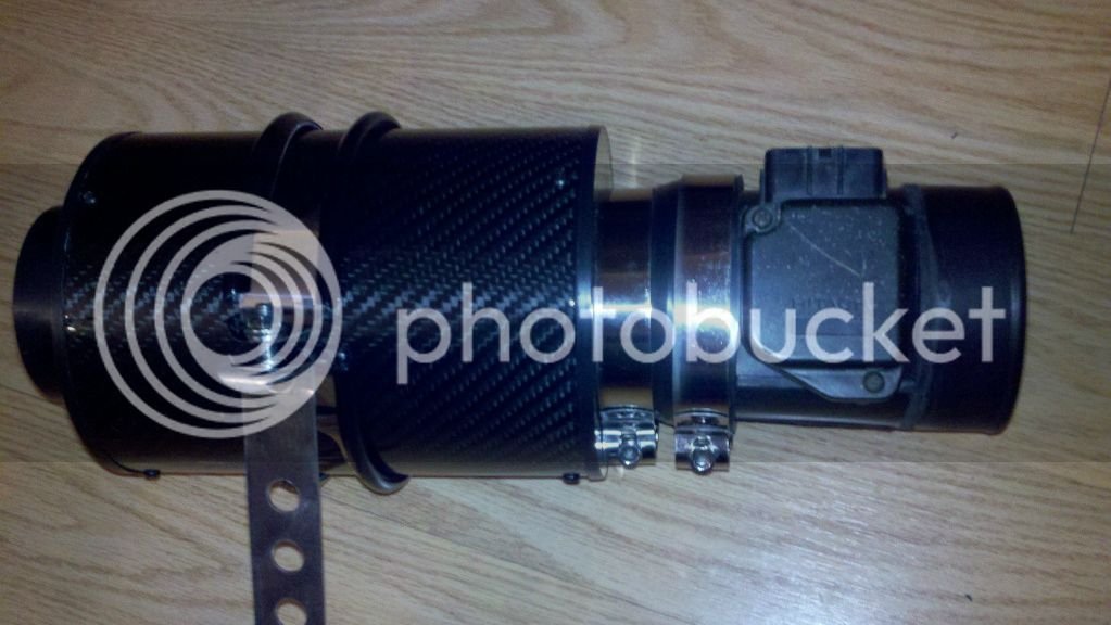

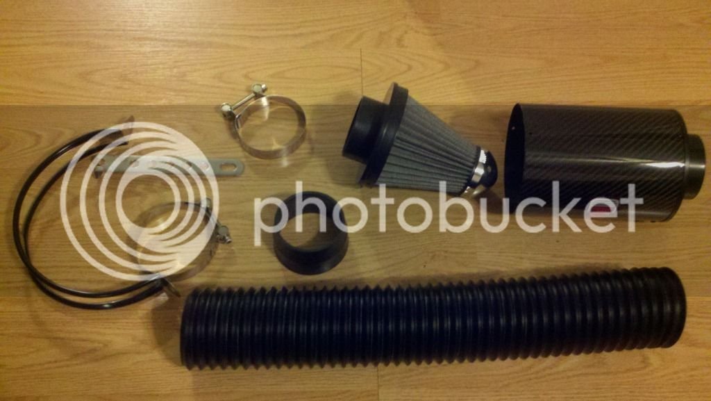

Air intake crap - Kamotors Performance Carbon Fiber Filter 3" Cold Air Intake BMW VW

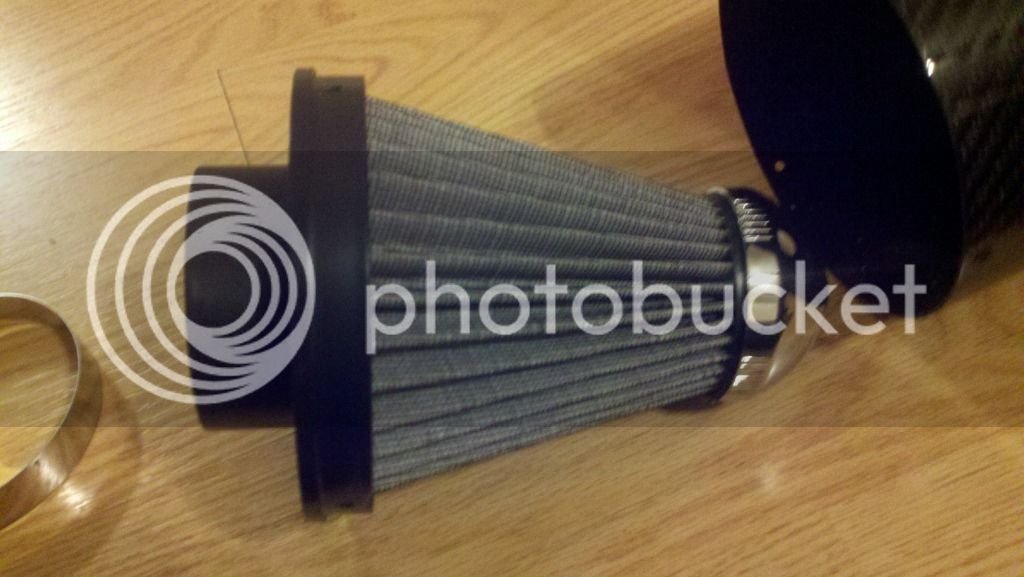

As you guys are all aware, I am doing my V8 conversion. I can not use the 4runner air filter box nor can I use the Sequoia air filter housing. So i had to come up with my own.
Any way, I found an enclosed filter housing on e-bay. Neat idea, Lets me grab cool air from the stock snorkel location.

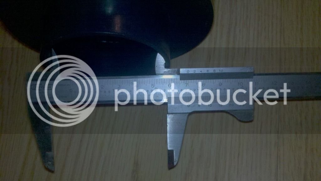

I order it, pay the $83 and the ****er false advertised it. What an ******* mother ****er **** douche bag. He labels it as a 3" intake but in reality, it is only a 2.75" intake.
the intake on the 2UZ is 3". Will it be restrictive, I don't know. I am bitter about the whole situation. I asked for a refund. He declined. I am now flaming this re****. Basic just to let prospective buyers know not to buy from KaKa Motors.

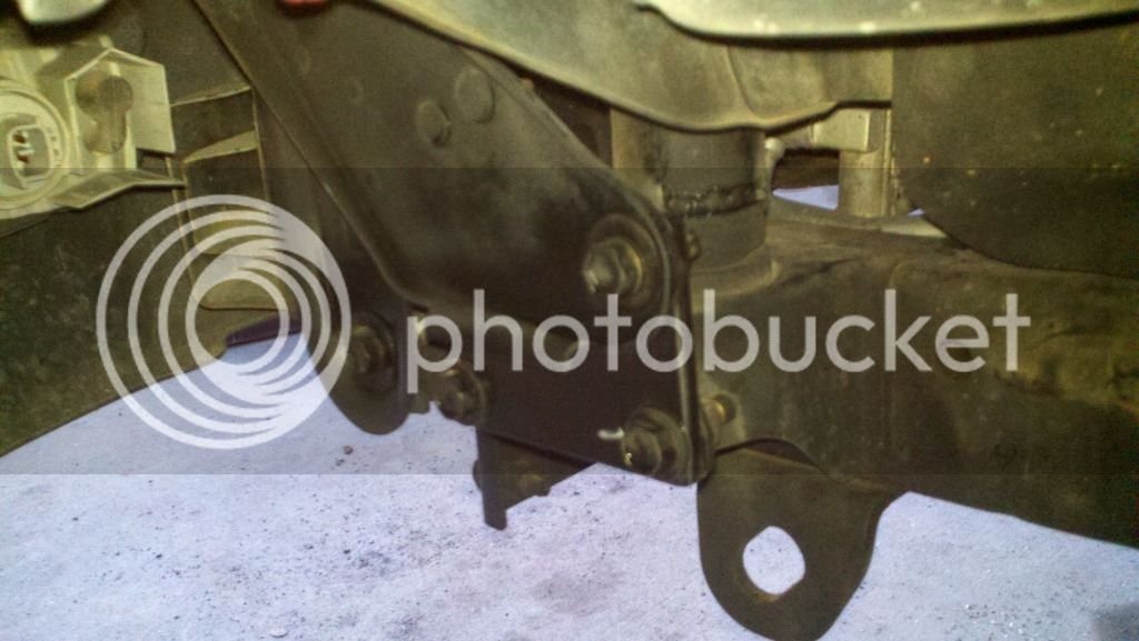

Still Waiting for parts to come in. So I made my Front bumper relocation brackets.
My lift is officially done, with the exception of lifting the trailer hitch up.
I guess i went overboard on my bracket material. 1/4" plate but it was free.
It is what it is.
My bumper is mounted.

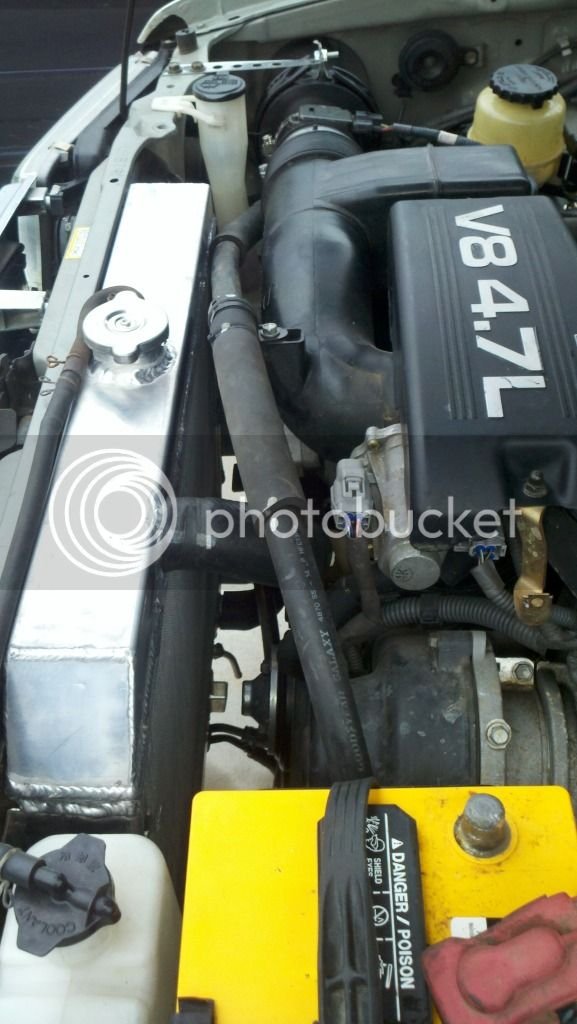

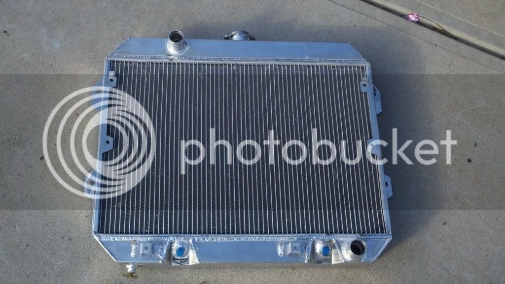

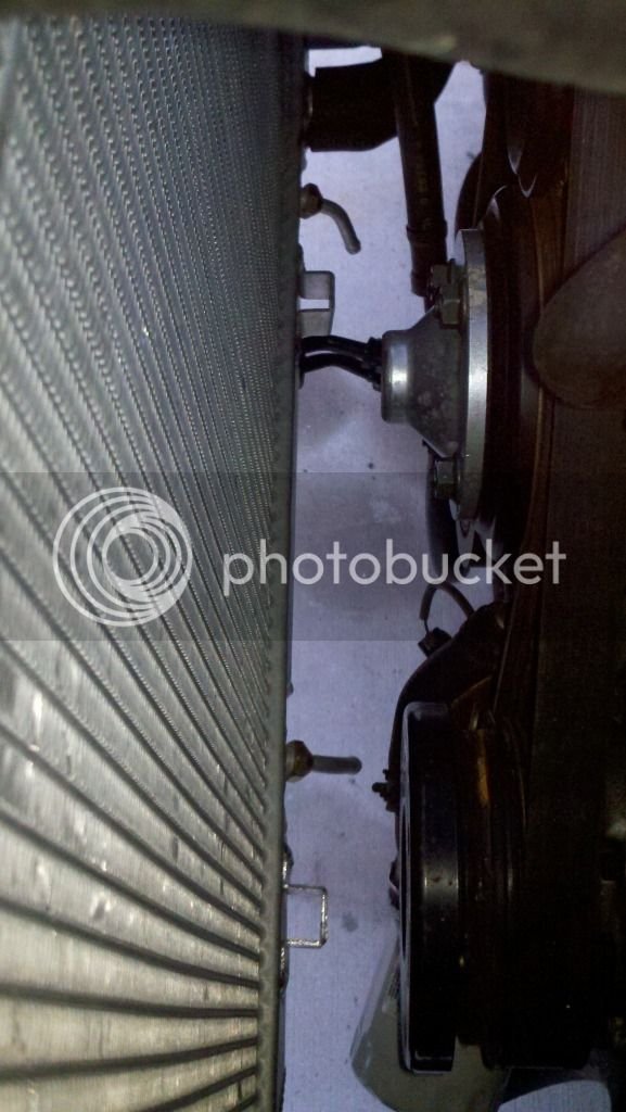

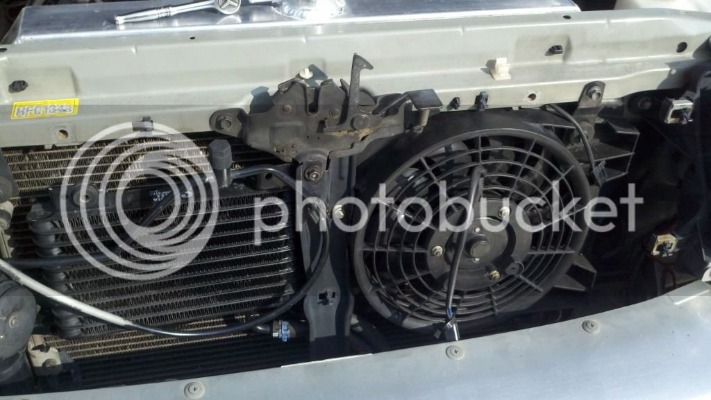

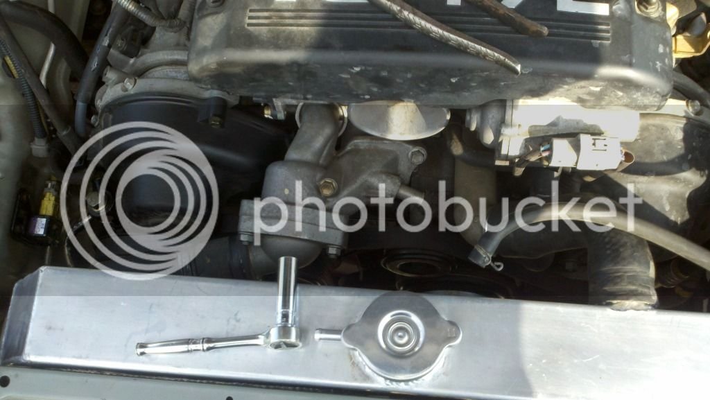

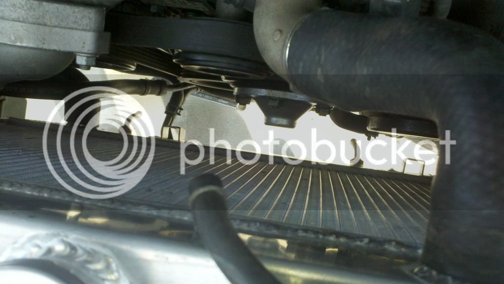

Got my radiator and installed it.
installed
Clearance?
Got my pusher fan installed

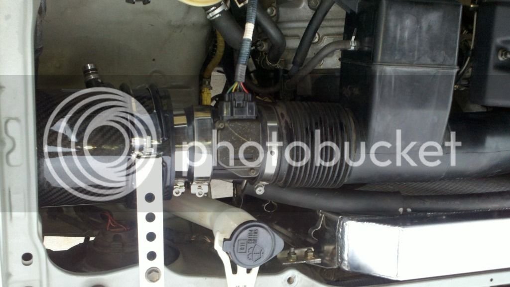

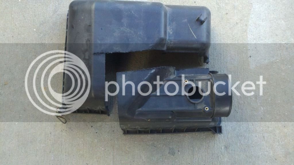

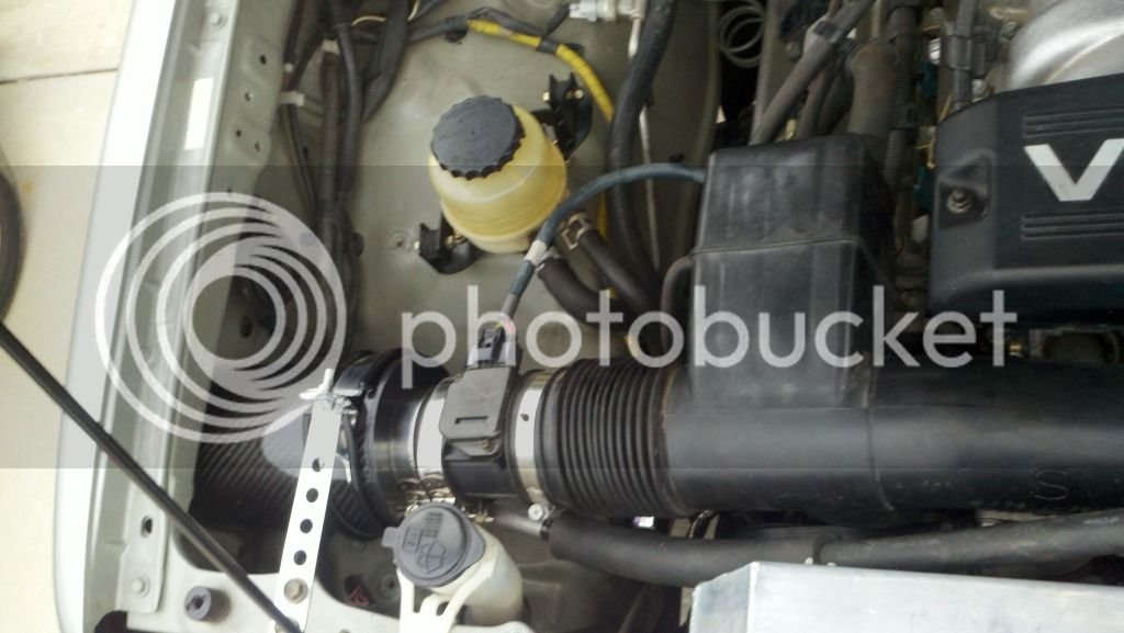

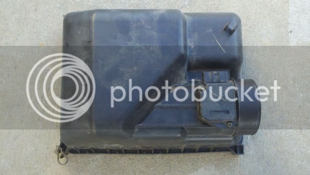

Making my Air intake.
After the disappointment with the Ebay air intake, I forged on and decided to use it.
I could not fit the Sequoia Intake assemble in the stock location because it is just to big. The 4Runner Air cleaner assemble had the intake coming in at the wrong angle. Just not enough room to manipulate the intake hose from the engine to the housing.
I could have just stuck a filter on the end of the MAF sensor but that would look to ricey (as if my radiator wasn't ricey enough).
Anywho, This what i did.

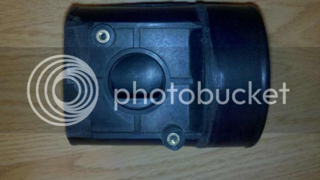

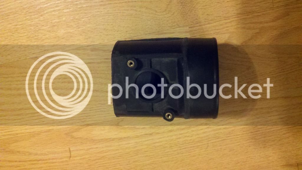

I took the stock Sequoia Air filter box
And I cut the MAF mounting point out.
Cut and trimmed the MAF
Up Close
Used the crappy kit from Ebay
Attached it to the MAF
Installed into 4runner
So now my 2UZ-FE is getting cool air from outside.
