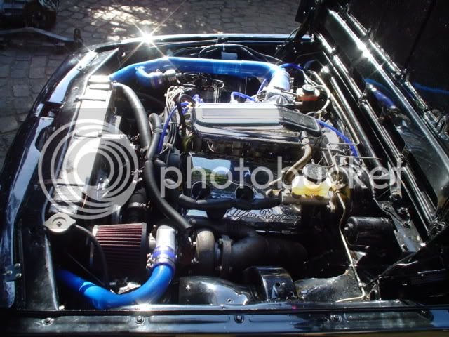

A lot has been said about turbos here, more so about sizing and whether a single will do over twins etc,etc.
I have built over 30 odd single turbo Alfa Romeo engines over the years and have conclusively equaled or surpassed any benefits a twin setup may have given over the single.
From cost, ease of install, plumbing, etc. The only time a twin has been beneficial over a single has been when we have had a bulk buy on small turbos.And then I was not so sure.
I have now decided on the 1UZ for a project Alfa Romeo and will consider a single turbo setup for the bog standard engine. It will be a single setup as well.

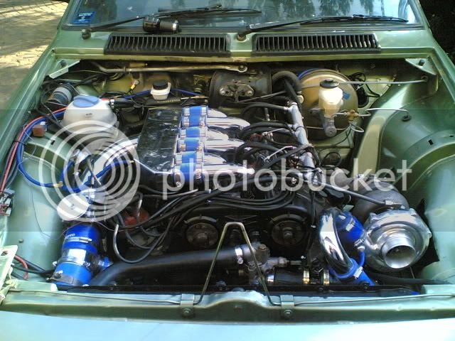

I tried to see if the engine is a 1UZ, but I couldn't see anything familiar. Now I know it's not a 1UZ. Nice engine with turbo, though.
