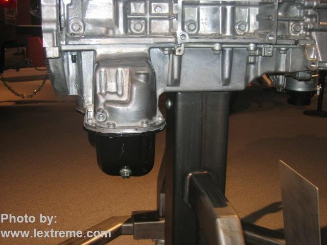

The tranny adapter should work, but I would have to see if the flywheel is the same (I bet it has the same flywheel). Then there's the oil pan sump location; I would probably need to make a custom sump.
Biggest issue would be the cost of the cams, and potentially what damage there might be from the worn down cams. In theory, that oil should drain to the pan and get filtered.

TRD Supercharger will make it a true 500 bhp and 550 tq. I can take some pictures today. As for some, the new Tundra has REAR sump. So it should fit Supra and SC4 without any major fab.
