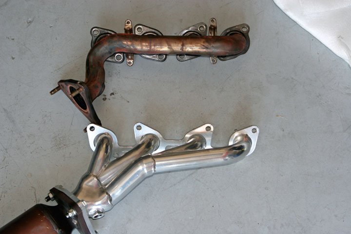

Here is a link and quote from a member with a GS400 gaining 3 tenths in the 1/8th mile. That is impressive as most consider 10hp per 10th gained is fair. This is also a 400 which has better stock manifolds than the 430s. All in all this is a mod you FEEL and enjoy at all throttle points and RPMs.
It is your choice but there are not many options that give this kind of a gain without any negatives.
http://www.clublexus.com/forums/per...aders-yet-how-are-they-holding-up-so-far.html
i picked up about 1 to 2 tenths in the 60ft and about 2 to 3mph, but 3/10 of total ET with 20s
BTW, I am in Houston. If you decide to get a set I might consider doing your header install. We could do some before and after performance testing as I have a GTech Competition. A few have had luck tuning the A/F ratio with SAFC Neo units. You could probably get into the 260-270rwhp range with the headers and tuning.

So far, I like the headers but I'm a little concerned about reliability after reading the post.
Since S&S changed from 16 gauge .065" wall tubing to 14 gauge .083" wall tubing and reinforced welding there have been no reported cracked headers to date. They do not make the car noisy, improve power in all RPM ranges and should improve fuel economy if you can resist feeling the power.
