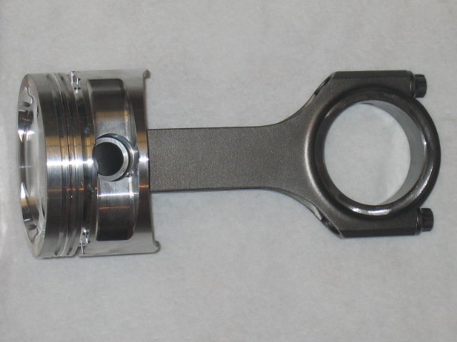

LOL....... You missed the group buy last month.... The reason why 2uzfe pistons are expensive is due to the ring size. 3.70" is very hard to find and if you find them, they are junk. The rings are custom sized to fit the 3.7" bore. That is why Ross charge extra for the 2uzfe pistons. Most company don't even want to touch the one off. Please pm me if you need some help. Here is a picture of my 2uzfe pistons with H beam rod:

Just let me know the following info:
* Over bore
* Type of rods - Stock, Argo and etc...
* Compresssion
* Which head this 2UZ will made with.
they'll be Zuffen's GP rods - so Argo i think.
the bore will prob be 5 or 10 thou.
8.8:1 CR
and prob running 2UZFE heads.
but i'll let you know closer to the date. just need to know if i can get pistons first and the sorta $$$ i'll be looking at.
