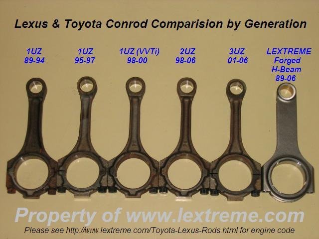

Here is a picture of 1, 2, 3 and H Beam rod. As you can see why the 2 and 3uzfe rods are very skinny.
Legend:From left to right:1uz, 2uz, 3uz, H-Beam
