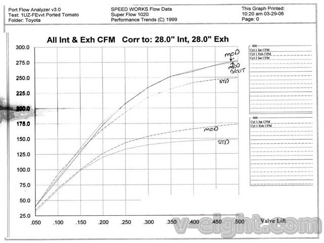

heads basically flow the same as the vvti 1uz. and no difference between vvti and non vvti 2uz ports
What I am after is the actual flow rates at different valve lift for exhaust and inlet valves. If you could tell me the standard cam lift and duration on both valves it would be a great help. Russ
