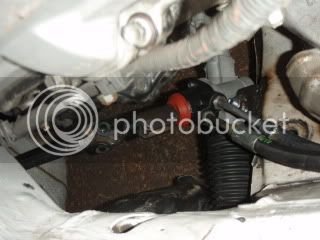

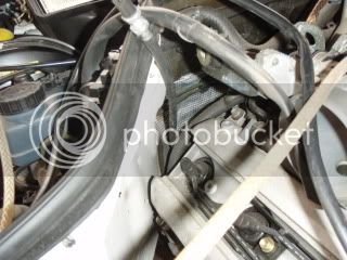

Have got the car back from the engineers at a cost of just over 10k. Most of this was R&D and i wanted the commodore steering to work exactly as the original mercedes steering had. The only main difference is that the merc had a collapsible steering column which now sheers instead. The motor has been mounted as far back as possible. We managed to get much further back than in the e500 and now i can fit the original toyota exhaust manifolds. (so i can start the car after the wiring is done) A new tailshaft had to be made out the merc and toyota as adapter plates dont comply in vic. unless original equipment. The holes in the merc plate didnt line up.
Curved firewall clearance there is more clearance than what the picture shows but it is a tight fit.
Overhead view of the commodore rack.
