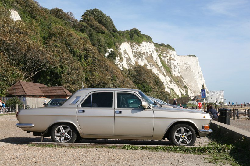

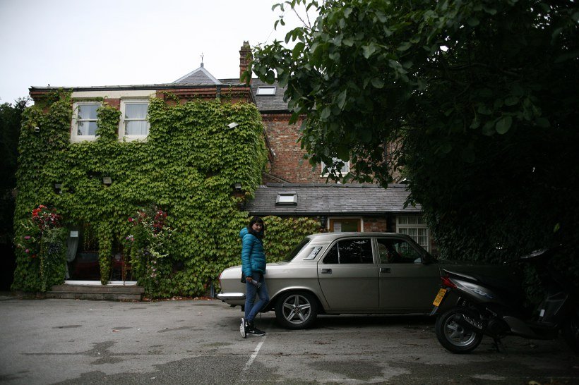

Been to UK recently
Got home on its own power
Has small issues though
Your Volga looks strange to me.
I remember Volgas from my childhood. Some where used as taxis.
Looked very different. Maybe a bit like a Citroen DS type car, and they
were incredibly strong.
I still remember a wee news bit from a newspaper:
Head on crash (there and there) between a Volga taxi and a 22 wheeler carrying timber.
The Volga could back out of the wrecked 22 wheeler.
cribbj yep no handbrake at all. I use them just incase.
melvinmelvin you're referring to 21 model while mine is a facelift of 24 model with some external features never seen on original car

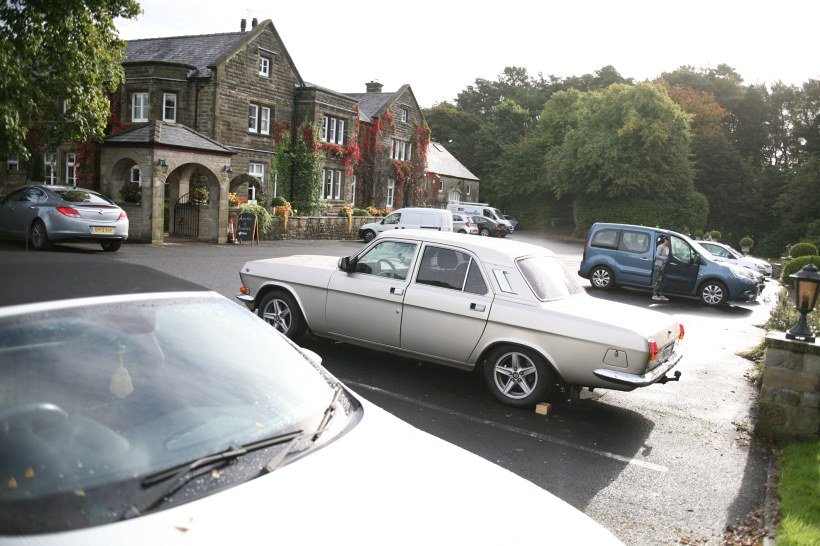

been to UK one more time
Still runs fine. 10.5L/100km @ 120km/h on highway, RPM is ~2800 1/min at that speed which is still way too much, but chances to find a diff with longer ratio are close to zero (current diff is 3.54:1)
I agree; nice looking car there George! Looks like it has a helluva big boot. Why so much cargo space?
