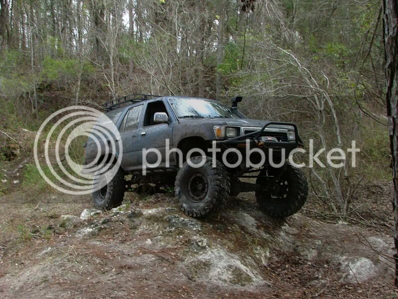

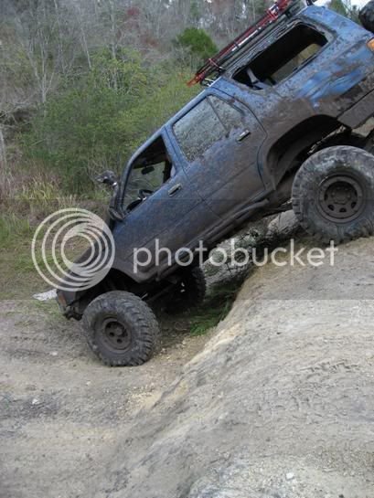

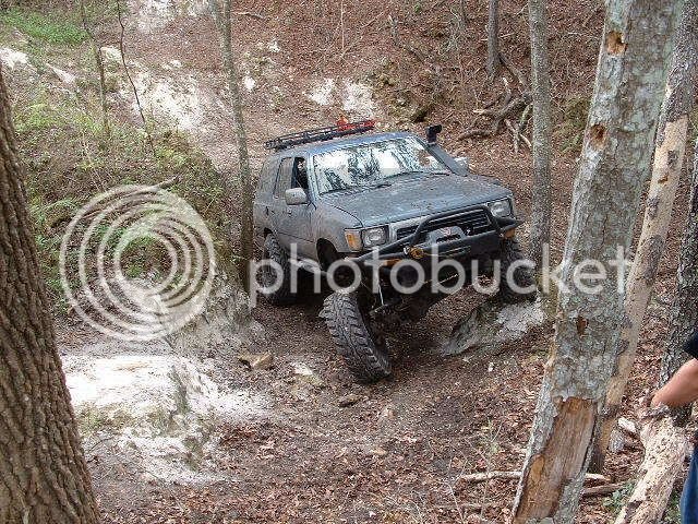

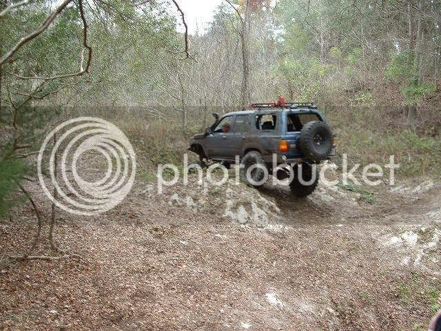

I'm going to be getting a 94 SC400 with 106k miles, engine runs and sounds really good. I'm going to part the rest of the car out but there isn't much left. The big question I have right now is, What all do I need off of the SC400 to get the 1UZ to run right? I know I need the ECU and the wiring harness.
How much is a good auto trans warth for a SC400 (106k miles)?
The wiring it up to run RIGHT really makes me want to hold off this swap till my 3.Slow is dead. I've heard the Venom Cobra's wiring harness is the way to go. Is this the wiring off the engine or all the wiring from the engine to the ECU? Account has been suspended - H-Sphere
Is this something that is a must have? cause it's not cheap.
How much of the stock 4Runner's wiring is used/retained?
Once I pull the 3.0 I want to get the 4Runner back on the road with the least amount of down time I can.
Here's another big problem I think I'm going to have with my swap. My 4Runner was in a wreck. I rear ended a F150 and my Rad support is pushed back alittle. So I'm planning on mounting the engine as far back as I can because I already have clearance issues with the 3.Slow and Ford Taurus electric fan. I thought about cutting the rad support and moving the rad. forward but my winch/bumper isn't going to allow much room to do so and I want to retain my AC.
How much longer is the 1UZ then the 3.0?
Is there room to mount the 1UZ back about a inch?
Thanks for any tips and help you guys can offer.
