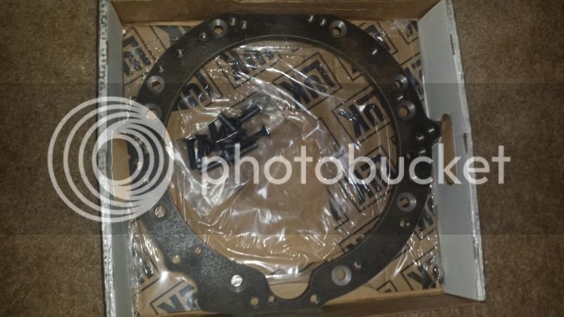

Adapter plate arrived.

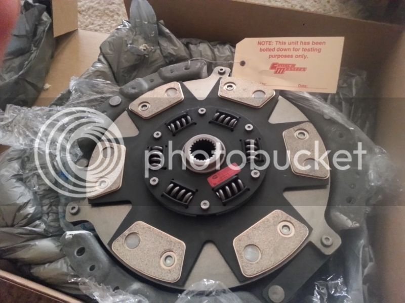

Clutch Masters six puck

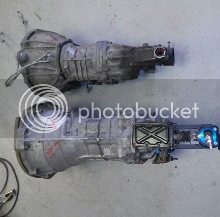

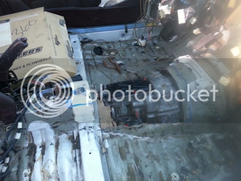

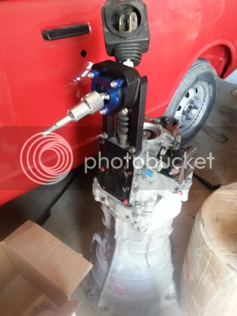

Z33 transmission is too big for the x7 transmission tunnel

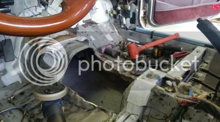

So the tunnel mods have started
The difference in size is crazy! I'm going to be test fitting mine soon... We'll have to see. Keep up the good work.
