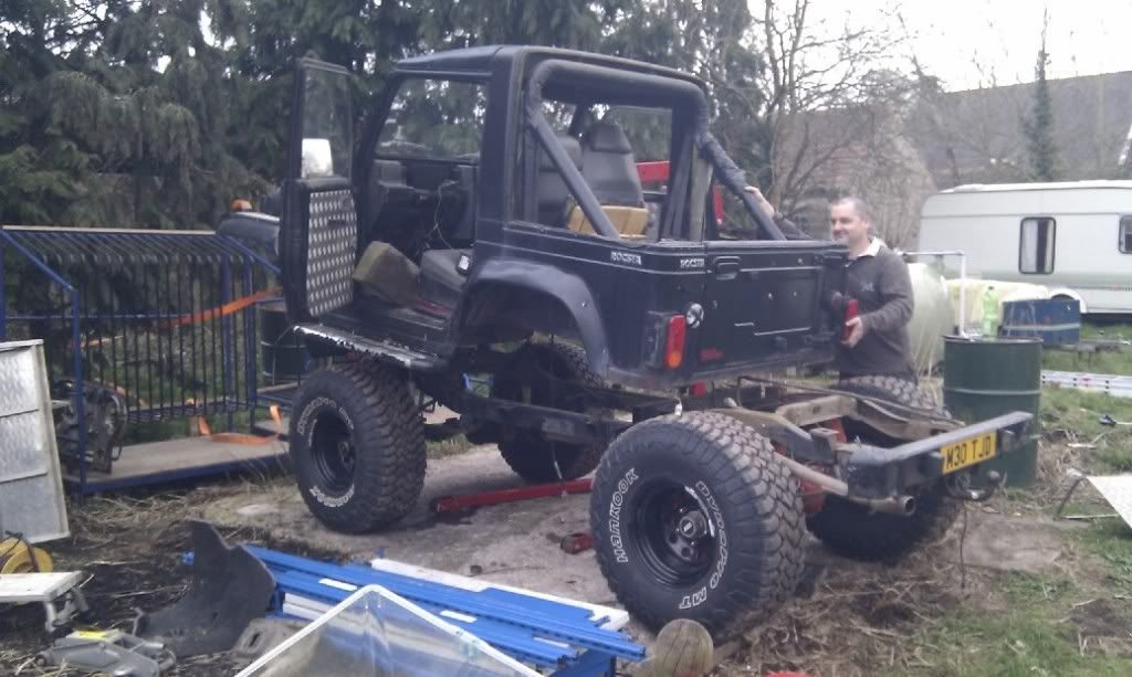

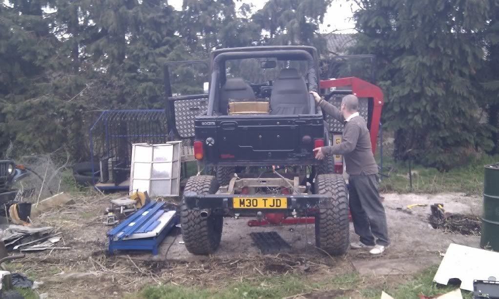

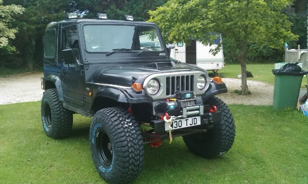

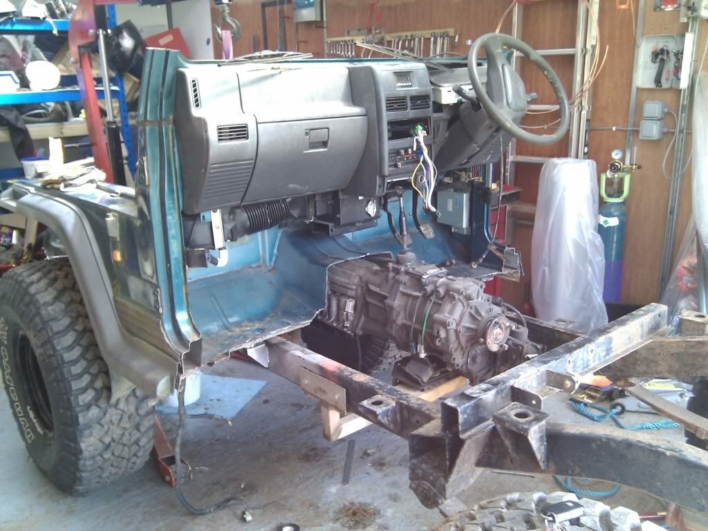

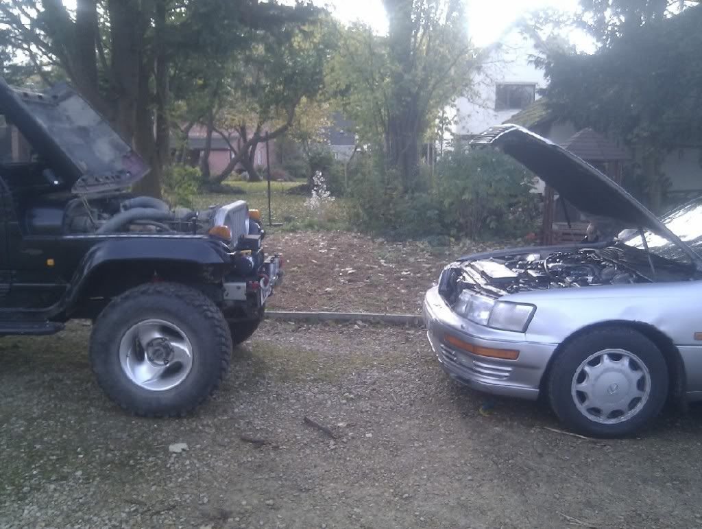

Here is my already modded Asia Rocsta as it looked a month ago
I have already upgraded its engine once to a 2L Mazda 626 engine
This was fine until its extra power started to wear out the gearbox and axles
It also didn't help that I am running 35" tyres
So now I need to upgrade the Gearbox, Transfer and Axles to something Toyota Strong
So I thought I may as well put a bigger better heart in at the same time

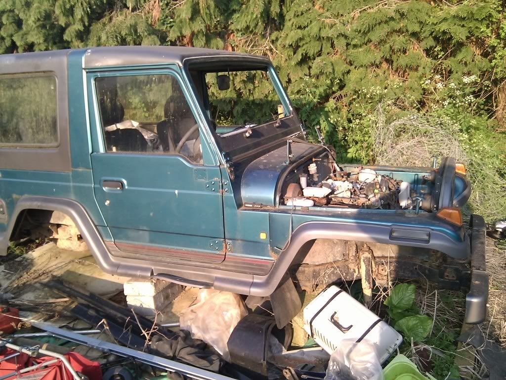

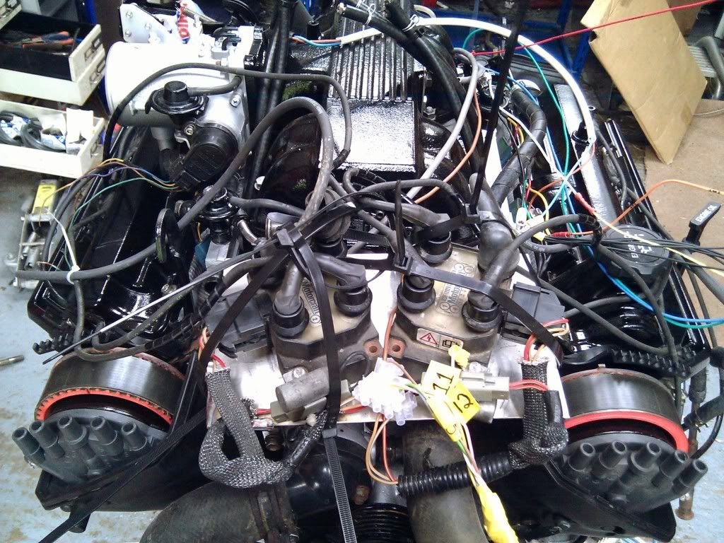

So far I have got my donor car, a Lexus LS400 with the lovely 1UZ-FE engine

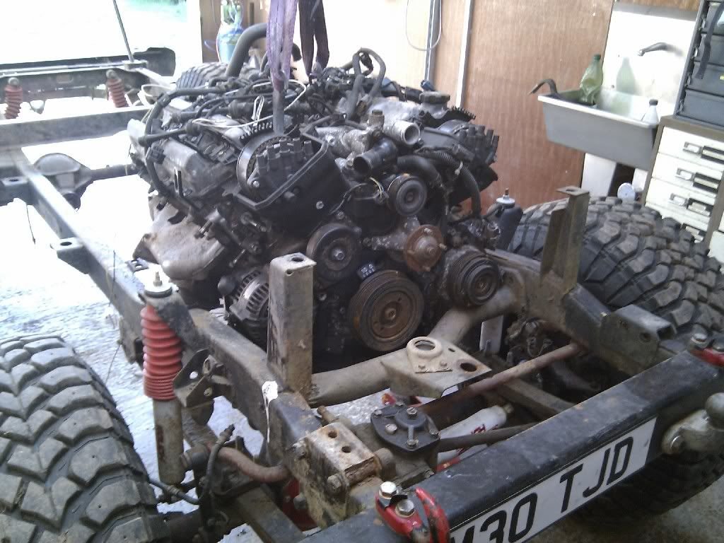

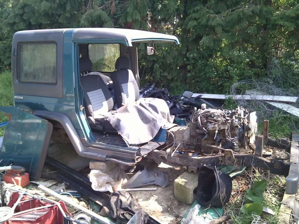

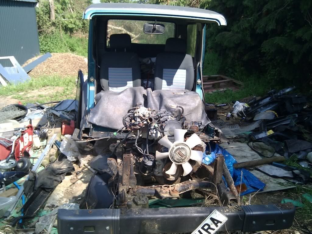

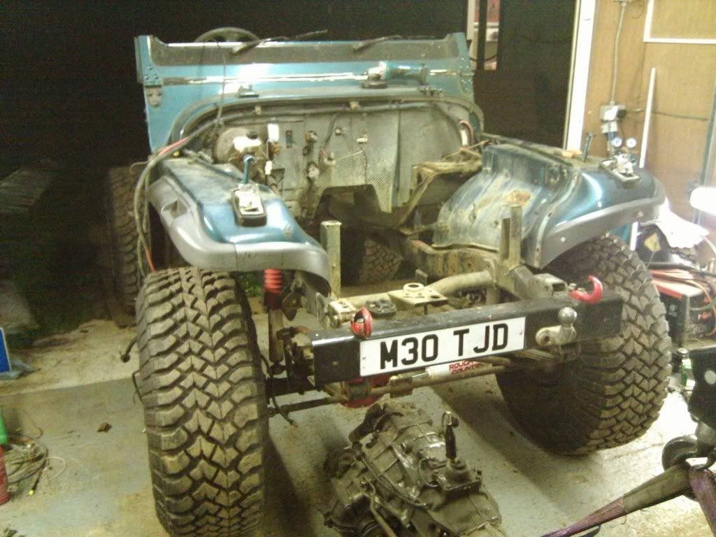

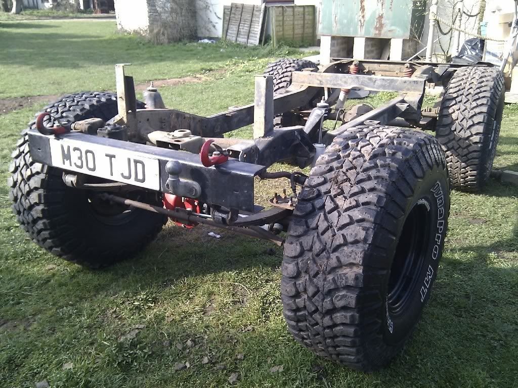

Removed the Rocstas body from its chassis

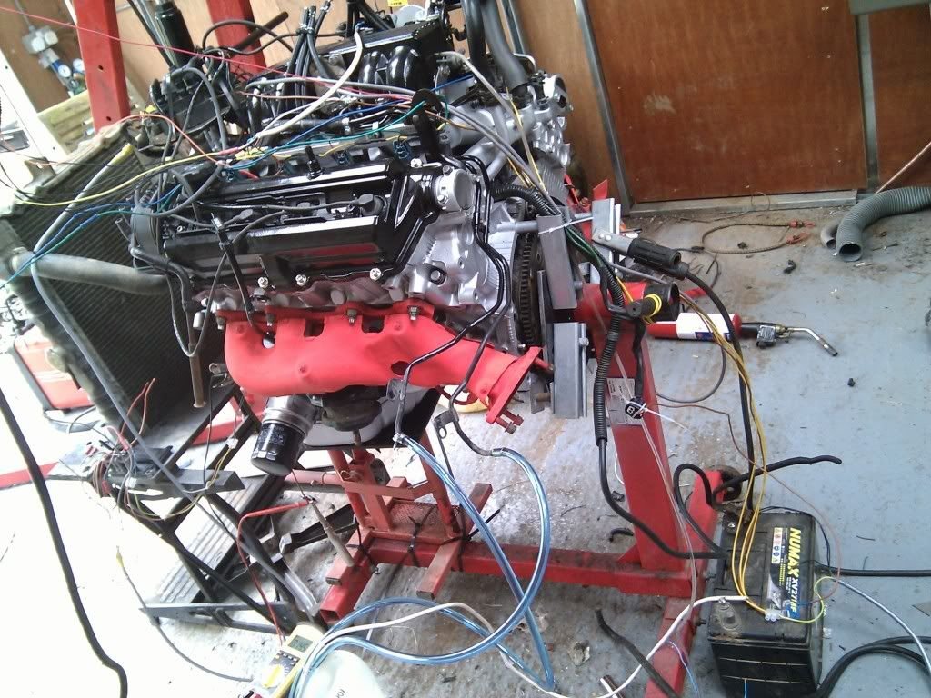

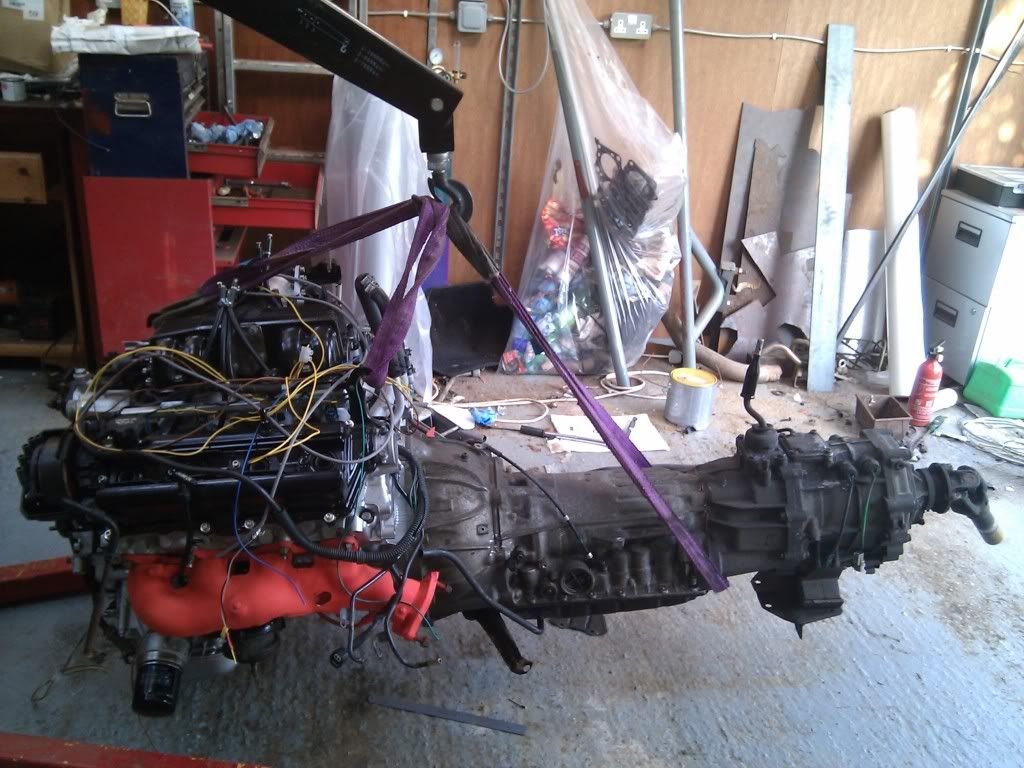

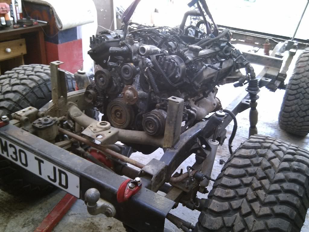

Offered up the Lexus engine to the chassis

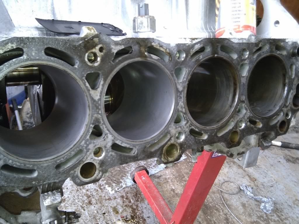

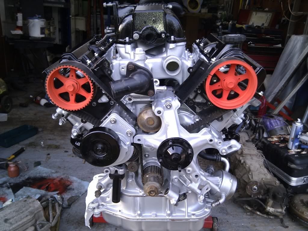

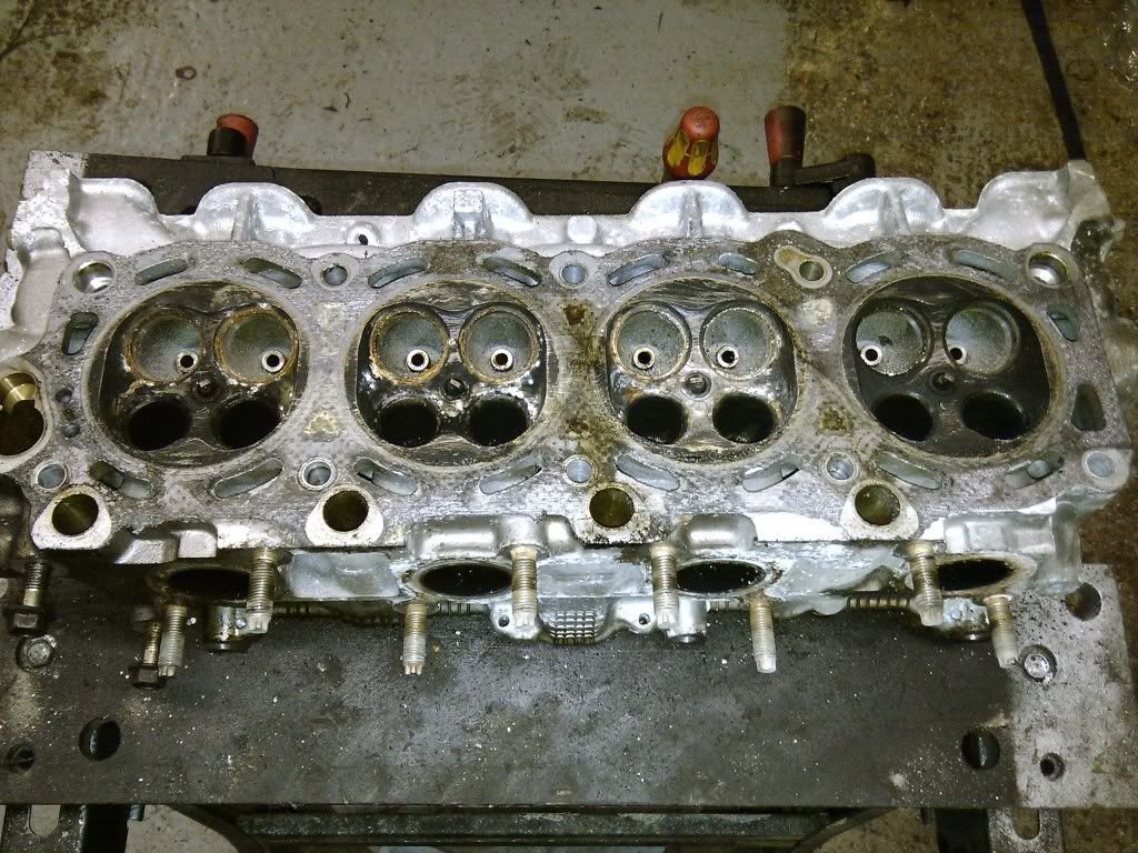

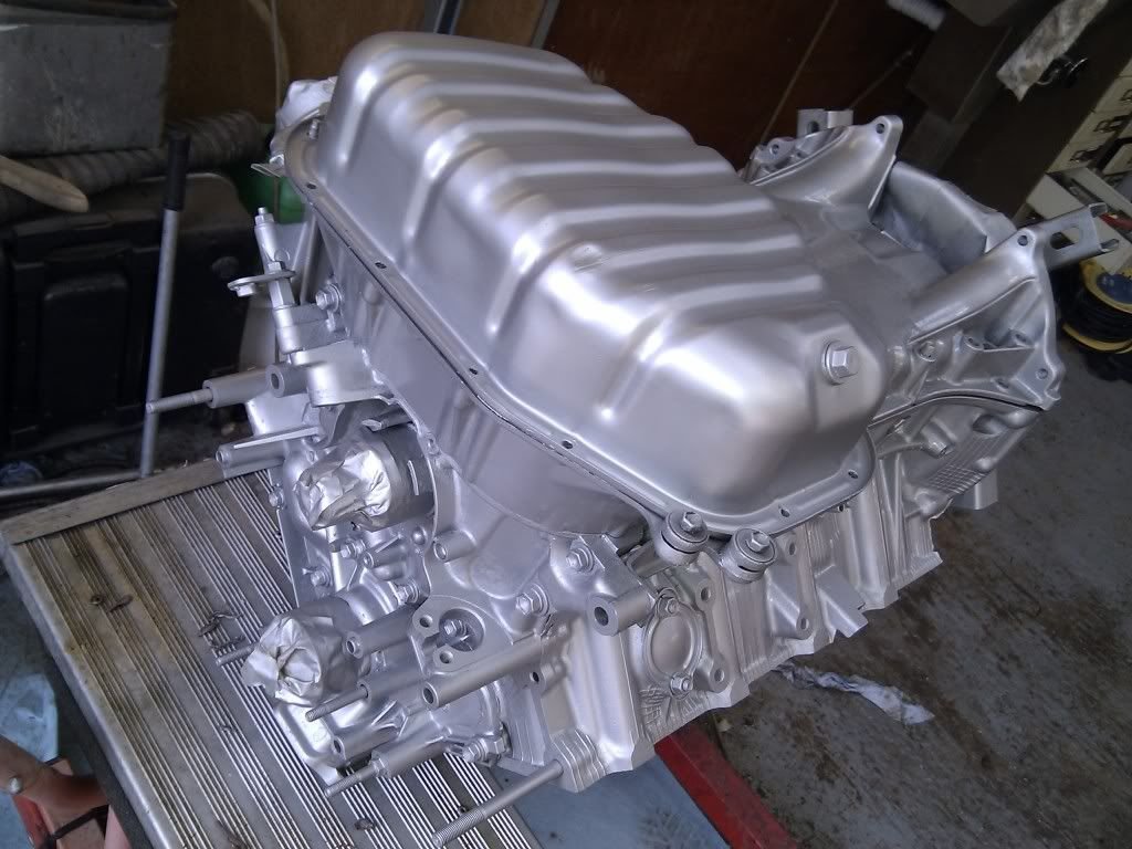

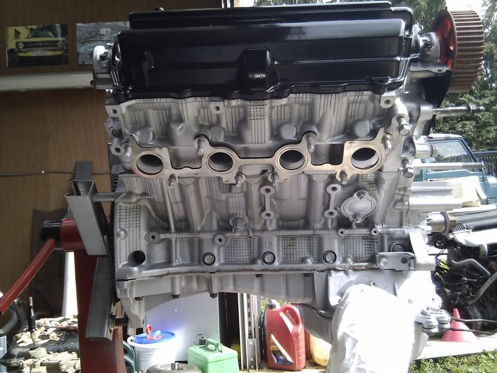

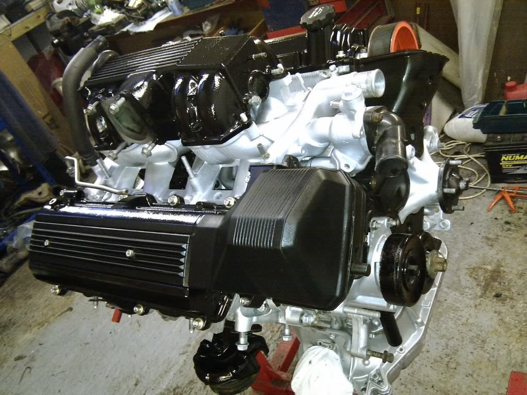

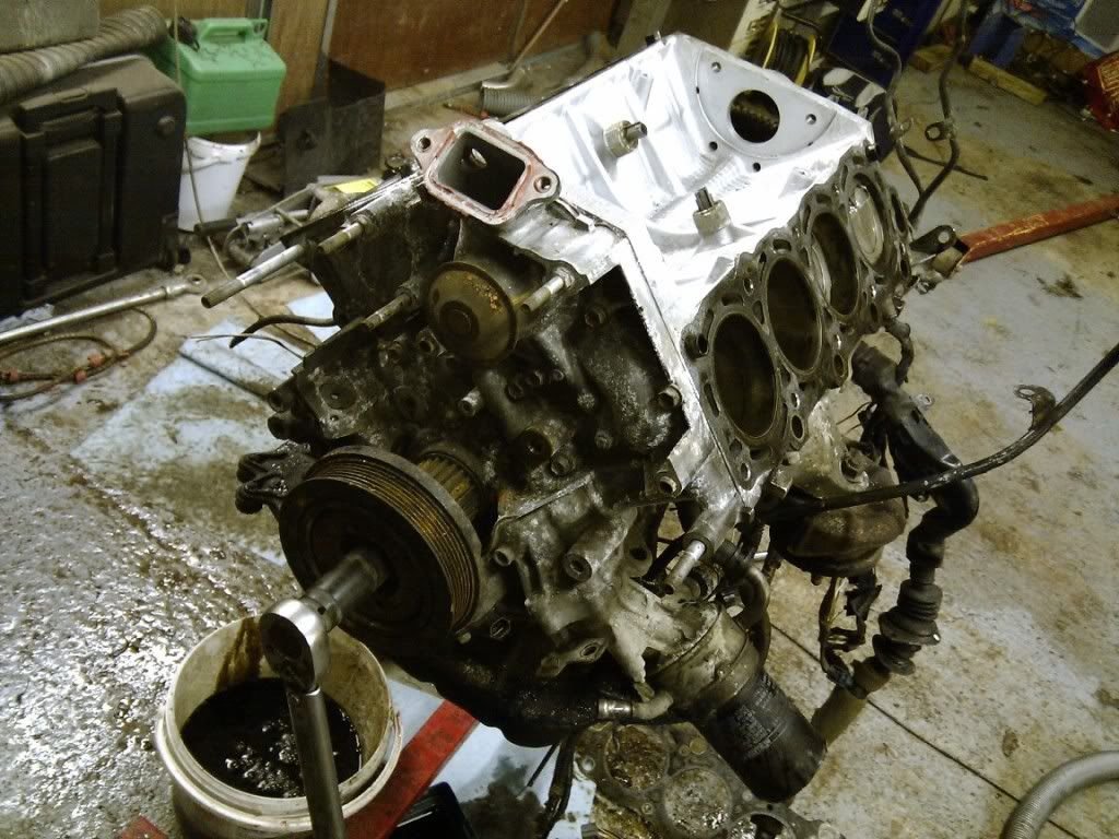

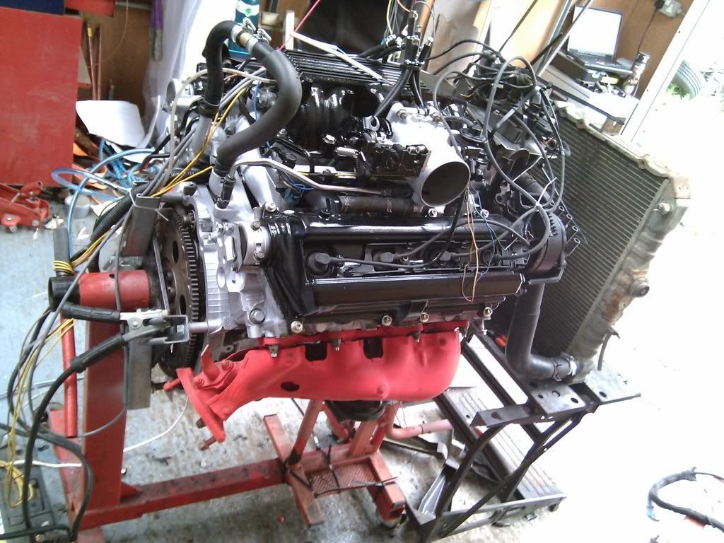

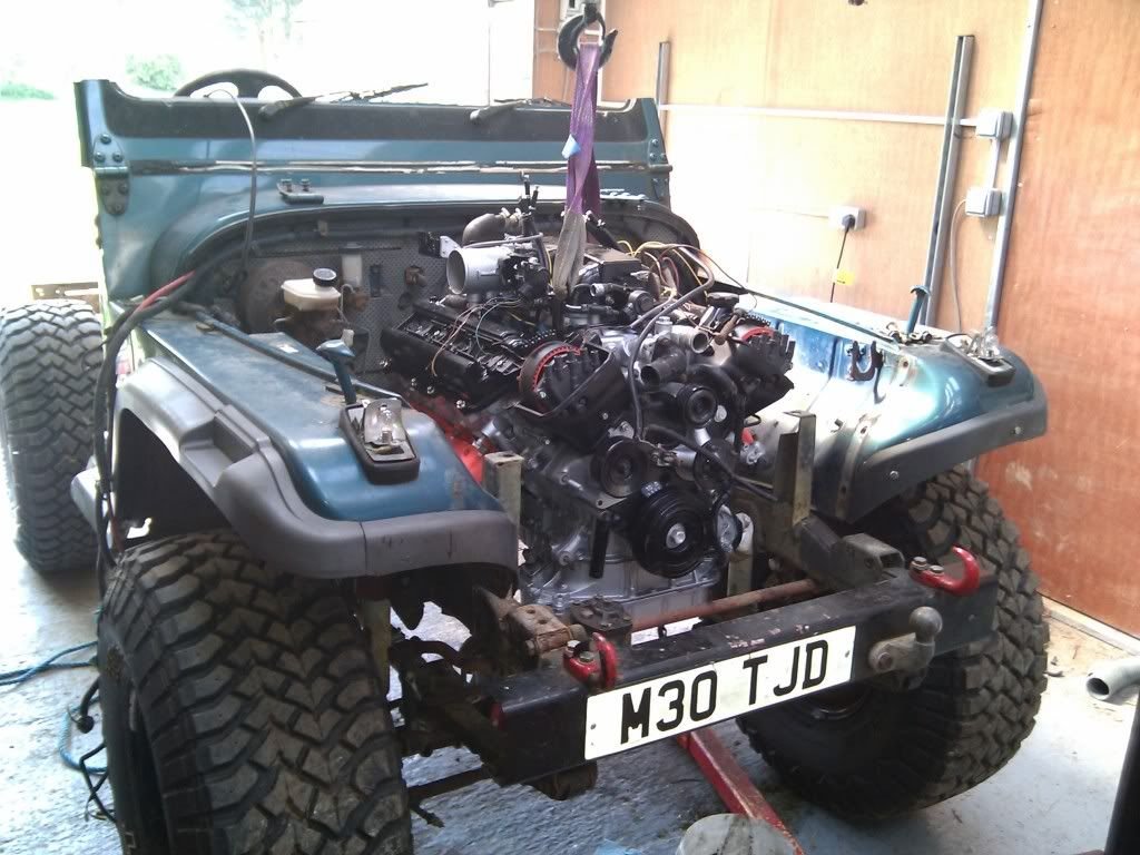

Then rebuilt the engine from the Crank up
Re-honing the cylinders as I went
Also need to swap the front LS400 sump for a Soarer Rear sump, anyone know for one?
