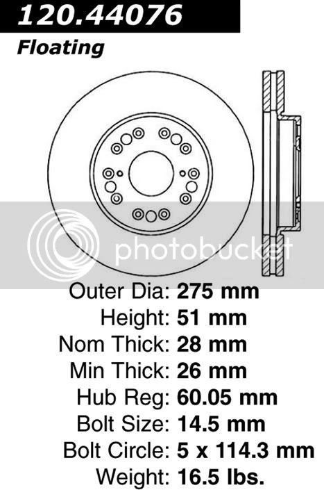

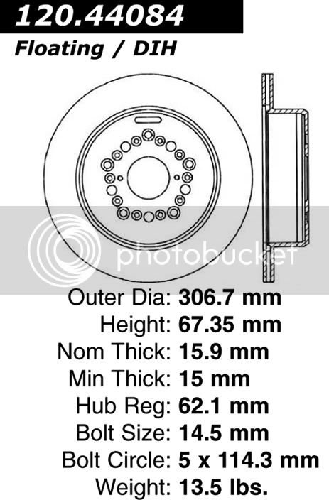

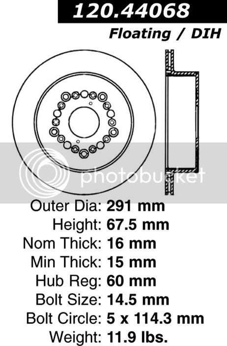

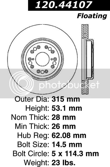

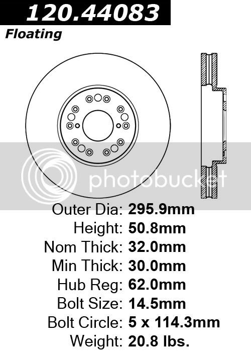

UCF10 front:
UCF10 rear:
UCF11 front:
UCF11 rear:
UCF21 front:
UCF21 rear:

I can vouch that the ucf11 and up rear caliper is larger than the ucf10. Its still a single piston but its a larger diameter piston. Overall caliper size is larger as well. As Hammered's spec sheet shows, the rear rotor diameter is larger as well. Not technically a big brake upgrade but an upgrade nonetheless.
