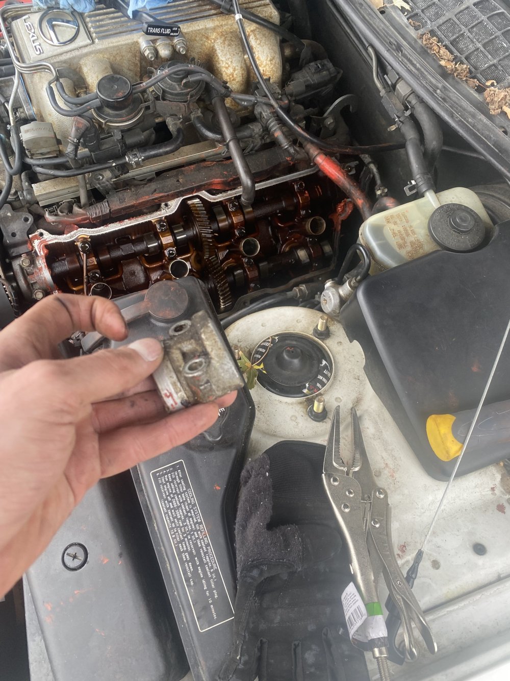

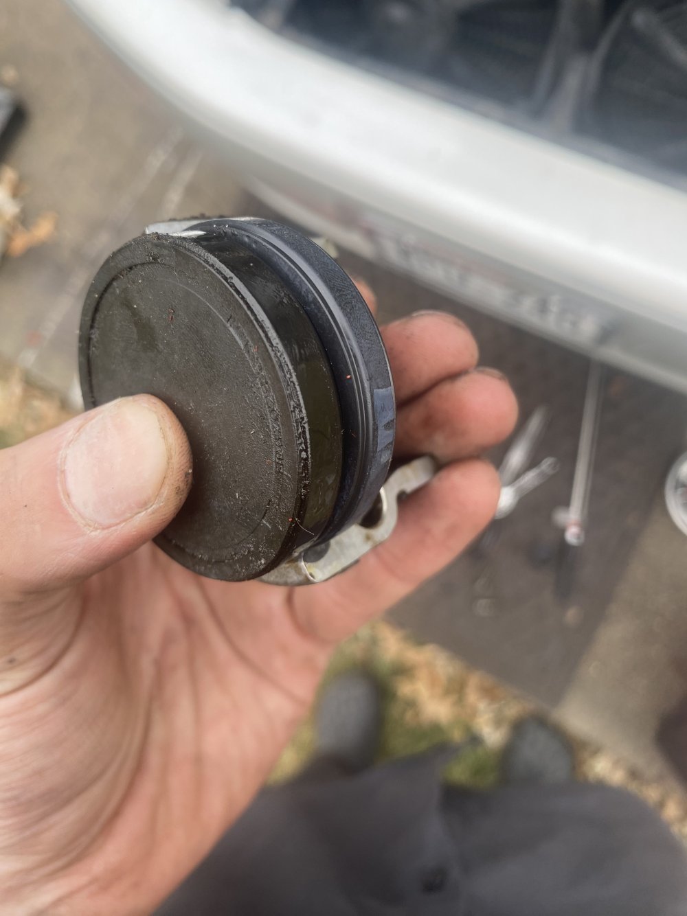

Hello everyone, if you know issue with my 1990 Lexus ls400 have start in the cold morning is very normal for 1,100 to 1,200 rpm in the cold engine and wait for start engine get warm up about 5 to 10 mins. I was try test start in hot engine and that idle got out of control up and down and up for few seconds (1,200 to 1,400) then go back to 500 to 600 rpm is fine and quiet. I’m finish with cleaned out a ISV and adjusting a TPs so far. my old ISV from eBay is 23 ohmn and 24 ohmn between should be good to go. I will check out my currently on my ISV on my car for this week. If that is both are in good condition then check a leaking vacuum air use with cigarette smoke to see smoke out of the air. I don’t have put coolant in it. My car is running great start in the cold running and all day but only have issue with starting—hot engine (surging idle in warm coolant temperatures) probably need a coolant temperature sensor for sure. I’m still wait for coolant temperature sensor from Lexus website for almost one month from now.
