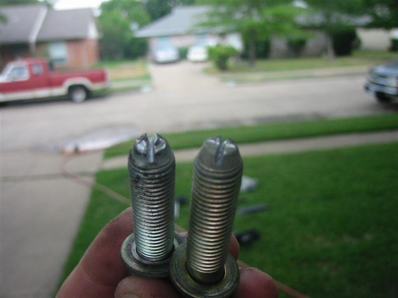

my solution?
simple:
![ls400bolts.jpg ls400bolts.jpg](https://www.lextreme.com/forums/data/attachments/12/12994-dc3ad49bd3fa9d55bffd0a2f32f9f528.jpg?hash=3DrUm9P6nV)
dremel tool + cutoff wheel + bolts = win
cut a slit in the end of the bolts big enough to slip a flathead screwdriver in for the freakin win.
this part sticks out of the starter bosses so there is no worry about weakening the bolts.. the stress is not an issue.
after cutting these, putting the starter back in took all of 30 seconds, and subsequent starter swaps (god forbid) would take less time as well.

my solution?
simple:
