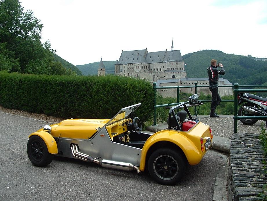

follow the above rules and you'll end up with something like this.
nice on track, and completly insane on the road.
weight ready to drive = 498 kilogramm or 1098 lbs
engine = 4age20v on omex 122rwhp 178nm @7800rpm 146nm from 2700rpm T50box
sierra cosworth braking system on Hawk pads
2.6 turn quick steering rack and yokohama A539 tyres for street michelin slicks for track
I'll happily take on anything at any form of traffic light on the road, let alone on a bendy old dutch dyke-road, my brother included on the yamaha FZR1000 exup...... whoaoap beybey. never lost such a thing to this day.
