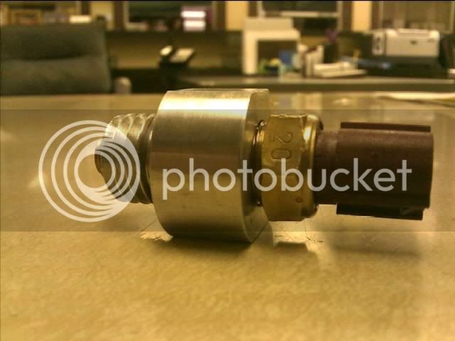

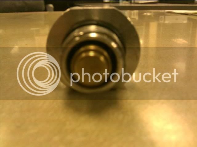

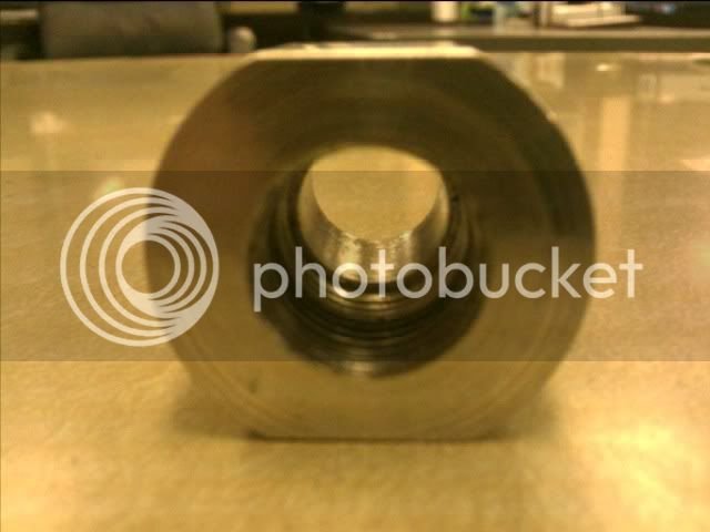

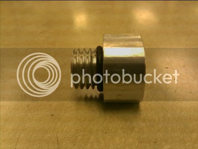

Ok it starts like this. The day I was starting my car from the 1.3uz build. Found out that the temp sensor in the stock radiator does not thread to the Megan supra radiator stock location spot, you can thread it but it aint right. So in desperation, (i never do this) but I DID, I used the JB weld 2 part puddy, to seal it up. NO LEAK. A few days later the temp gauge starts to go up, so I pulled over b4 it even gets close to the red. Shut it off, get out an check, no leaks, no smell, nothing. Start it up, it's sitten @ normal. I thought "thermostat". I make it to autozone, buy a thermostat for a 02 SC430
