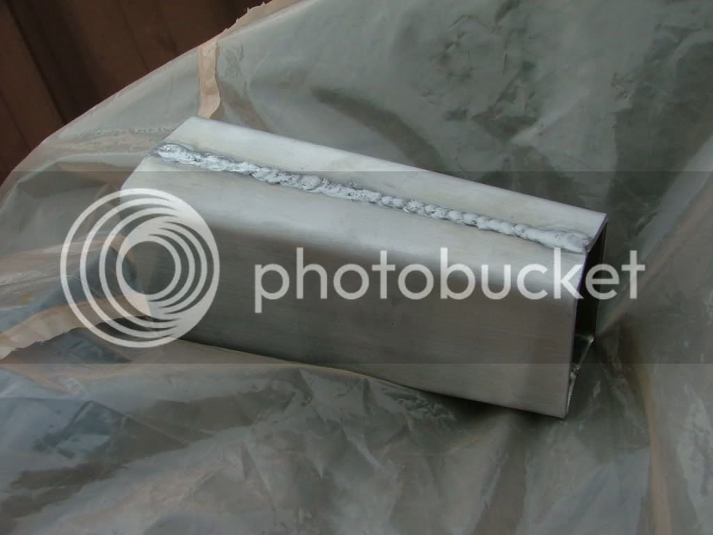

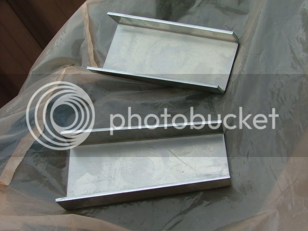

The inlet we made was put together using two pieces welded together..
If we did it again we'd have the welds up the side and polish weld a little..
Not good weld this one was rejected..
Welded and machined so all even then tapped back
to bell-mouth ..

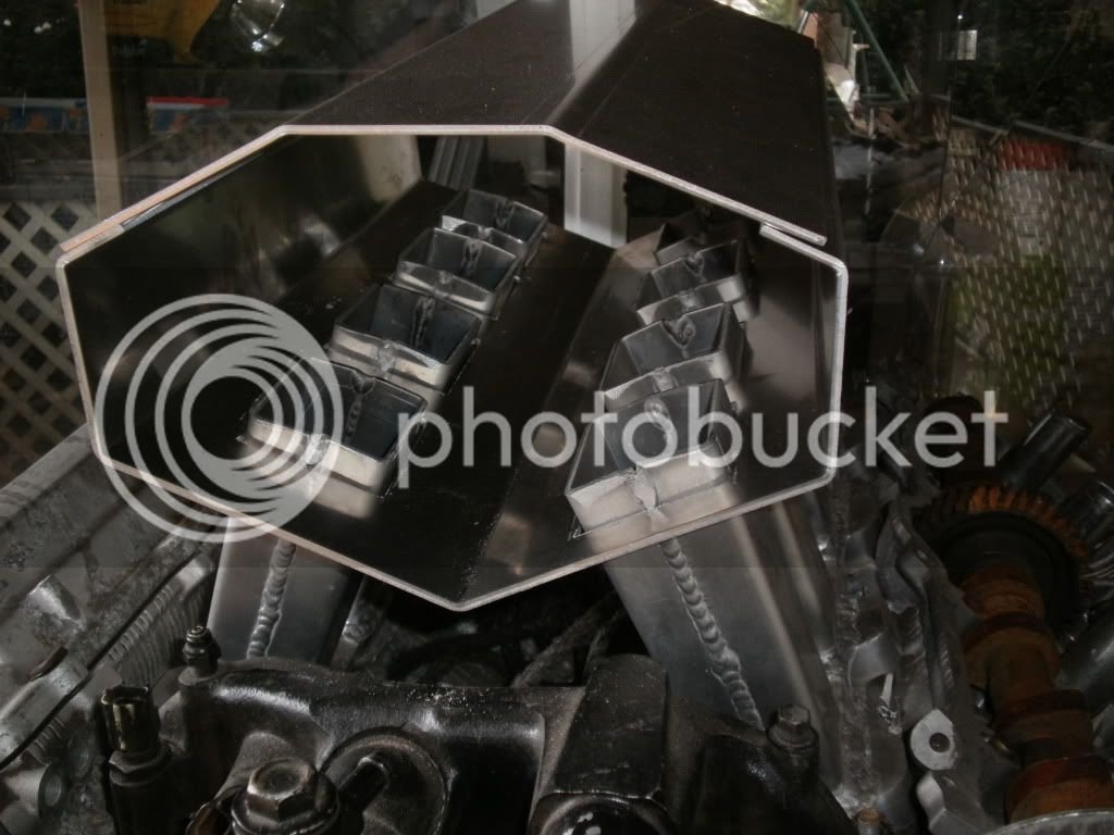

Not saying this is best or anything it's what we did and it's not running yet.. This was made for all out forced induction power...
Another way.. Weld a thick bead around the top and polish a nice even radius over weld..
