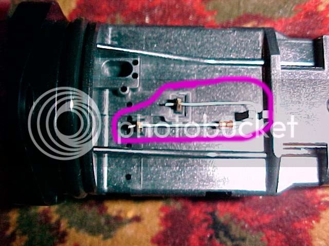

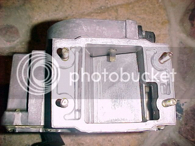

In an AFM it's a little thermistor hanging down on the front of the housing:
On a MAF, they're generally on the side:
