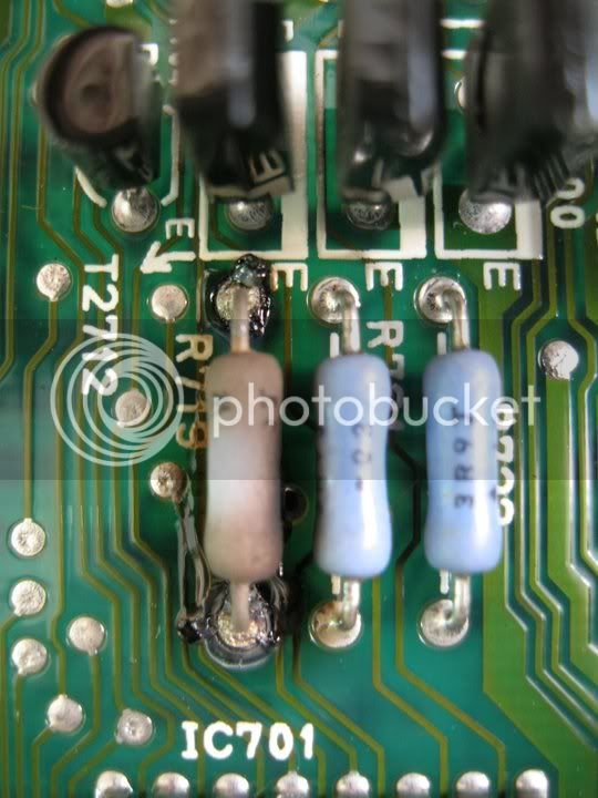

as what sideshow told me sooner this day.i check the tps connector for approx 5 v and there were none. then i discovered the last 26p plug is upside down type and so i plugged in the wires wrongly and then fitted them correctly pin 4 M-rel ,pin 5 w-check engine light and pin 26 battery .. so i check the voltage at tps again and few of them has 4. something volts and one had 5v..i was happy then i turn the ignition switch on immediately the fuel pump turn and i off the switch and it kept turning till i unplug the + of the pump.then my father was right next to the ecu and smelled something ..i then put my nose close and also smell something melting then i saw some fine smoke came out of the ecu,i then immediately disconnect the + from the batt and open the ecu cover and discover something like a longish blueish thing turn black. i tried to prob both its terminals and circuits to them and all has continuity they are not like resistors or diodes and has complete continuity both ways.. and i didn't notice any other burns elsewhere on the 2 ecu circuit boards.

Why not just replace the burned out component?
It has a part number on the board.

Hi there zuffen, i saw some of your posts last time and realized that you seems to know something from just about anything. that's pretty amazing. and maybe you're in the same level as sideshow or somebody very good here. Okay I'll check out the part number of that component and in the mean time also double check my wiring. About the plug.. i didn't have the 4th plug 26pin ... so i just trim and cut a connector and use its internals to hook up the M-REL and the w-engine check light and the battery and discovered the the M-REL supplies the +12 Volts constantly even after the ignition switch is off. and could you tell me what is the name of that blue component? Thanks a lot zuffen

if u goto wreckers and get some damaged toyota ecus u might be lucky and find the correct resistor
if yours is badly burnt maybe get someone with same ecu to tell u the number on it
this number is not resistance value i think
i recon its part number so get resistor with same number and hope u havnt damaged somehting else

So today i check the wiring again and then probed the burn component with ECU pins till i came to the w-check engine light pin and got a complete continuity between it and the burnt component.
