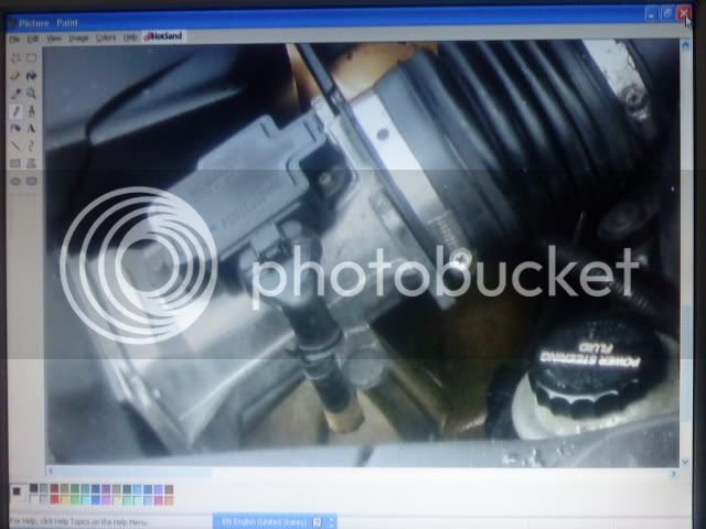

recently i had it in work to trouble shoot this issue. this is what i did:
i decided to ohm test my MAF to check for proper readings, well are temp in the shop is around 65 degrees, and i got 2.23ish k ohms.. i couldn't find a way to test the MAF portion of the sensor.
this is were i think i made the mistake. i decided to clean the MAF with carb/choke cleaner and the dried it with shop air. i understand how the MAF works so figured i wouldn't be hurting anything.
well i had the maf unplugged and the engine running and i was checking to make sure i had powers and grounds at my plug, using my DVOM i tested all 5
for voltage first, center 3 had 4.95v and 0 on our 2 grounds, then switched to check my grounds and they tested good but when doing this i touched one of my center 3 wires and it caused the engine to idle down and then back up...
so i reassemble the maf and plug it in. start the engine, runs terrible.. puffing out black smoke like a diesel.. i shut it down and start to ponder WTF did i just do?
if this helps, i can leave everything plugged in, reset ecu ( disconnect battery) and start it and it runs perfect for about 30 seconds and then back to dumping fuel... i don't have any tester parts to swap without paying for them, so i only ant to buy one part.
thanks for your time, and o yeah hey this is my first post! hi everyone
