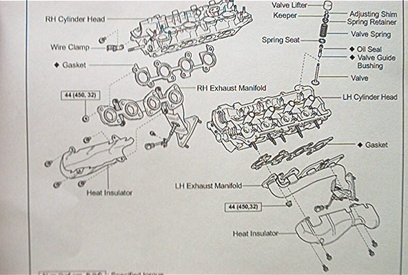

Peewee, here is the lousy 430 manifolds. Both sides are the same design...
Ahhh, I can see. REALLY bad.
That explains the 0hp improvement for the 3UZ over the VVTi 1UZ
