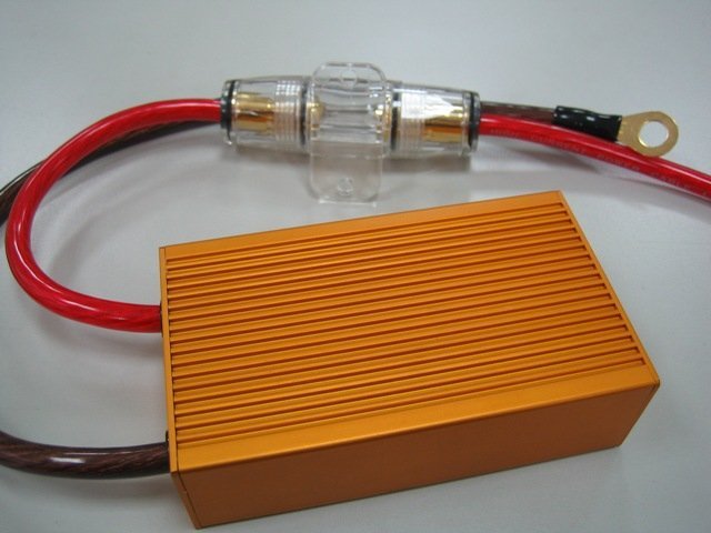

So my car seeems to have a minor voltage stabization problem, minor things like my lights flicker a bit in pace with my windshild wipers my battery is brand new and my alt tests fine, i think the problem is i may have removed somthing sorta important when i wa simplifying my harness.
as an easy fix i was thinking about getting one of these voltage stabilizers. does anyone have any input on these? good, bad, a suggested brand
it seems there are tons of cheap 5-10$ ones on ebay.

Yeah i'll pass.... just spent $300 for a yellowtop Optima and solid nickel terminals and my car starts IMMIDIATLY... so quick I dont see anything improving it now. I re-wired my trunk and before I had slightly dimming headlights and weak starts until the battery + alternator upgrades. These are whats needed when you have electrical issues. My stereo puts out 1500 RMS, batt relocation, supercharger, AC and the BIGGEST improvements weren't some hyped "voltage stabilizer" which is a roundabout way of saying capacitor they were alternator and high CCA batt. I am still rocking the stock alternator line and is very stable.

Yep ED you said it right, they are "all" just fance names and looks for the common "Capacitor"... I found that out later on after I purchased this so called "Hyper Voltage System" and others too...
Kind of a big scam if you ask me... I got a capacitor in my trunk regulating my stereo amp voltage, and Nitrous system and that is no different and may even work better... Costs less too... Stereo shops use them all the time....

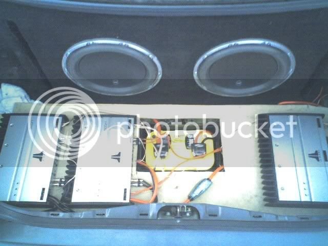

Well if it a simular and standard capacitor like the one you see in my picture I would say absolutely yes... I not really sure which one you are talking about...

This is a pic of my current trunk setup. Optima battery is inside a battery box (donated by lextreme) and bolted to bottom of tire well and encased in 8'' of expansion foam. I have a zero gauge line running to the relocation "distribution" block and 2 four gauge grounds and nickel terminals, oh nd 140amp alternator too. Then 3 four gauge line run thru firewall to 2nd nickel distribution block that attaches alt line and fuse box.
